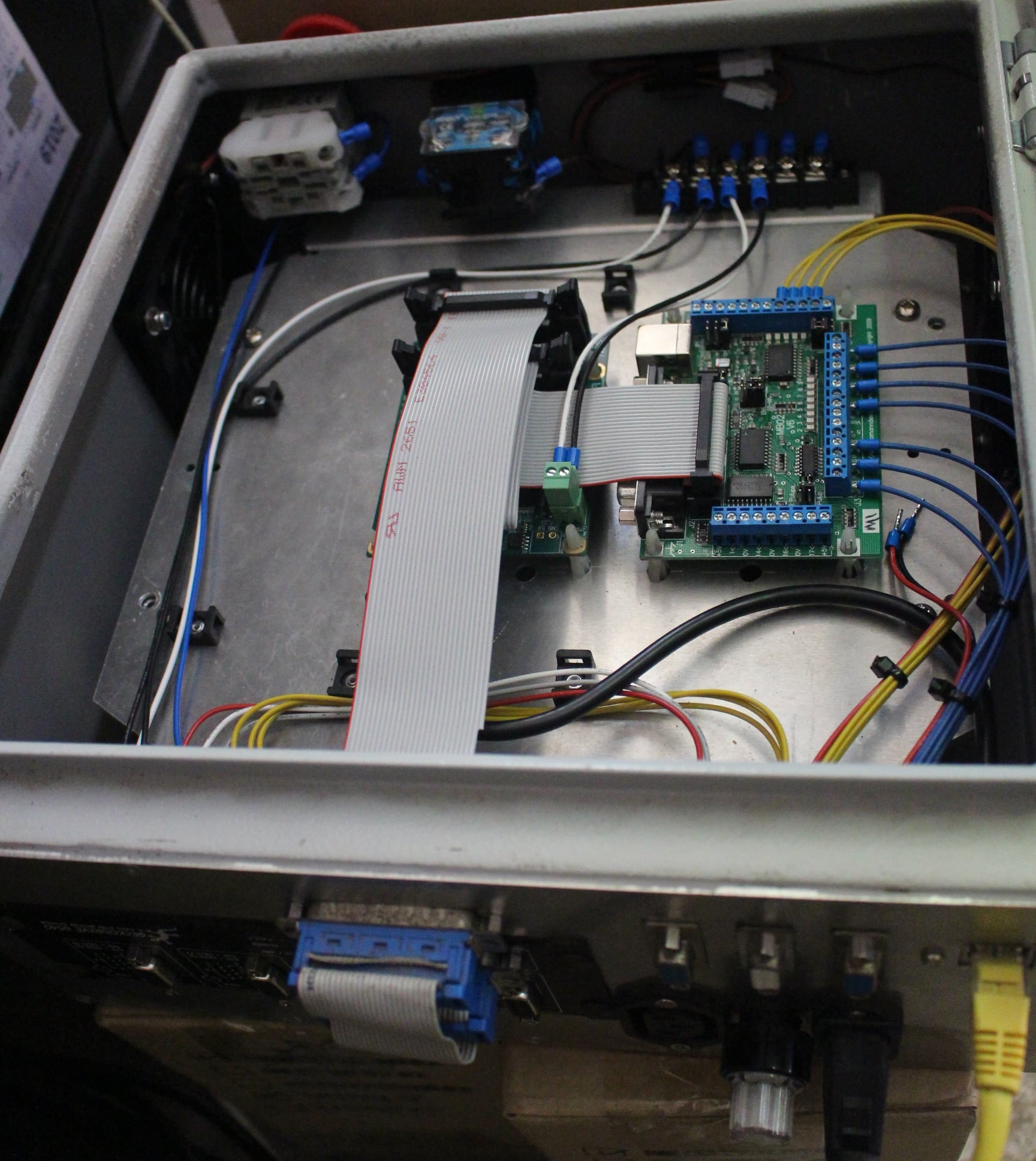

Here you can see the configuration i saw fit to construct. It is a 7i92h and so it just relies on 26pin IDC connectors and ribbon cables, I thought it would be brilliant because of the small footprint.

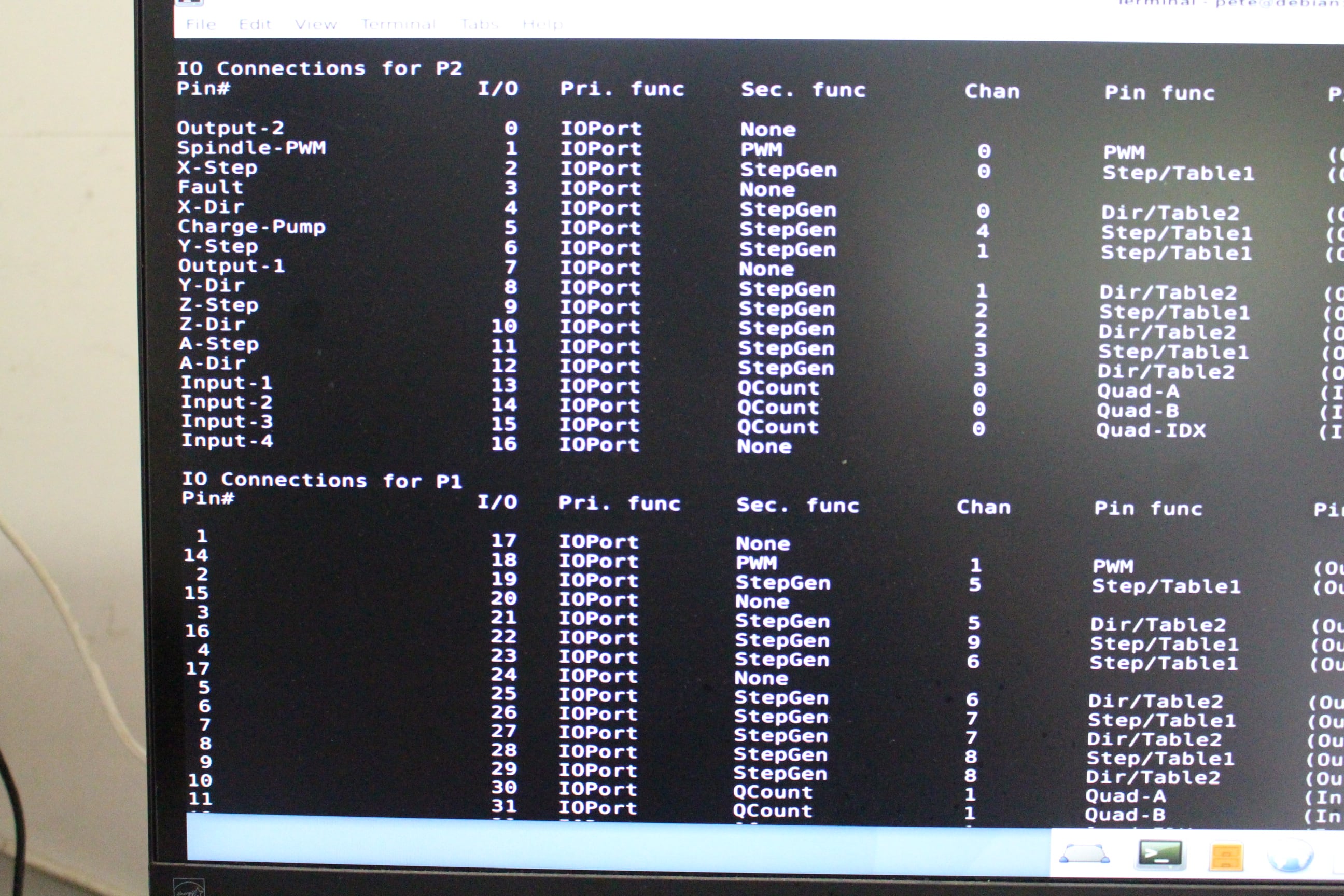

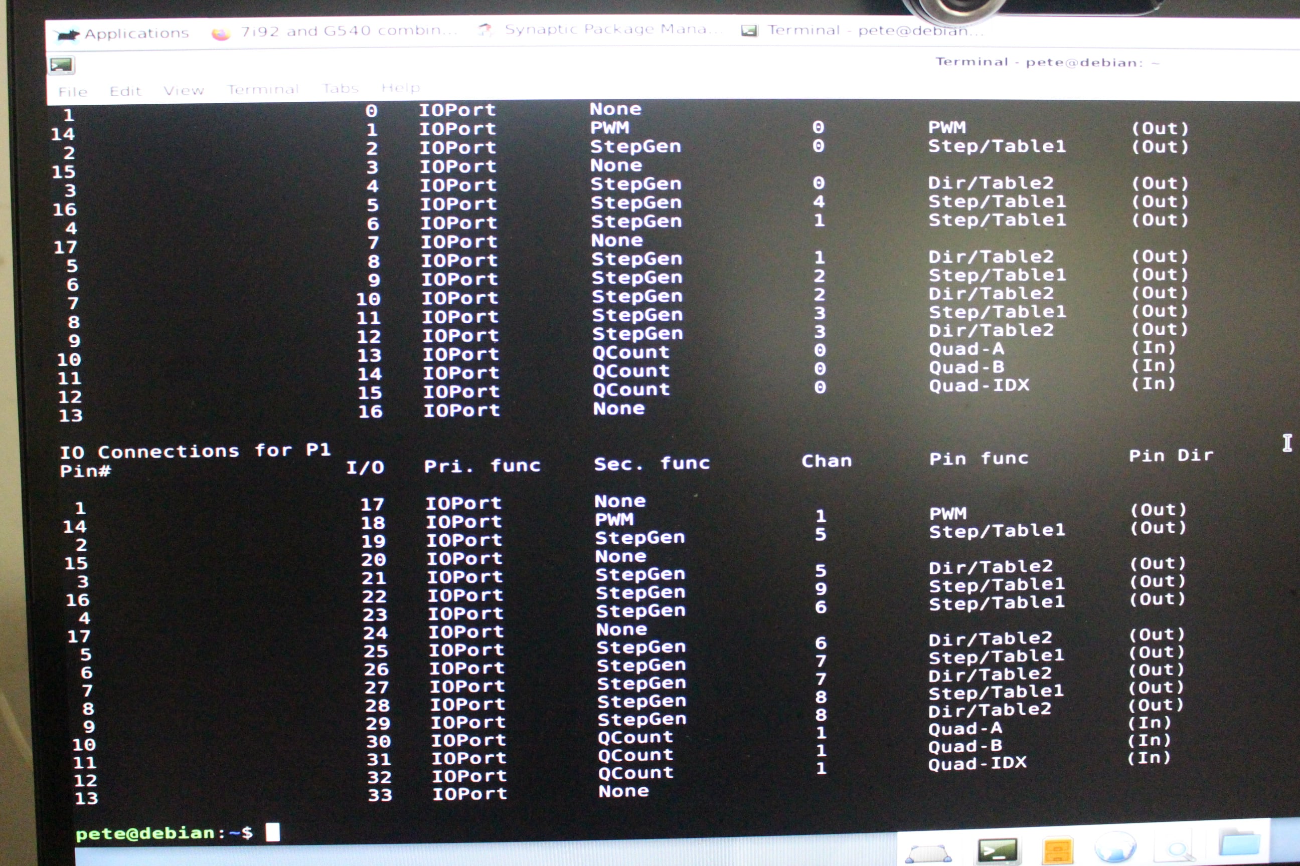

Thank you so much for letting that to bare... I probably have been told before but i just doubted it...
I have forgotten where to download the mesaflash software; but it seems that i have a copy flashed already...
--readhmid gets a reponse;
which is fine, but i don't recognize the pinouts they aren't the last time i used pncconf, they look like the first time i used it...
So the question now becomes how do i set the pins..?

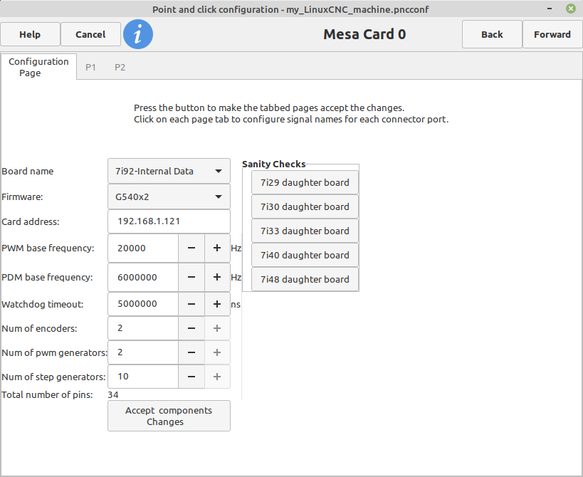

currently i am trying to get the pncconf to make a change to the readhmid...
the number of step gens i have selected in pncconf is 5; while the readhmid still persistantly shows 10...
is there perhaps some sort of hard set that i have performed in an earlier session,
do you know of any way in which i could have opted for a hardset...?
I have a vauge memory of such a thing...

27 Apr 2023 04:31 #270049
Replied by tommylight on topic 7i92 and G540 combination?
Set stepgens to 4.
That will not change the results of readhmid as those are in the firmware.
Any stepgen or pwm or encoder pins not used in PncConf revert to being IO and cam be used as input or output.

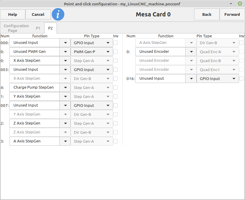

Did you setup stepgen4 as a chargepump stepgen?
(as shown in my pncconf screen shot)
A G540 need 4 stepgens for motion, the fifth stepgen (stepgen 4) is used
for driving the chargepump
This means you only need 5 stepgens unless you need more for motion
or charegpump on the second connector.
Note that if the second connector has a different pinout than the G540
(and not just GPIO) you may need different firmware

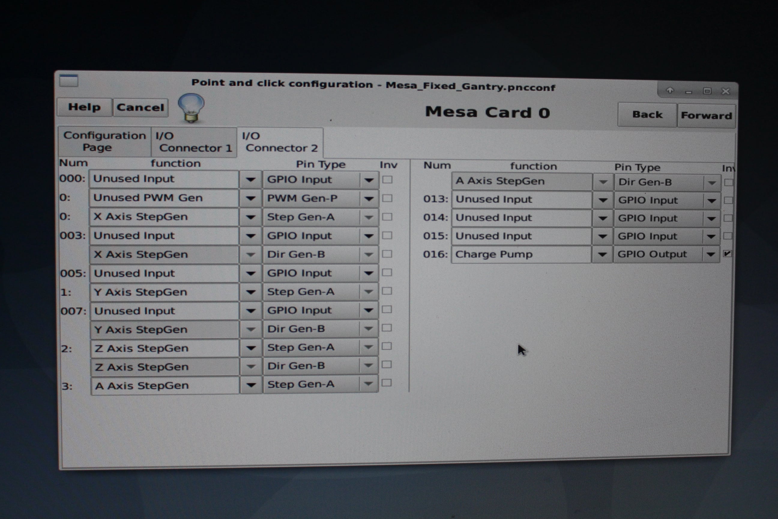

Yes i now understand that the sixth pin from the top is the pin 16 and that it should be set to charge pump.
It wasn't until i started this thread that i learnt it though(the numbering system was a hurdle i hadn't figured out).
So, what has been happening was i could see, after setting the pin correctly,
was that the fault light would latch on for half a second and latch back.
I thought this was odd so i disabled the charge pump on the g540,
and found i needed to invert the signal to the fault input on pin 15.
This got me some motor movement, and i set the charge pump back to on.
But with the charge-pump re-enabled i got different behaviour.
The f1 key is now fully locked and won't operate.
I get a lot of errors about read and write queue's
and one about a 'something' has "bit" and that i should set a 'setting' to false.
I noticed there is a charge pump setting for both step gen and output,
I have tried both inverted and normal...
