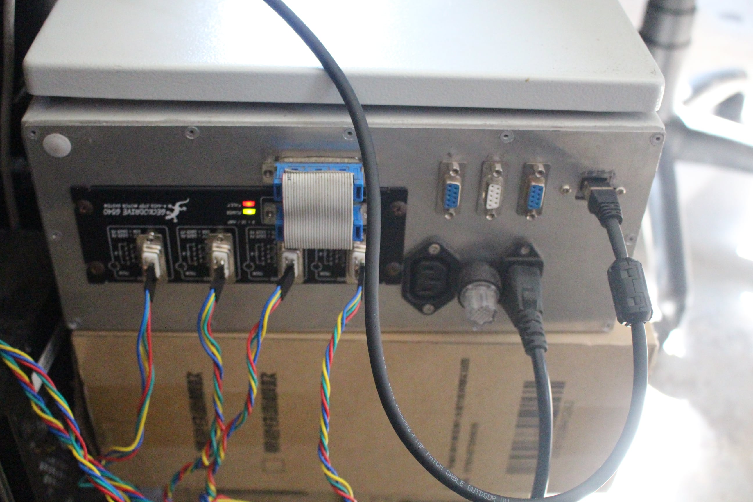

17 Jul 2023 05:52 #275622
by P.J.B.C
Replied by P.J.B.C on topic 7i92 and G540 combination?
On closer inspection this is not an issue the fault light is visibly increased when latching the E-stop...
- Posts: 21990
- Thank you received: 7487
17 Jul 2023 10:59 #275639
Replied by tommylight on topic 7i92 and G540 combination?
It should be off, completely.
Check grounding, 0V wires from power supply to G540 and to the rest of electronics.
