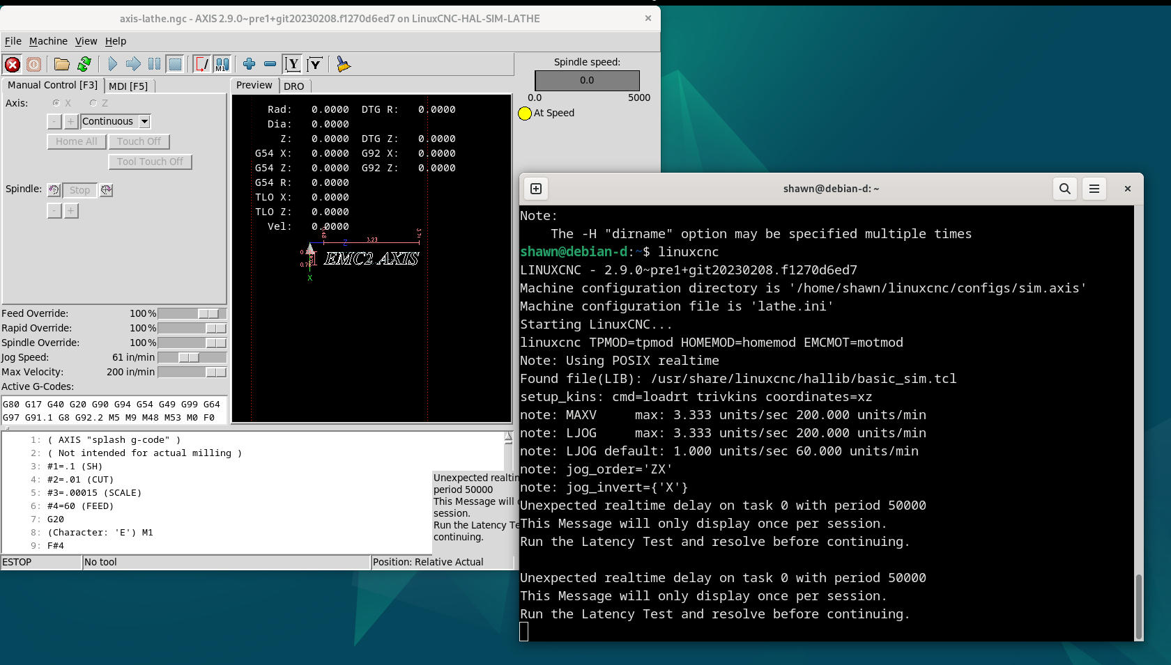

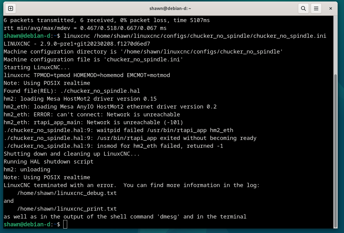

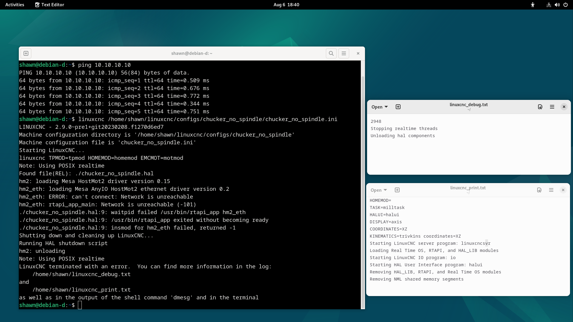

My latest mini PC is a NUC with Debian 12.1, LinuxCNC 2.9.0 and foregoing control box. The LinuxCNC simulation launched okay. The ip -a pinged okay. The PnCConf Wizard with spindle, attempted launching profile and an error. Alternatively, the PnCConf Wizard without spindle, attempted launching profile and error again. Consequentially, I copied the BRIX /linuxcnc/configs/sherline_lathe_chucker/sherline_lathe_chucker.ini profile (that launched okay earlier) and pasted it to the NUC /linuxcnc/configs/chucker_no_spindle/chucker_no_spindle.ini profile. Still not launching LinuxCNC. Please see 'Screenshot from 2023-08-06 11-13-48_config.png' to show error.

Replied by PCW on topic New config not launching LinuxCNC
Looks like a network setup issue

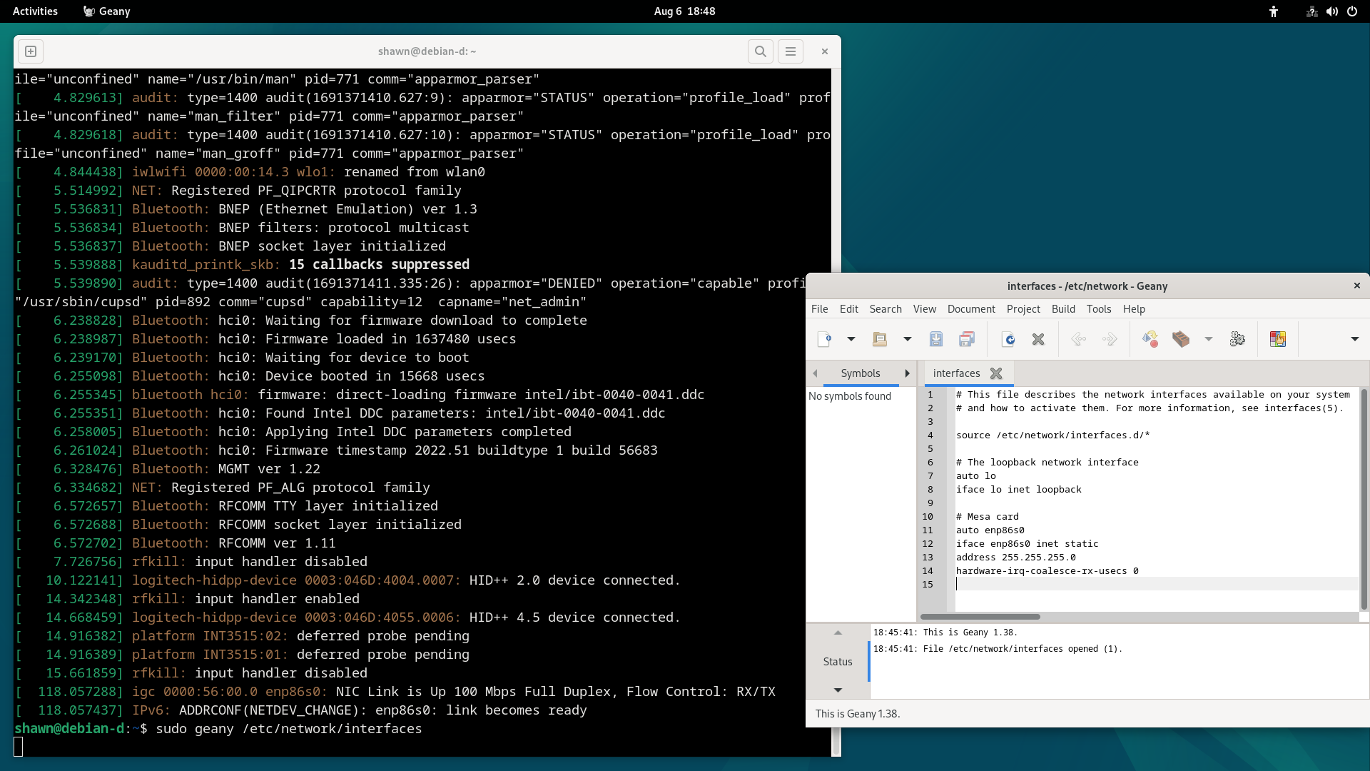

I already disabled Secure Boot if the were an issue before attempting to launch LinuxCNC lately. Could Wi-Fi be an issue, however, I haven't configured it to a router and no internet connection when attempting to launch LinuxCNC? Could there be any other obstacles and what?

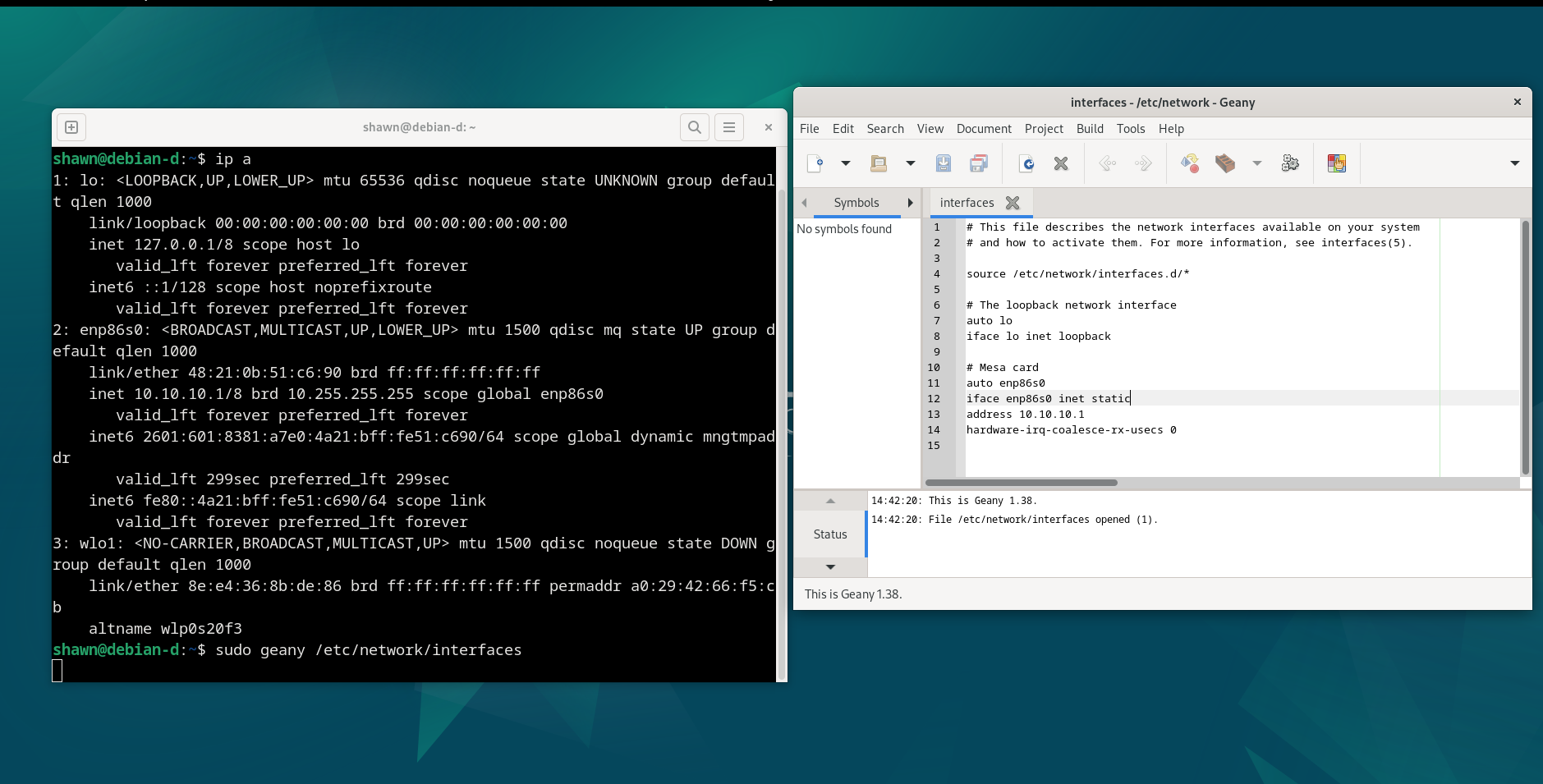

That ip -a foregoing meant ping 10.10.10.10 .

06 Aug 2023 17:37 #277173
Try setting the netmask to /24
- smplc
- Posts: 224
06 Aug 2023 17:53 #277174
by smplc
Replied by smplc on topic New config not launching LinuxCNC
Is that such as 255.255.255.0 (networkencyclopedia.com/subnet-mask/)?
- Posts: 18118
- Thank you received: 5336
06 Aug 2023 17:56 #277175
Yes

I tried netmask /24 but LinuxCNC still not launching.
The axes motors were already tuned with the BRIX, Debian 10, LinuxCNC 2.8.0., per edited and updated /sherline_lathe_chucker.ini file. The /chucker_no_spindle.ini file is a copy of /sherline_lathe_chucker.ini. and the only difference with the /chucker_no_spindle.ini file appears is improved latency (SERVO_PERIOD = 15585) and CARD=hm2_7i96s.0 .
Any other ideas why LinuxCNC not launching?

06 Aug 2023 22:13 #277189
You set the IP address to 255.255.255.0 rather than the netmask
