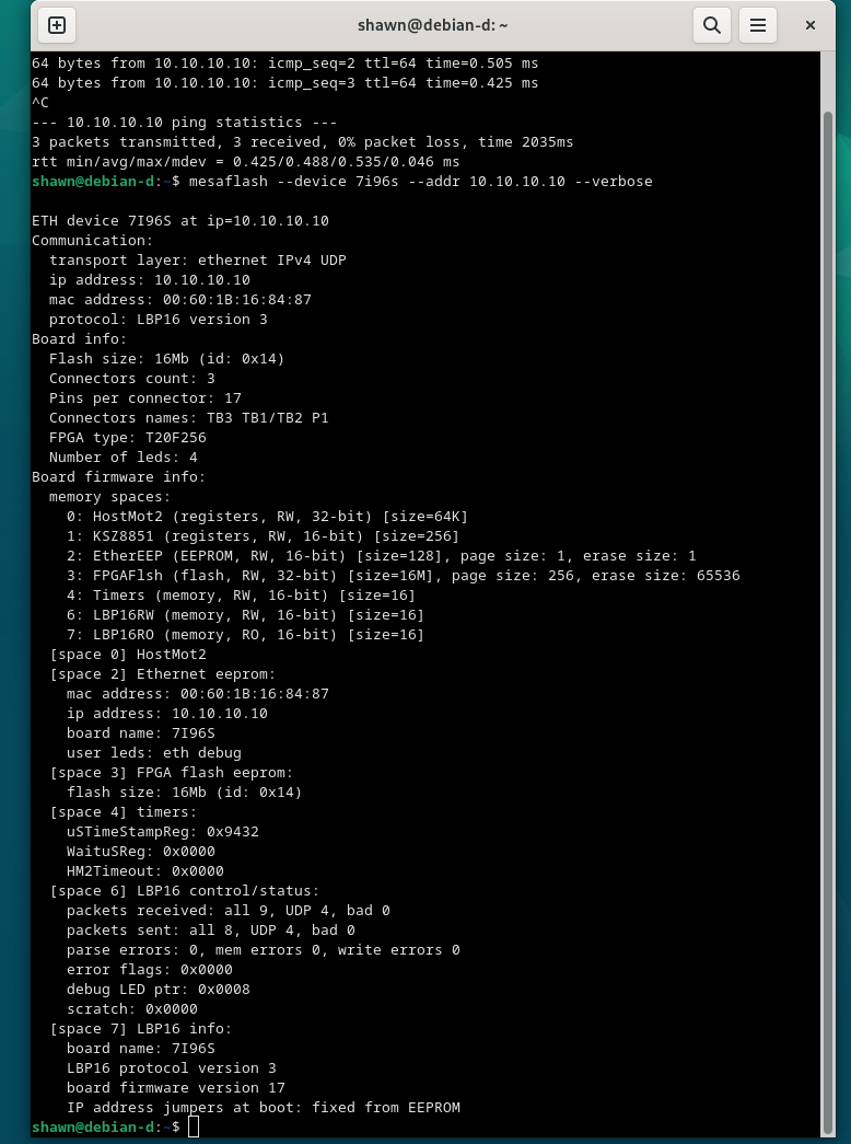

Yes adding /24 to the ip address is the same as a 255.255.255.0 netmask
Also the ping times are really long...
Does mesaflash work?

However, the ping did show packets transmitting. Yes, it'd appear that mesaflash is working.
I still don't know why LinuxCNC isn't launching.

• Yes, the 7i96s card RJ45 Cat5e is connected to the RJ45 NUC mini PC.
• The NUC12WSHi3 only has one ethernet port and presently not using B-key SATA.
• The hal file loadrt line has a 192.168.1.121 address. This is the same address that matches the 7i96s_d card in the PnCConf Wizard.
• Yes, the 7i96s LED's CR11-CR14 blinks green when pinging 10.10.10.10 . Closing ping CR11 remains lit. The CR8 steady lit yellow. The RJ45 lit green and orange. The NUC RJ45 only green lit.

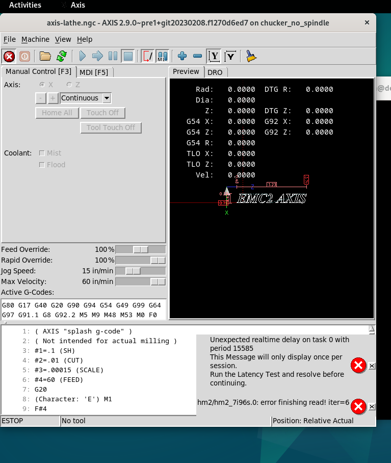

"The hal file loadrt line has a 192.168.1.121 address"
That needs to be 10.10.10.10

The hal file I replaced the 192.168.1.121 with 10.10.10.10 . LinuxCNC launched the chucker_no_spindle profile. The GUI has latency issue now. 7i96s CR6 is lit red. I suppose try a latency-test and update it the chucker_no_spindle.ini file at SERVO_PERIOD.
- Posts: 18118
- Thank you received: 5336
07 Aug 2023 11:18 #277250
Replied by PCW on topic New config not launching LinuxCNC
The servo period should be 1 ms (1000000 ns)
or perhaps even longer as the ping times were quite slow

The latency retested at 22675 ns. I tried that value at the SERVO_PERIOD and the error again. The SERVO_PERIOD is now at 1000000 and LinuxCNC Axis lathe launches without error. X and Z axes are jogging. The sherline_lathe_chucker.ini was at SERVO_PERIOD = 1000000 too. Thanks.
