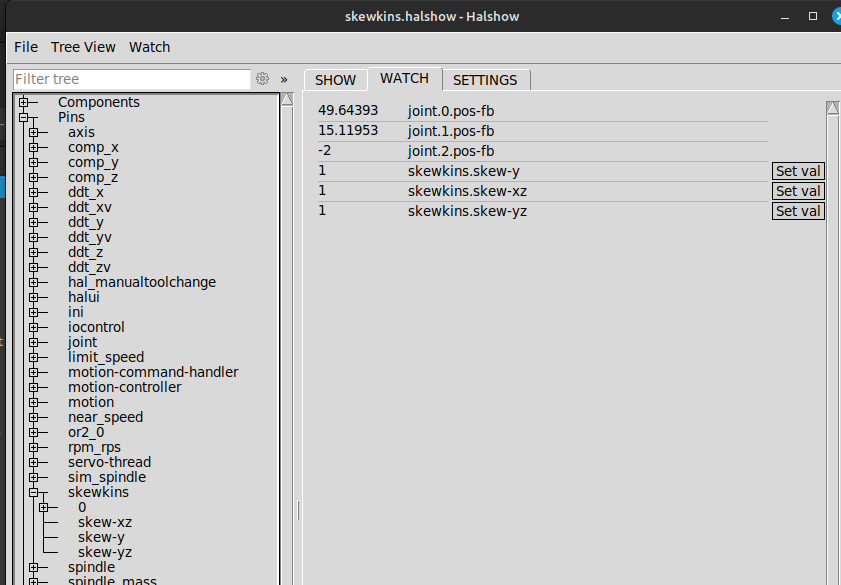

14 Sep 2023 03:36 - 29 Dec 2024 04:47 #280714
Replied by Aciera on topic Skew correction/perpendicularity correction (millkins or millkins_xyz)
[edit]
There actually already exists a more comprehensive kinematic for this:
www.linuxcnc.org/docs/devel/html/man/man9/matrixkins.9.html
[original post]
I adapted the linked 'millkins_xyz' using the userkins template and tested as an axis simulation config. Seems to work ok:
use halcompile to install the enclosed skewkins.comp
see enclosed 'axis_mm_skewkins.ini' for setup of skew values
For simulation copy 'axis_mm_skewkins.ini' and 'skewkins.halshow' into 'configs/sim/axis' folder and start the ''axis_mm_skewkins" config. Joint position can be observed and skew values can be changed in the halshow window (which should open automatically at start up).
[original post]
