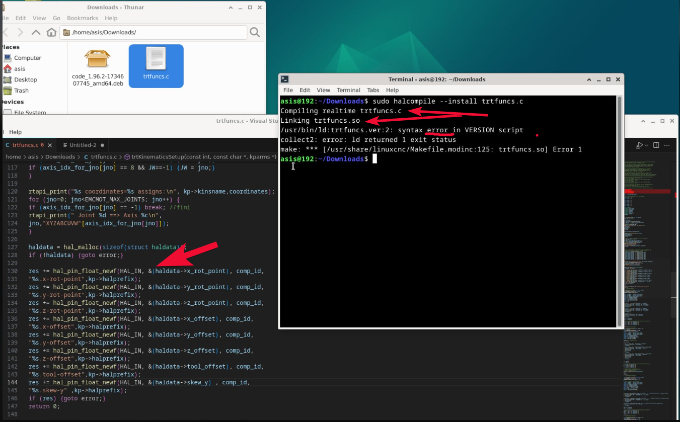

Hi , Aciera
About 4 days .
I can only do this much (attacth file),
and the things I can't do are:
J[0], J[1], J[2]. I don't know how to transform them into the same format as trtkins (it's use joints).
int xyzacKinematicsInverse(const EmcPose * pos,
double *joints,
const KINEMATICS_INVERSE_FLAGS * iflags,
KINEMATICS_FORWARD_FLAGS * fflags)
Hope you advice me for next step.
Thank you,
Asis
About 4 days .
double *joints,
Thank you,
Asis

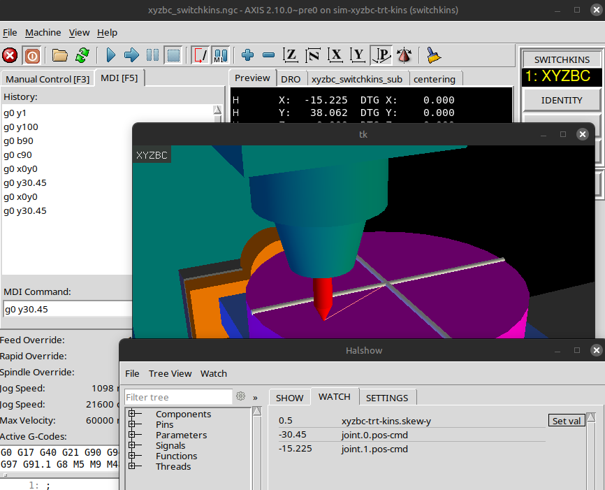

24 Dec 2024 05:21 - 24 Dec 2024 05:22 #317274
Replied by Aciera on topic Skew correction/perpendicularity correction (millkins or millkins_xyz)

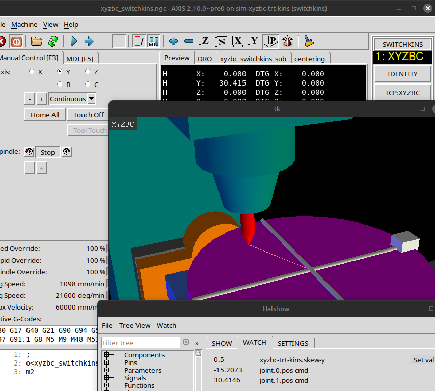

As a little illustration I 'added' the skew-y to xyzbc tcp kinematics in what we might think would do the trick:
Note that things seem to look great when we start out with no rotation of the table:
However when we rotate the table 90° we realize that we have actually skewed the Work Coordinate system:

} // xyzbcKinematicsInverse()Note that things seem to look great when we start out with no rotation of the table:
Last edit: 24 Dec 2024 05:22 by Aciera.

- abdulasis12
- Posts: 133
- Thank you received: 8

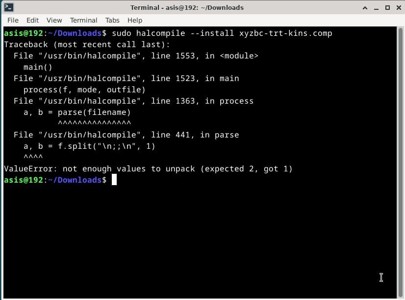

I want to try, I create file name
xyzbc-trt-kins.comp and inside I put your code skew + xyzbc .
and compile it's.
but show error can't to unpack
what I'm wrong for compile file ?
FYI: I compile on new PC to test first , Because I fear this made my CNC PC broken and can't to working.
Thank you,

25 Dec 2024 06:24 - 25 Dec 2024 06:27 #317345
1. It's not a '.comp' file but '.c' (the 'comp' format is a more recently added way of creating kinematics files ) also you must not change the file name as the trt-kinematics consists of more than just 'trtfuncs.c'
2. if you want to try to compile it with halcompile just use my file to replace the standard 'trtfuncs.c' file and then do3. If halcompile fails to compile it then you probably need to build linuxcnc locally from the repo first, replace the 'trtfuncs.c' and recompile using 'make'
linuxcnc.org/docs/master/html/code/building-linuxcnc.html
sudo halcompile --install src/emc/kinematics/trtfuncs.clinuxcnc.org/docs/master/html/code/building-linuxcnc.html
Last edit: 25 Dec 2024 06:27 by Aciera.

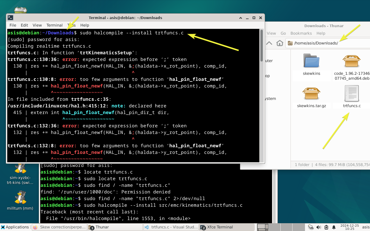

I try
I change to dir downloads and change cmd to : sudo halcompile --install trtfuncs.c
this correct ?
then like halcompile respond but found error about code inside file, or can't use halcompile ?
I see in error red letter on " ; " don't know problem from its or not.
thank you,
Asis

- Posts: 4819
- Thank you received: 2177
25 Dec 2024 15:18 #317373
There is a problem with linebreaks in the code above from pasting. I'll post the file tomorrow. Or you can fix it in a text editor in the mean time.

- Posts: 4819
26 Dec 2024 01:47 #317391
That's what I expected. As a workaround you can build linuxcnc on your computer:
The following user(s) said Thank You: abdulasis12

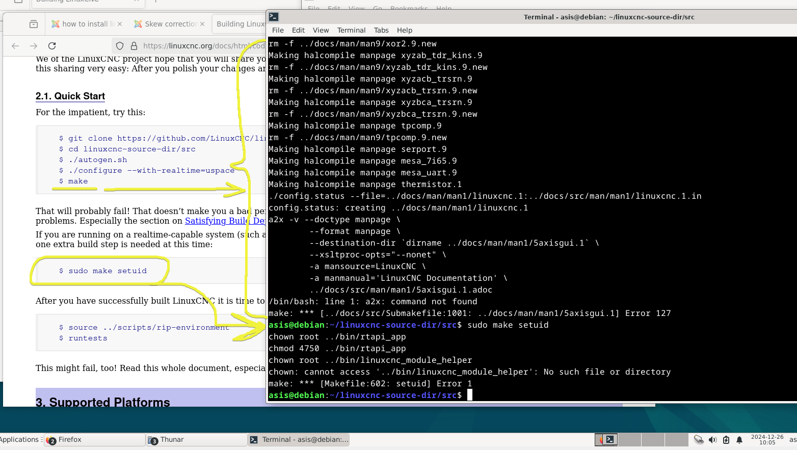

26 Dec 2024 09:18 #317410
by abdulasis12
Replied by abdulasis12 on topic Skew correction/perpendicularity correction (millkins or millkins_xyz)
Hi Aciera
I use this
$ git clone github.com/LinuxCNC/linuxcnc.git linuxcnc-source-dir
$ cd linuxcnc-source-dir/src
and I replace file trtfuncs.c (inside skew func) on this step (correct right ?)
Then, cmd :
$ ./autogen.sh
$ ./configure --with-realtime=uspace
it's look good and I use cmd : $ make
it's loading and show in picture attach file , this not complete compile right ?
Error :
/bin/bash: line 1: a2x: command not found
make: * [../docs/src/Submakefile:1001: ../docs/man/man1/5axisgui.1] Error 127
How to solve this problem ?
I think it's near succes with your help ^^"
