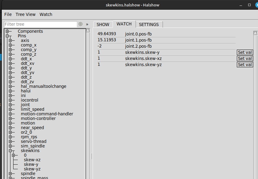

30 Nov 2024 08:16 #315618
by abdulasis12
Replied by abdulasis12 on topic Skew correction/perpendicularity correction (millkins or millkins_xyz)
Hi
I want somebody help
I think now my CNC problem seem this topic.
My CNC XYZ and Y correct linear move
my X axis table on Y-axis base it's Skewed angle .
forum.linuxcnc.org/49-basic-configuratio...s-xyz?start=0#280714
I D/L this file from MR.Aciera
I open terminal and compile file
asis@192:~/Downloads/skewkins$ sudo halcompile --install skewkins.comp
[sudo] password for asis:
Compiling realtime skewkins.c
Linking skewkins.so
cp skewkins.so /usr/lib/linuxcnc/modules/
I open hal
#loadrt [KINS]KINEMATICS
loadrt skewkins
setp skewkins.skew 0.01
I open ini
[KINS]
JOINTS = 4
KINEMATICS = skewkins
this problem when run linuxcnc
Debug file information:
Note: Using POSIX realtime
./217-4x.hal:7: parameter or pin 'skewkins.skew' not found
9192
Stopping realtime threads
Unloading hal components
what i'm wrong ?

30 Nov 2024 09:48 #315627
Replied by Aciera on topic Skew correction/perpendicularity correction (millkins or millkins_xyz)
The following user(s) said Thank You: abdulasis12

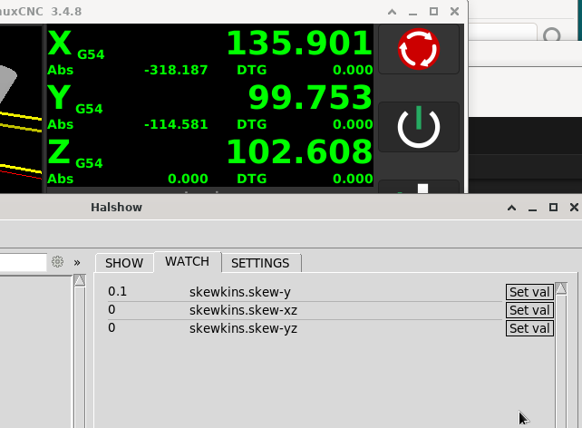

02 Dec 2024 11:30 #315779
by abdulasis12
- Posts: 4819
- Thank you received: 2177
02 Dec 2024 12:17 - 02 Dec 2024 12:18 #315783
It's a ratio. units of skew in Y per unit of travel in X. If you set 'skew-y' to 0.1 then moving the y-axis in the positive direction will have the x-axis move 0.1 units in the negative direction for every unit of y-travel.
j [0] = pos->tran.x - pos->tran.y*(*(haldata->skew_y)) - pos->tran.z*(*(haldata->skew_xz));
j [1] = pos->tran.y - pos->tran.z*(*(haldata->skew_yz));
j [2] = pos->tran.z;
Last edit: 02 Dec 2024 12:18 by Aciera.

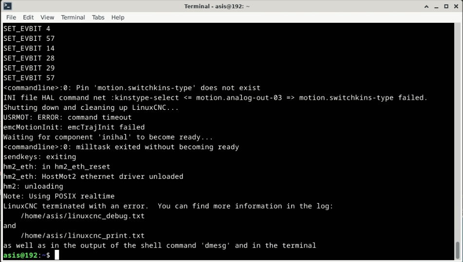

20 Dec 2024 10:03 #317035
by abdulasis12
This I understand.
corrective terms to the forward and inverse kinematic models of the xyzac-trt kins.
This is hard for me , not understand.
Now I open .hal of xyzbc and i add
loadrt skewkins
before line
loadrt xyzbc-trt-kins sparm=identityfirst
try to run linuxcnc and error :
<commandline>:0: Pin 'motion.switchkins-type' does not exist
INI file HAL command net :kinstype-select <= motion.analog-out-03 => motion.switchkins-type failed.
Could you please guide me? I am ready to learn it
Thank you,
Asis

- Posts: 4819
20 Dec 2024 12:19 - 20 Dec 2024 12:21 #317038
you have to build the skew function into the xyzbc-trt kinematics file and recompile it.
