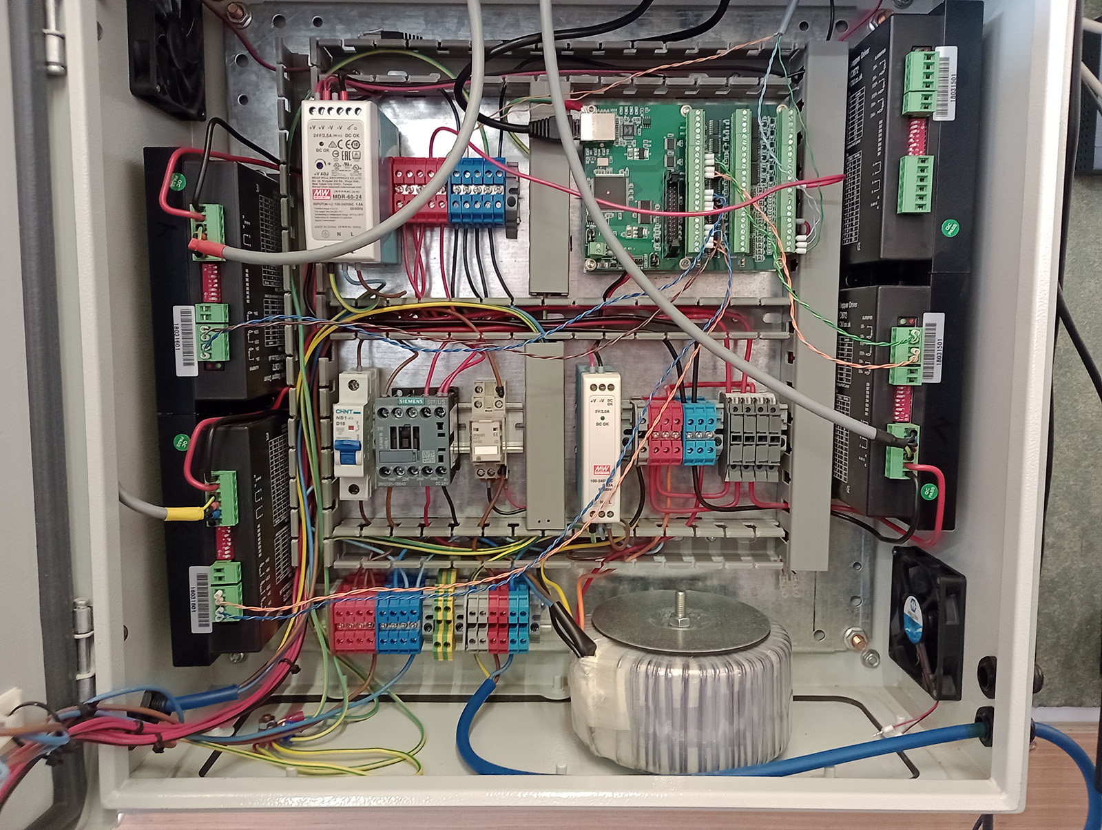

Pictures of the probe and it's wiring in full, including control box.
Probe tripping at random is a wiring/signaling/grounding/shielding issue.
Sorry to have to say this, but seeking software solutions for hardware issues is never ever a good idea.

You did ask for pics of probe and control box - they don't serve any real purpose as the noise issues are sorted and my question is really about modifying the .hal file, but here they are anyway.

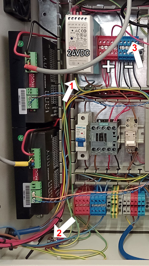

I sorted out the grounding by connecting the 24VDC common neutral to the control box frame ground - I'm told that technically this is bad practice BUT all of the random triggers have disappeared....
Juts to clarify, you mean the DC side 0V or - or GND side of the DC output, right?
That should be grounded for noisy installations, always, all power supplies i had till 2016 had this tied to ground inside the power supply, some new ones do not but some still do.
Hell, even laptop power supplies with 3 prongs usually (again, before, always) have the 0V side tied to ground.
Even bigger hell, my Mazak has that tied to the case/chassis/all 3.5 tons of metal, uses sinking sensors/switches and stuff so everything goes to ground, worked with the original control, works with Mesa and LinuxCNC without issues.
All this is as i do not get it who would say that is a bad practice, except if there is no grounding anywhere and no option for providing it. Only in this case it might be better not tying it to ground as the chassis/case would act like an antenna.
---BUT, if you mean the neutral on the line power side, that is never ever a good idea. If this is not the case, please do not refer to" - or 0V or GND " as "neutral" ever, that sent shivers down my spine, bad sh1t can happen...
I do understand the confusion as this "internet experts" naming stuff at random to look smart has gotten out of hand, -V is negative voltage, 0V is common, +V is positive, that is it. Naming 0V as -24V is wrong always as power supplies can have negative voltages so for us in electronics seeing +24V and -24V is always 48V, naming it GND is OK only if it is actually tied to ground, but not dangerous or wrong per se.
Sorry for the long winded reply, but no neutral, please.
Heh - sorry - no, I didn't mean that.  See the attached pic.
To the right of the 24VDC PS I have the common positive & negative terminals that come off that supply.  The earth on the AC side of the 24VDC supply (arrow 1) is connected to frame ground (arrow 2), and so is the green and yellow wire coming off the common negative terminals (arrow 3).  Frame ground also has the earth coming in from the AC mains attached to it - and this is what I'm told is bad practice (DC and AC sharing earth).  Having said that, connecting that 24VDC common negative terminal to the frame ground solved ALL of the noise issues that the addition of the probe & its wires had introduced.
