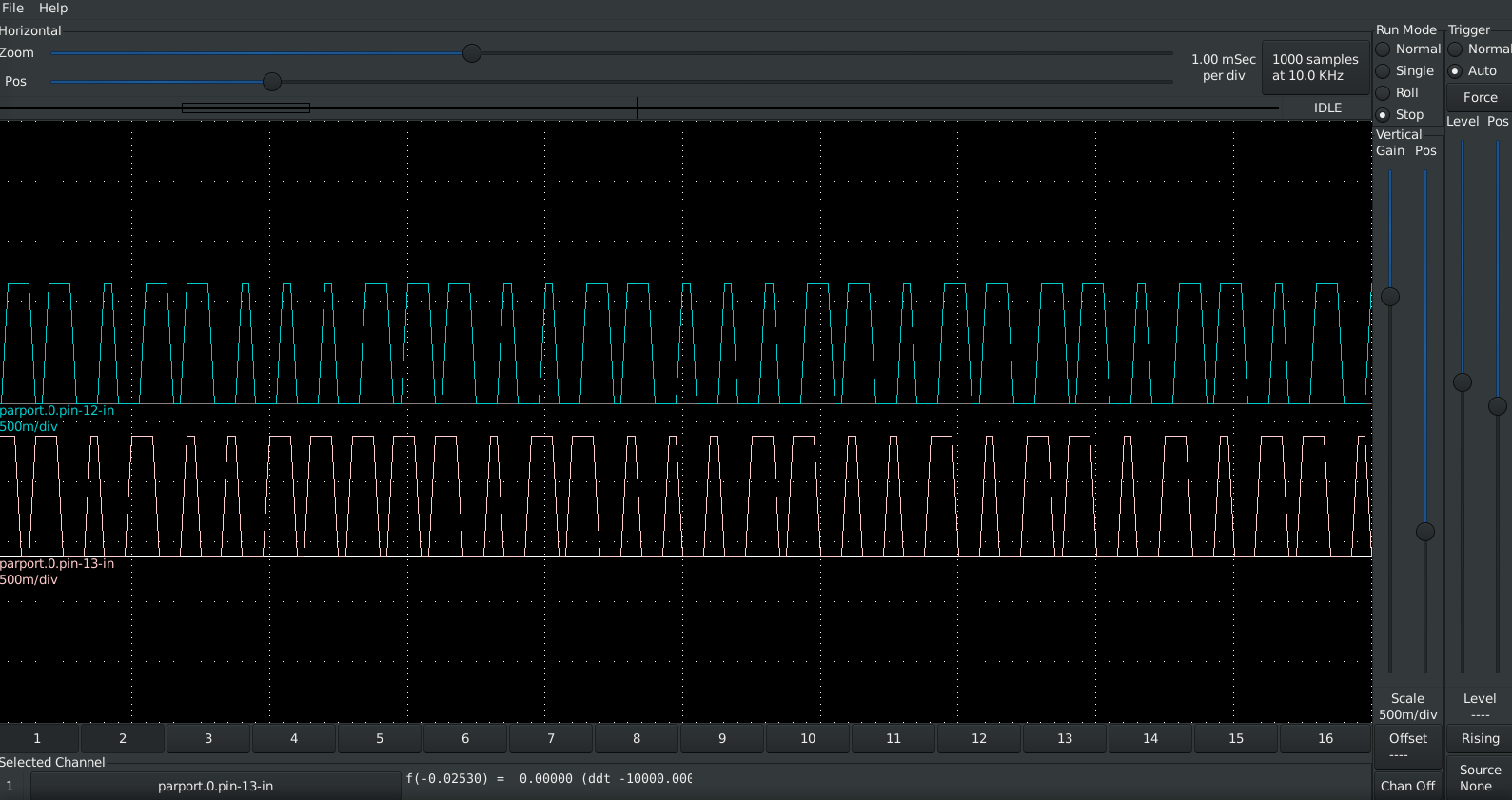

I currently have two issues with my spindle encoder I just installed. The first is figuring out how to get the speed feedback bar working in gmoccapy. The second is the feedback rpm is not at all correct above about 300rpm. I am working with a C11G parport board.
On the first issue, I know I need to put "net spindle-fb-rpm-abs-filtered => gmoccapy.spindle_feedback_bar" and "net spindle-at-speed => gmoccapy.spindle_at_speed_led" in the custom postgui hal file, and that's fine, but the problem is I'm not sure how to set up the main hal file to get the "spindle-fb-rpm-abs-filtered" output. I have looked as much as I can but other people have them set up for ethernet setups instead of parport. If anyone could guide me in the right direction to set up the spindle output, that would be great. I have been testing the rpm in axis with the pyvcp panel since gmoccapy feedback isn't working.
The second issue is the feedback rpm in axis pyvcp panel and halshow is jumping around a lot above 300rpm. It goes from 20 to about 500rpm randomly, so it's not getting the encoder signal correctly for some reason. I am using a 360p/r encoder at 5V. It has a gear increase so I have it set to 480p/r, or 1920p/r quad in hal. It operates slightly better without quadrature, but still has the issue.

Here is the halmeter at 50% speed, about 1000rpm.
The encoder pulses correctly at low rpm, so it's not that. It also doesn't appear to be a noise issue, I have it away from power wires. The only thing I can think of right now is it may be a timing issue of some sort. I have it assigned to the base clock right now. If anyone knows what could be causing this, that would be great.

Do you get latency warnings when you start LinuxCNC?
Using a parallel port limits a lot the speed of pulses it can generate or read, in your case 10000 pulses per second, and that is exactly where you are running into issues as 300RPM at 1920 PPR is 9600 pulses per second, granted 1920 is 960 pulses per pin plus 960 pauses in between.
A 100PPR encoder would help a bit, in your case probably 900-1200 RPM, but again way to low to be usable.
If you just need the speed, a sensor with a slotted disk with 5-10 slots will do just fine and get to over 10000 RPM readings.

Yes, I was a bit concerned with the latency issues of parport. Would the best solution here be to switch to a 7i96s or similar to fix this? I would like to do synced motion. Switching boards will definitely be quite a bit of work for me, I'll also need to get a relay board and pwm to analog converter for the spindle control. But if that's the only way to get higher speeds, then that might be what I do.

Mesa 7i96S has a spindle output and spindle encoder input, it does analog 0-10V out of the box.
Also can read encoder in mega hertz ranges per second, so any encoder will do.

I tried a (cheap) parport BOB with a 100 ppr Encoder. The thing was hopeless.
It was loosing signals all the time even at relatively low spindle speeds below 500 rpm.
Use a dedicated hardware! The only useful advise I can give. Tommylight is right.

I am running a 100p/r over one of the cheapest possible BOB you can make out of kicad and $4 worth of passives, opto and connectors, and I am getting spot-on pulse for Phase A, Phase B and Index Z (all 3) up to 2200RPM. Measured with both a Rigol 250Mhz oscilloscope and confirmed with the Lncn software scope. And that after a few hundred thread and rigid tapping operations. None failed. Sure you're not hosting the town's EMI and entire district's noise in your system?

For others who are looking for an easy, cost effective and highly reliable A, B and Z pulse solution (0~2200RPM).
Encoder used OMRON E6B2-CWZ3E
LinuxCnc 2.9.1, Debian 12. Shielded signal wired.
Geez...

2200RPM is a very slow spindle, so it works easily with parallel port, granted you have good optos and a good PC latency ...
See, to many things in play there, but most important is shielded cable, as you have mentioned.
And finding a PC that can reliably do 50000 base period is becoming harder, as is finding it with a built in parallel port.
