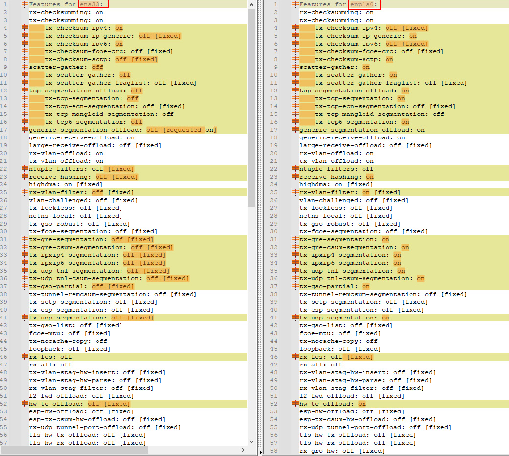

the first command is not returning anything, even with the right interface name which is enp1s0 in my case.
outputs from ethtools:
EDIT: Also, if the name of the interface is enp1s0 does the previous change we made to the interfaces file starting with eth1 does anything?
driver: igb
version: 6.1.0-17-rt-amd64
firmware-version: 0. 6-2
expansion-rom-version:
bus-info: 0000:01:00.0
supports-statistics: yes
supports-test: yes
supports-eeprom-access: yes
supports-register-dump: yes
supports-priv-flags: yes$ sudo ethtool --show-features enp1s0

Attached 's a side-by-side compare of your enp1s0 against another that ping avg 0.04ms with 0pkt losses. I'm not saying your interface is the issue, could also well be core/processing related given the less-than-ideal 80k'ish latency figures.
Fancy getting familiar with [hint] the system's interrupts affinity and policies? Trust this 'tweaking-jazz' is endless and often makes things worst, as much as occasionally yielding surprising performance enhancements. I'd try that before thinking of getting the Linuxcnc Pro-Gear™

the driver is igb from intel.
Have you disabled coalescing as described in man hm2_eth?
