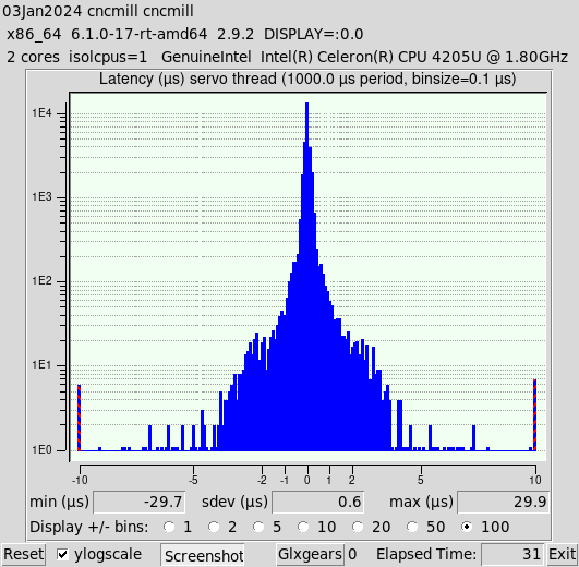

Run this and share a screen dump. It will confirm isolcpus is set
I hve never used a 2 core machine with linuxcnc, mostly 4 core celerons J1900 and up. I kind of think the 2 cores are at the end of life but a few people have got them going. Generally with a compiled kernel which is your next step. There was a thread recently where somebody showed how to compile the 6.6 kernel
latency-histogram --nobase --sbins 100I hve never used a 2 core machine with linuxcnc, mostly 4 core celerons J1900 and up. I kind of think the 2 cores are at the end of life but a few people have got them going. Generally with a compiled kernel which is your next step. There was a thread recently where somebody showed how to compile the 6.6 kernel

03 Jan 2024 06:28 #289652

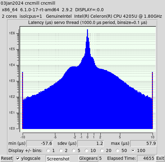

Are you still getting realtime delays?
In answer to your question latency under 150000 even up to 200000 are generally OK.
You need to run the test for longer and run a few glxgears

03 Jan 2024 07:51 - 03 Jan 2024 07:52 #289658
by chienMouille
Replied by chienMouille on topic Another realtime delay question - Mesa card
So herewith is the new screenshot after a while and with 5 glxgears. So it's quite exactly 150000 right?
I still get realtime error messages.
Here is the timing in the ini file. should I change it?
Otherwise, should I compile a Kernel? I must say I like high level stuff like python coding, but words like kernel and compile together give me shivers.
Another option would be to get something like this:
www.prodimex.ch/gigabyte-brix-gb-bace-31...ace-3160-109329.html
quad core. and migrate the ssd and the ram from the one I have. Would this make sense?

You have not said if you are still getting real time errors. It might now be OK.
The Gigabyt N3160 is gennerally fine. I have used one for several years.
They have a realtek driver so you will probably have to install the r8i68-dkms driver.
