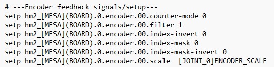

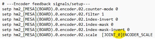

13 Oct 2024 16:05 - 13 Oct 2024 16:09 #312006
by flyingbrick
Replied by flyingbrick on topic 7i97T with Mesa CT- Desn't seem to be outputting an analogue signal.
Hi PCW.
I believe I have found an error in the mesaCT's hal file... but I could be wrong (I have just been comparing axis and trying to figure out how these files work)
Can you confirm that the highlighted joint reference is wrong
This is X Axis, joint 00
And this is Z Axis, joint 02. Should the highlighted say 2 rather than 0?
Edit. If the highlighted is wrong, looks like Mesa CT was correct for joint 00 but it has this error for joints 01 and 02, for PWM scale and Encoder scale.
Last edit: 13 Oct 2024 16:09 by flyingbrick.
