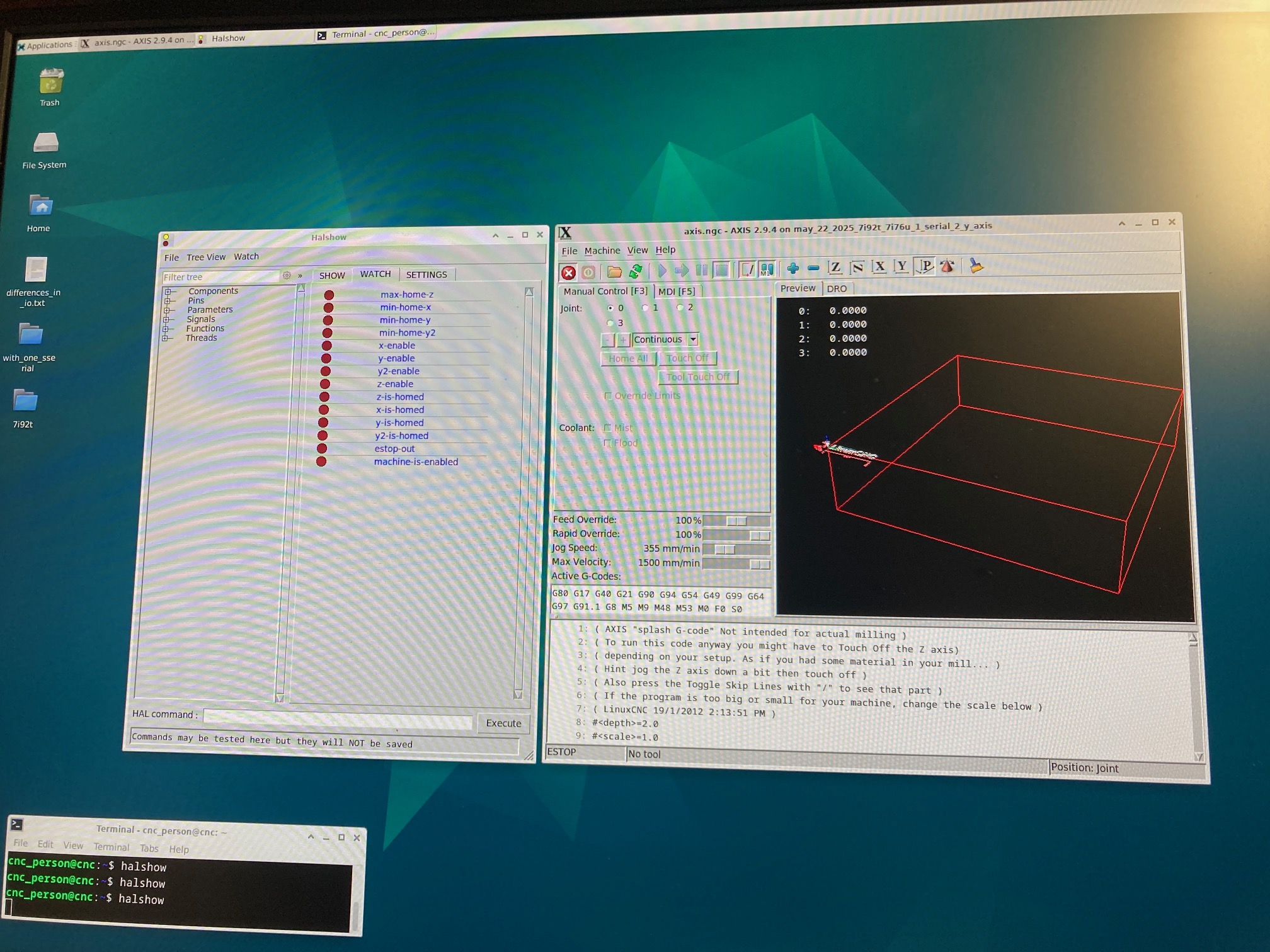

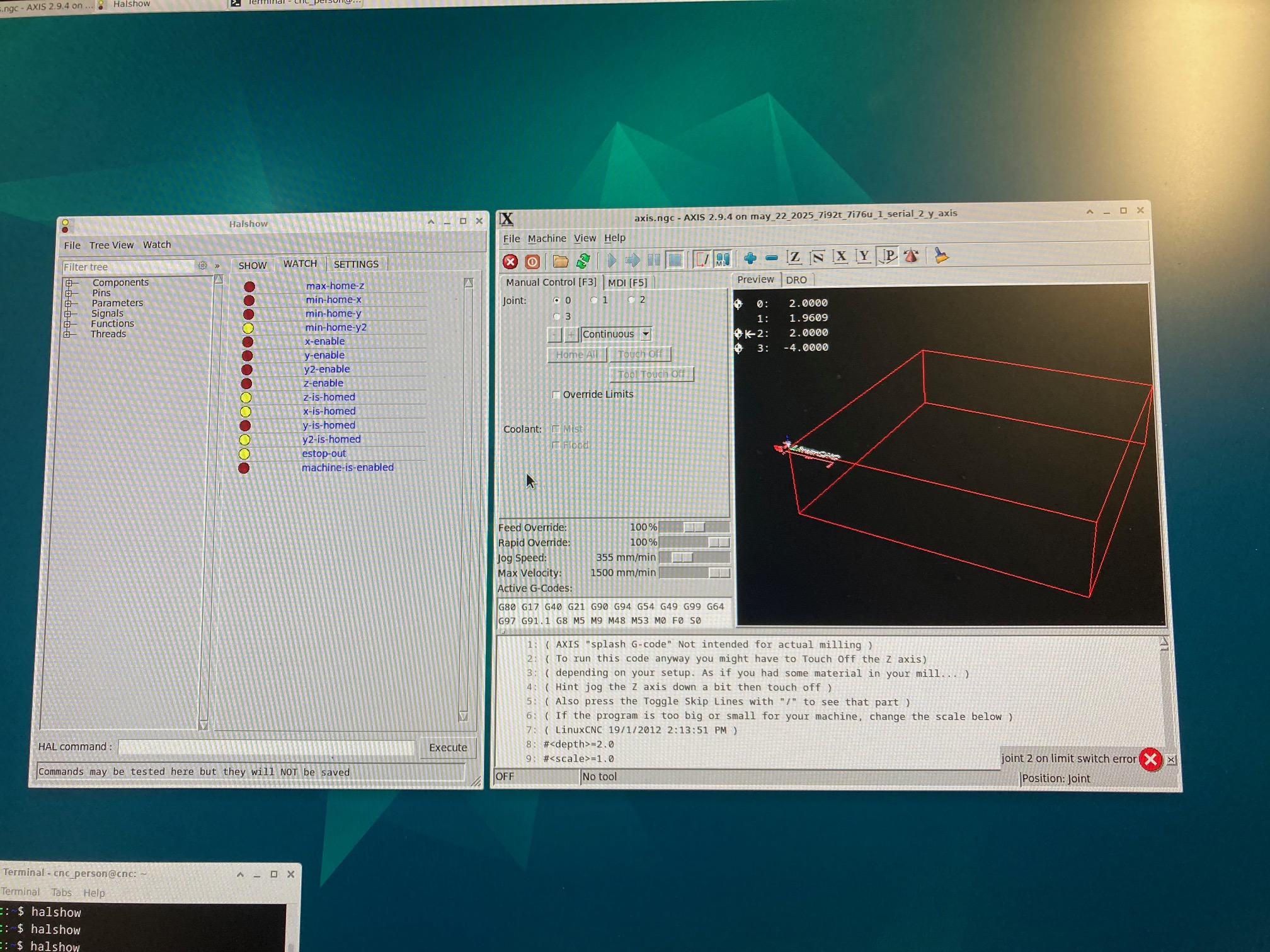

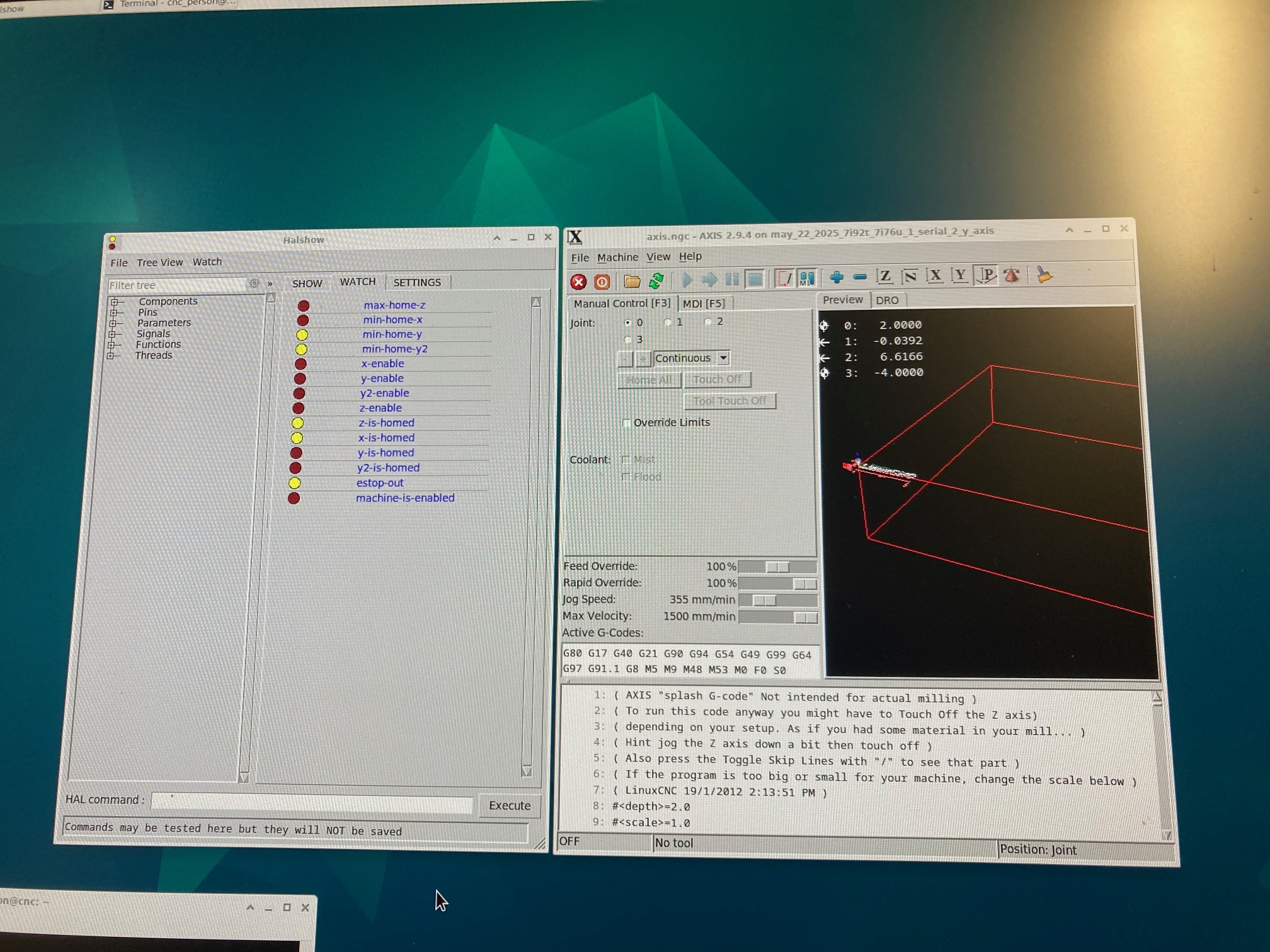

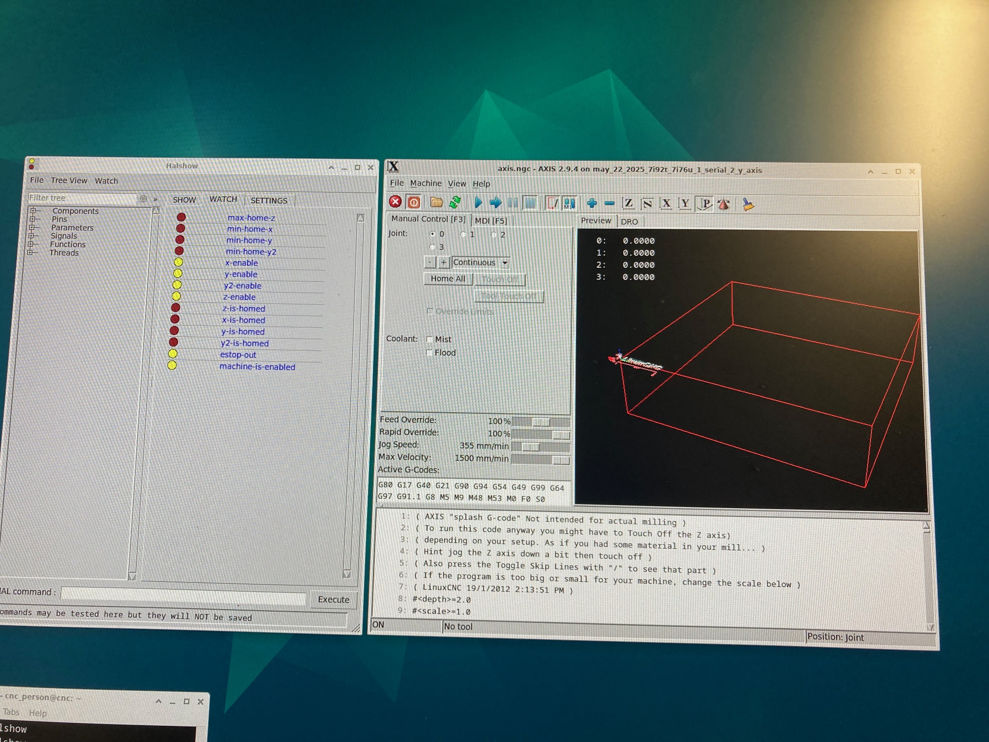

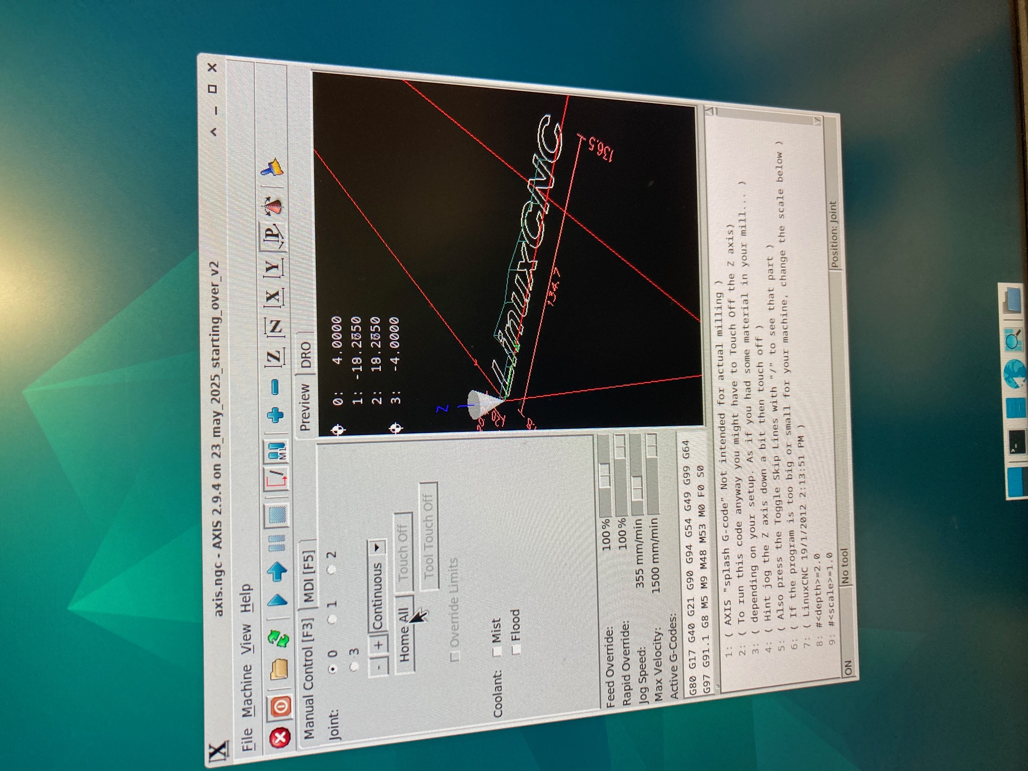

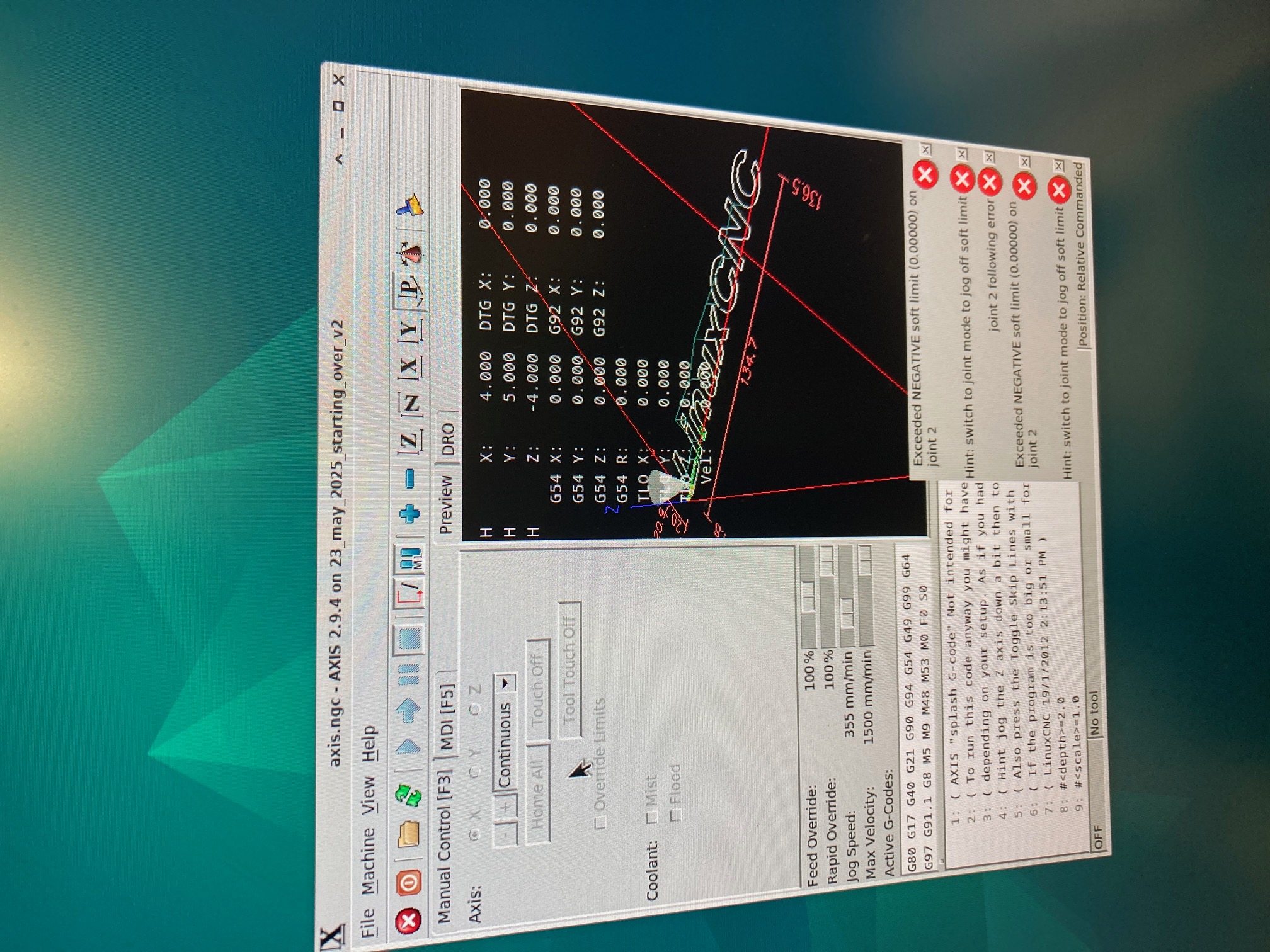

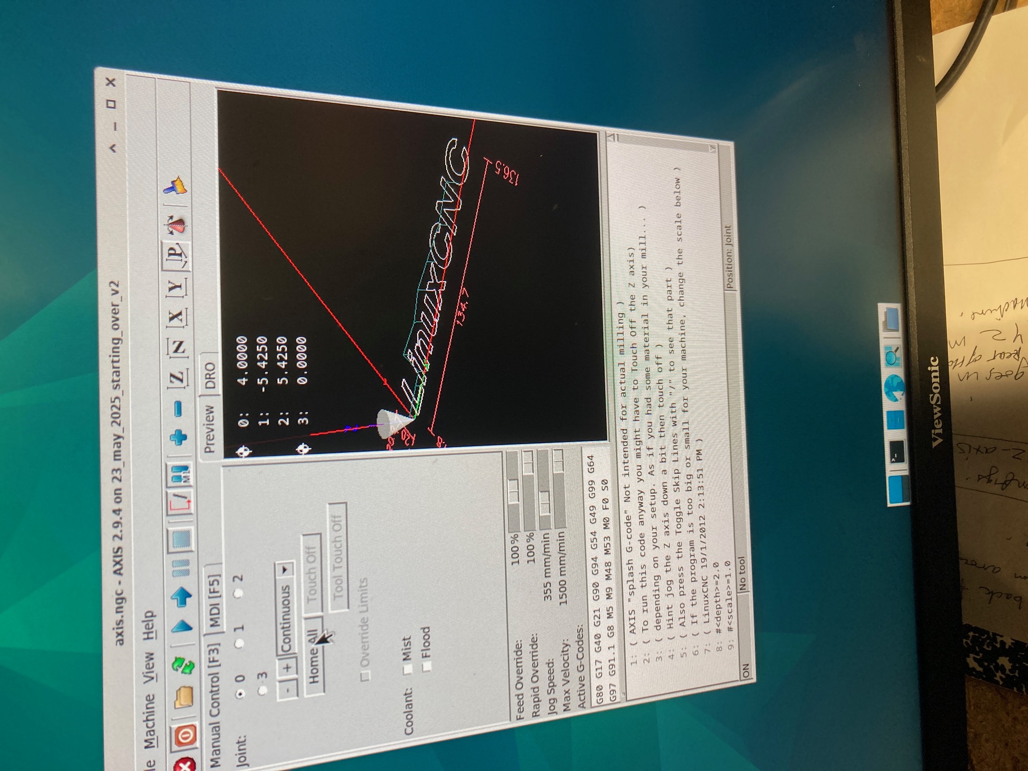

I have attached three screen photos with halshow
first - just switched on power supplies, and launched Linuxcnc.
second - after clicked estop, and clicked power.
third - end state after all thee axis homing has completed.
Physically the Y gantry does the correct four step movement.
However, Linuxcnc errors out right at the very end, indicating joint2 on limit switch error.
The y-is-homed is red , while x-is-homed, y2-is-homed and z-is-homed are all yellow.
These are the cheap 2mm proximity sensors , tommylight said earlier that these are best avoided.
I will buy better quality ones.

The attached file , Homes as the photos show. (But Y2 jogs in the opposite direction)

My Y1 jogs in the correct direction, my Y2 jogs in the opposite direction.
Many thanks
The long version of what I tried ....
The config attached is my last known good which Homes all three axis (with a but ...)
(X zero, and Y zero, is front bottom left - when standing in front of the machine , looking at it).
But ...
if I move the Y axis gantry as a whole , after homing completes, (jogging just 1mm at a time)
the Y1 gantry motor goes 1mm towards the rear of the machine (which is correct)
and
the Y2 gantry motor goes 1mm towards the front of the machine (which is incorrect)
So it just ends up racking the machine in slow motion
I tried very many settings, and eventually lost my way, and ended up relentlessly crashing the Y2 side of the machine
I don't know what settings to try to get the Y2 motor to Jog correctly, without affecting the Homing
All motors are wired in exactly the same order, from the drivers to the motors
So I tried physically swapping the Y2 dir- and dir+ , but it didn't help the end result any
I also made a config of just X and Y1 and Y2 (no Z) and NOT as a gantry (but as independent motors)
and was therefore able to bypass gantry Homing (as without homing, the gantry won't move)
each motor ran in the correct direction, when independently jogging a few mm at a time
(testing that there wasn't a physical problem with either the wiring or with the motor drivers)
I also found that by making another test config using mesaCT, a with and without, a y2 reverse direction tick, it added two fields
STEP_INVERT= False
DIR_INVERT = True
I only tried the "DIR_INVERT = True" on the Y2 joint which didn't help either
To recap
I have been able to make the homing of all three axis Home (although the signs still make no sense to me)
I have been able to test the x and y1 and y2 motors working in their correct jogging direction (when not in a gantry mode, and not homed)
I am unable to make the machine do BOTH things (Home AND then Jog the Y axis gantry with Y1 and Y2 in sync together, so gantry doesn't rack)
Just incase there is some random element to this somewhere , I re-ran this Homing configuration successfully, ten times in a row.
