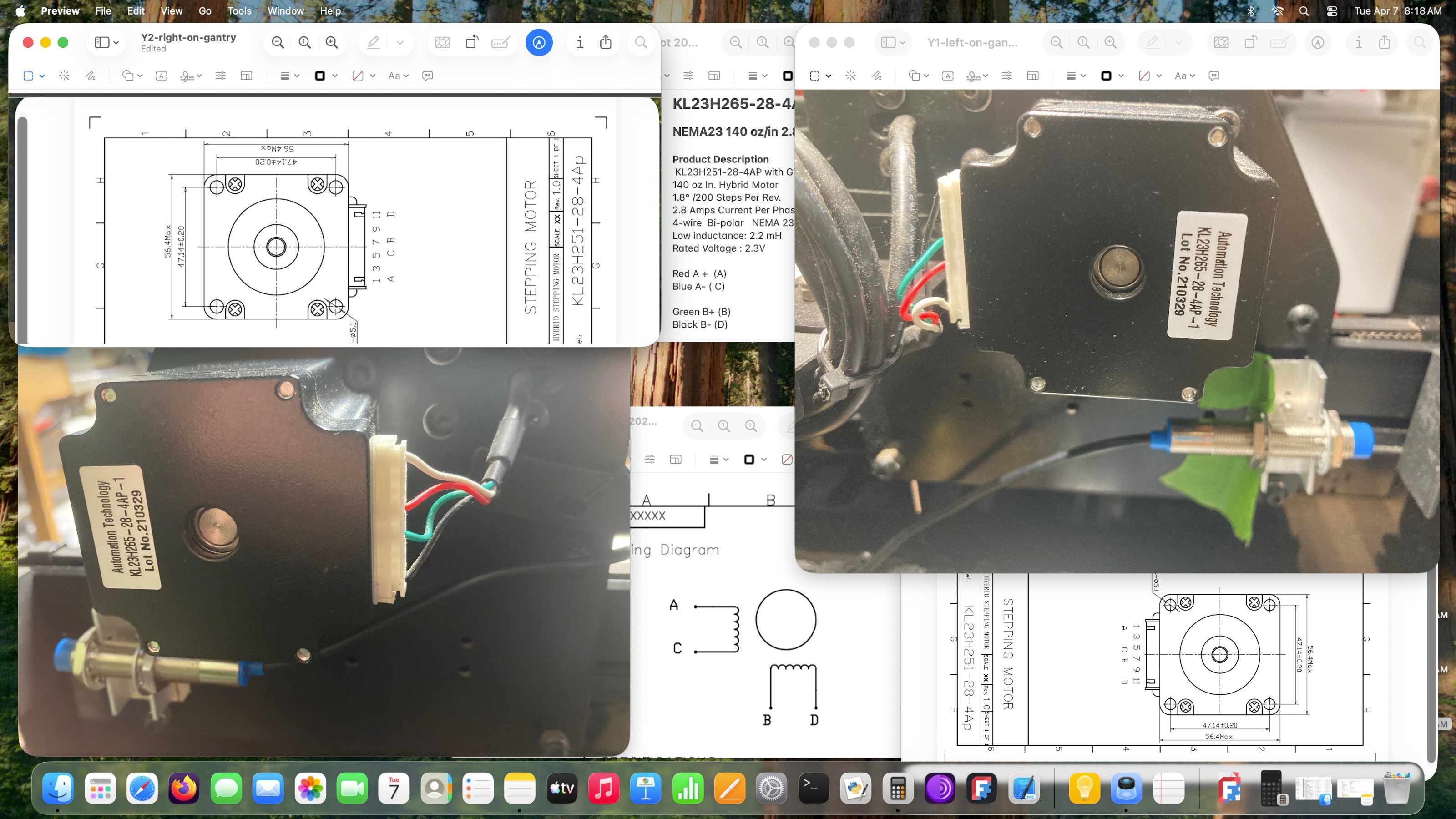

I have a question about the wiring of these two Y axis gantry motors
I attach a makeshift collage of my best effort to display the motor info, and the motors together in one place, I am sorry that it's a bit messy.
Left side of image is the Y2 gantry motor. Left edge of the photo is the front of the machine.
Right side of photo is the Y1 gantry motor (green tape). Right edge of photo is the front of the machine.
I orientated the motor specification, to the same orientation as each motor.
From motor connector pin 1 to pin 11 . No matter the motor orientation , the order of these molded motor connectors is black, green, red, white
However , given that the motors are physically facing each other, if I were able to stand behind the machine , and be able to see both the motor connectors at the same time,
In my head , I would expect to see the wiring of the connector following the same (color?) order top to bottom (which they are not)
Should I be thinking of these as “top pair” of each motor connector , and “bottom pair” of each motor connector (Irrespective of the data sheet , or color of wire) so that I am always referring to the same physical winding on each side?
This is so confusing to me.

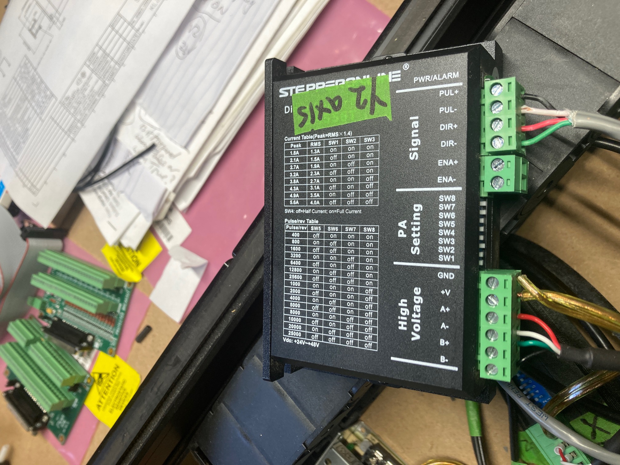

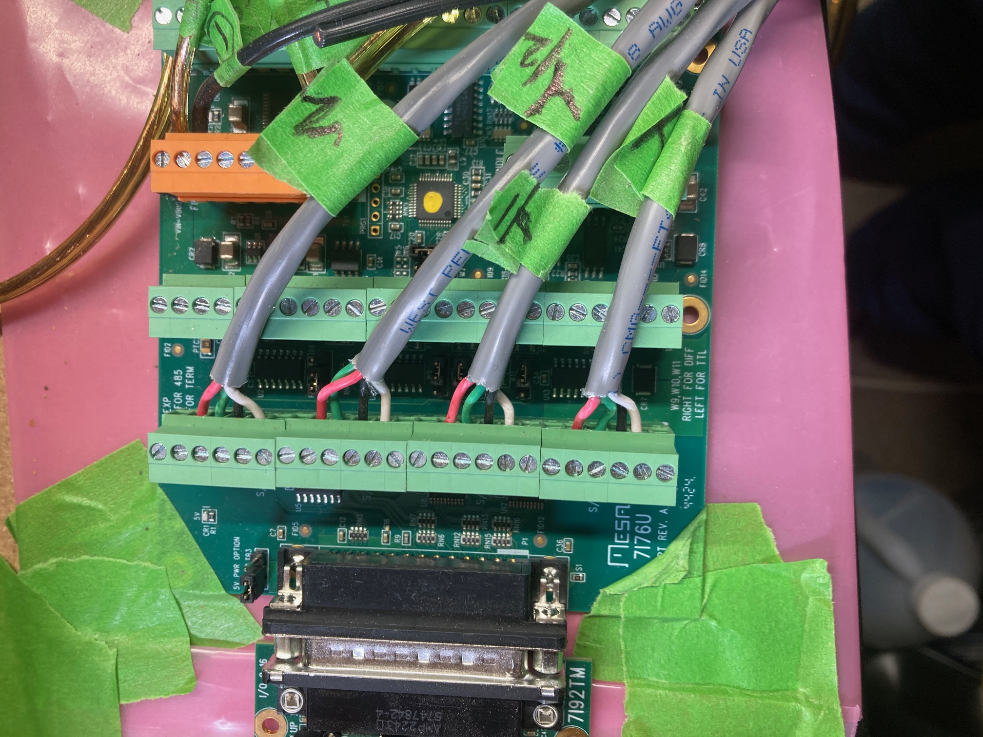

The mesa 7i96u axis TB2 0 through 3 connectors are all the same , all straight, each connector has the same color order
Input Signal on DM566 drivers follows mesa outputs.
For each mesa TB2 connector 0 through 3
Using 0 as an example
Mesa DM566 color
Pin 6 not used
Pin 5 dir (+) -> dir (+) red
Pin4 dir (-) -> dir (-) green
Pin 3 step (+) -> pul (+) black
Pin 2 step (-) -> pul(-) white
Pin 1 not used
Please ignore DM566 output labeled (High Voltage) in Y2 photo because until I understand y1 and y2 wiring its unlikely to be correct , (it currently homes correctly, but still y2 jogs in the opposite direction).

You can reverse the direction a motor goes, three ways: Swap one of the coil's wires between the driver and stepper, swap the DIR pins (or switch between DIR+/DIR- if you're not using both) between the mesa card and the driver, or change the software.
You do not need to do more than one of these.

I re-wired some of it , that didnt help, but at least it confirmed that what I had seemed reasonable, which was good to know.
The scale with a minus sign did provide another option, which I used , the comments also provided a better understanding that I might have been changing the same thing over and over just in different ways and complicating matters.
In the end I iterated through as many possibilities as possible, and eventually it both homed, and it jogged in the correct direction.
I milled a square out of a piece of plywood (using Linuxcnc v1.1.1 and the CAM workbench), and the machine seems to work fine.
