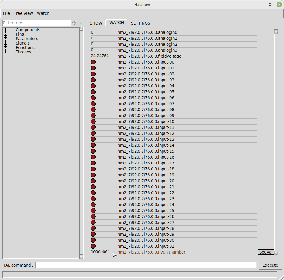

24 Jun 2025 00:28 - 24 Jun 2025 01:47 #330787
Replied by PCW on topic MESA 7i76U inputs changing state without changes to config
Well, tested the card and found no issues.
All inputs read low at 50% of field voltage and high at 65% of field voltage
applied to an input.
Heated to +70C and cooled to -40C and still no issues. Ran at 5V to 32V field
voltage and no issues.
Here is an image of all disconnected inputs in halshow (@ 24V)
