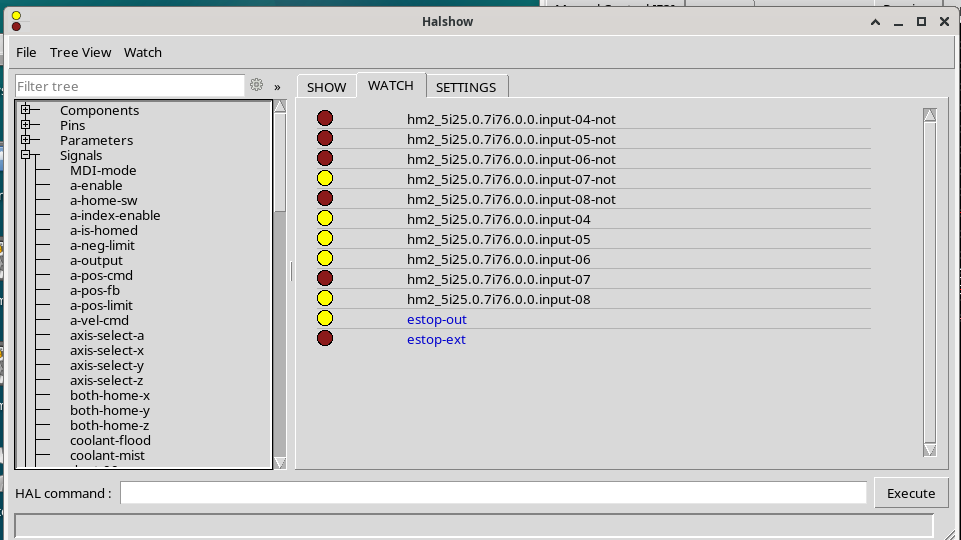

Well, that didn't work. Inputs are back to sinking inputs as specified in the manual. I did comment out the PROBE input so it is not currently part of the configuration. However, on startup LCNC continues to show the EStop button activated so I cannot continue testing Homing.
Unable to continue at testing at this point.
These are the states of the inputs at this time:
And this is my HAL config:
Any help would be greatly appreciated.

7I76U inputs are always sinking so normal connection would be:
+24V --> SWITCH --> 7I76U input
If you look in halshow, hm2_5i25.0.7i76.0.0.input-07 will always be
in the opposite state as hm2_5i25.0.7i76.0.0.input-07-not, so choosing
one or the other should make a difference.

Thank you to everyone. I've finally got the EStop to work correctly, though I don't understand why. Apparently, it works opposite of the limit switches in that there must be a high signal on the pin at startup and EStop is triggered when the switch is opened. Regardless, I can now home and run as expected.

Normally you would use a NC switch for Estop and the you would use the true (no -not)
input to sense it. This is so that when Estop is not activated (switch = closed circuit),
iocontrol.0.emc-enable-in will be true so no Estop. Then when Estop button is activated
(switch= open circuit), iocontrol.0.emc-enable-in goes false, signaling an estop event.
Did you verify that estop-ext changes state when you change the Estop button from on to off?

Yes, I now have the estop working as you specified and have verified that it stops the machine when the button is mashed (OPEN).
