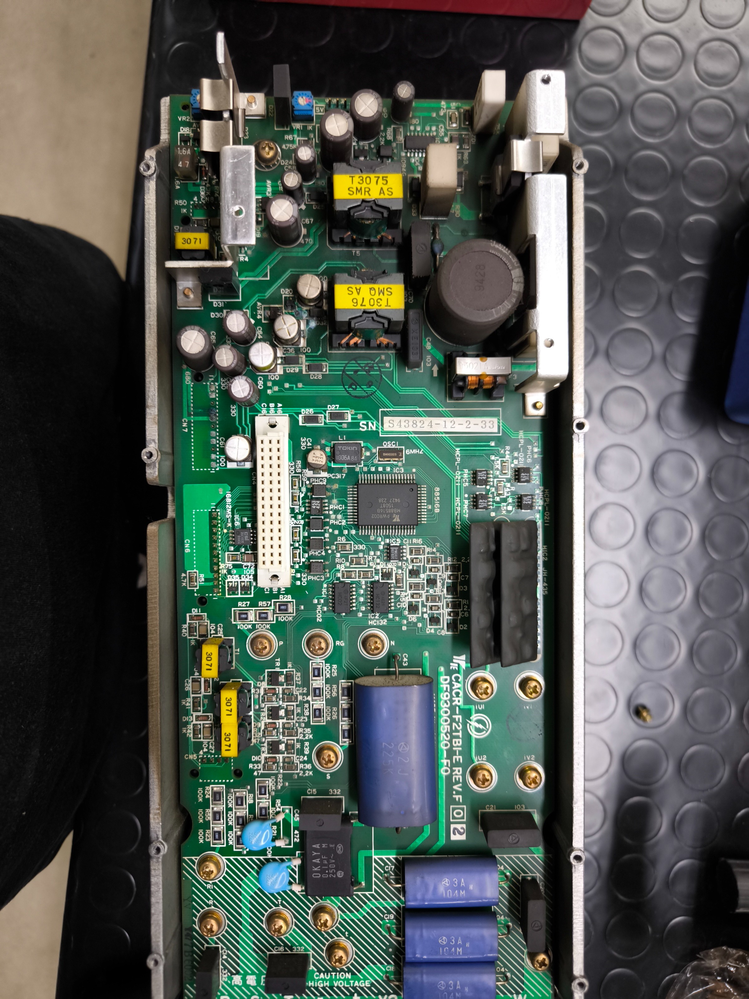

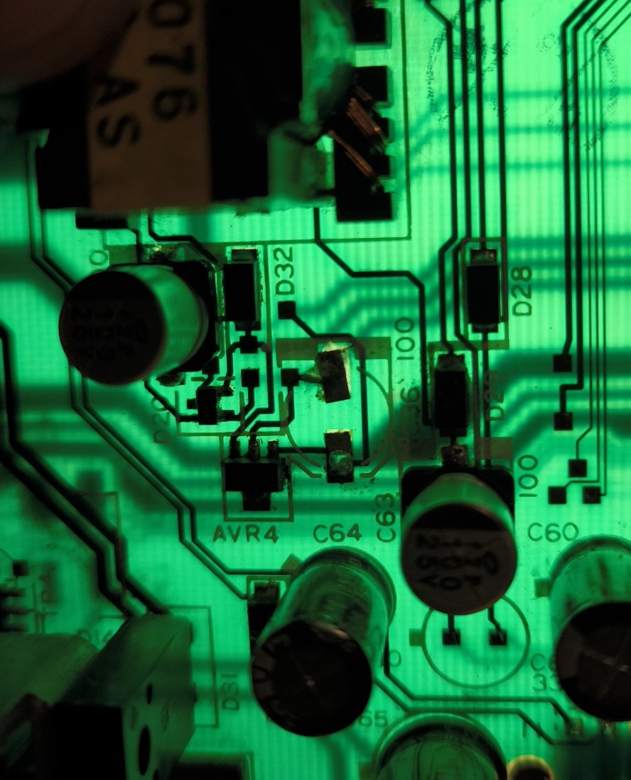

14 Oct 2025 16:14 - 14 Oct 2025 16:16 #336429
by nikopoli@live.it
Replied by nikopoli@live.it on topic Repair Servodrive Yaskawa CACR
Hello everyone,I'm working on repairing a Yaskawa CACR-SR20BE12G-E servo drive. I initially had to replace all the capacitors as two of them had incorrect values, which was causing the A.02 error. After installing the board, everything worked fine for about 30 minutes, but then the auxiliary power supply errors A.03 and A.40 appeared.I've isolated the critical components after the transformer T3076, specifically D20 (code C3) and AVR4 (code 8C E4), which now appear to be faulty.I need help confirming the identity and replacement parts for these components.1. D20 (Code C3) - Raddrizzatore SchottkyI have traced the pinout of D20 and have the following connections:CENTER PIN: Connects to the positive pole of capacitor C41 33uf 25vTOP LEFT PIN: Connects to the transformer output, passing through diode D32.RIGHT PIN: Goes to the negative side of the board (or where the letter 'N' is marked).Question: Can anyone who has successfully repaired this confirm if the correct replacement is indeed the BAT54C (Dual Common Cathode, SOT-23)?2. AVR4 (Code 8C E4) -dimension(approx. 3x2mm). The marking on my faulty board is 8C E4, while a known working board shows 8C E8 (I assume the last digit is just a batch code).Pinout/Measurements:I'm using the following numbering: Pin 1 (Top Left), Pin 2 (Center), Pin 3 (Top Right), and Pin 4 (Bottom). Note that Pin 4 is common with Pin 2 on the board.Using the diode function on my multimeter:Black probe on Pin 2 or 4, Red probe on Pin 1 or 3 Reads 2.3v- 2.4VInverting the probes Reads 0.5 - 0.6V
Can you help me please?
