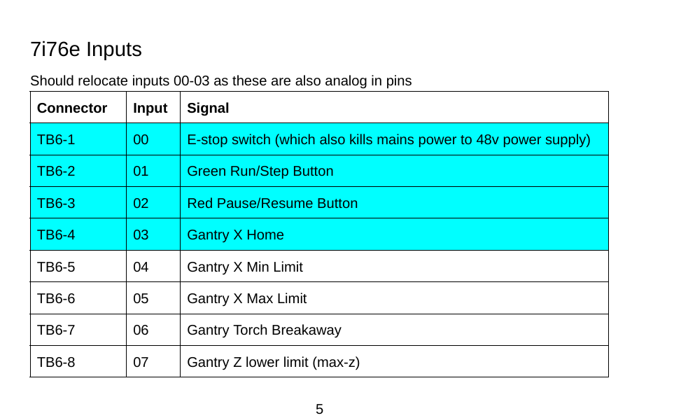

Personally, I have found maintaining a table of all of the IO pins works perfect. Well many tables actually. My plasma runs to 18 pages but it also includes a lot of notes for the next build.

I use simple text files - a spreadsheet is probably a much better idea.
It is VERY worthwhile documenting whilst building.
You might remember well during the build, but suddenly it's five years later and trying to double shoot is a nightmare. That scrap of paper you threw out or photo somewhere on an old phone in a draw is not much help.
I haven't looked in a couple of years. Last time I looked I couldn't find a really easy way to do quick wiring diagrams.
I don't need / care about proper symbols. Just want text labels and ability to snap wires to a connector block and colour them and route them vaguely

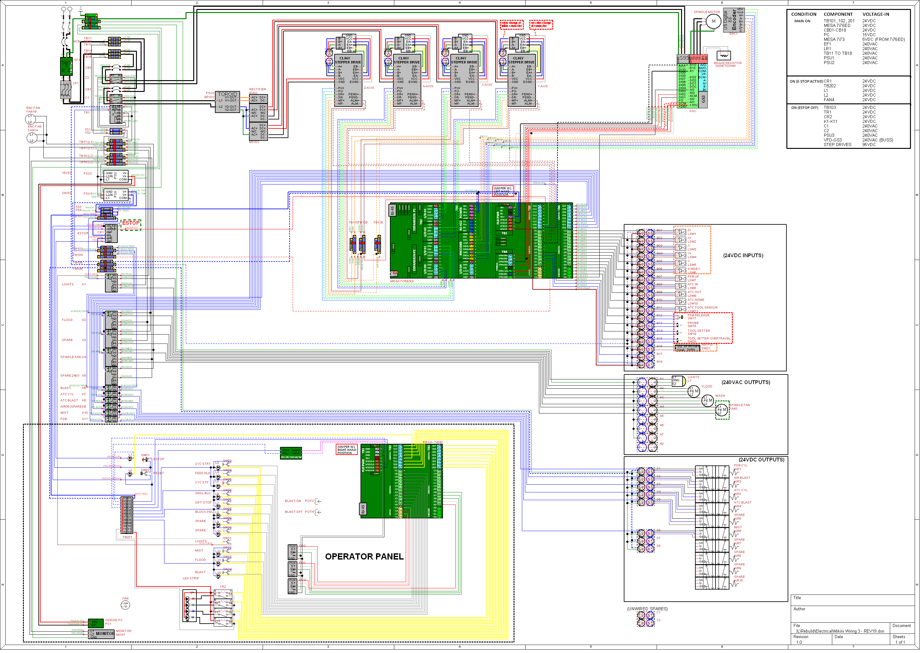

31 Jan 2022 14:46 #233635 by spumco
Replied by spumco on topic Noobie Friendly Wiring Schematic Program
QElectroTech looks like a really nice 'proper' diagram program and I've been fiddling with it since @arvidb mentioned it a couple weeks ago.  But for something to do what I think of as a schematic - i.e. how to wire the system up - TinyCAD has been my go-to for a number of years.
Wires snap to pins on any symbol you want, color-coded, line thickness to indicate wire gauge, etc.  It's not 'smart' like QElectroTech to span pages, but you can make the drawing as large as you want.  Multiple pages are also possible.
I've even got a number of symbols cooked up for Mesa cards in my home-built symbol library.
I put an example in the other thread @ardvidb linked, but here's another one of my current mill project with a 7i76ED and a 7i84D:
