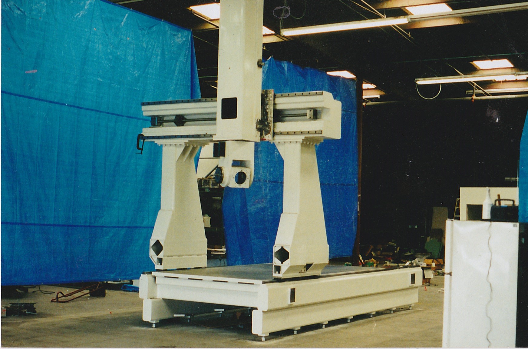

hi All the gantry is Number 3 of size and type. It is being built so Can machine the new VMC. The previous two machine were five Axis with Siemens Controls.
I would like to use a Linux control on the New Machine. The goal is to build the frames here in the US and sell the K443(40x40y30z) as a kit machined and ready to assemble offer the parts Ballscrews, Linear rails etc and have a Linux based turnkey control.

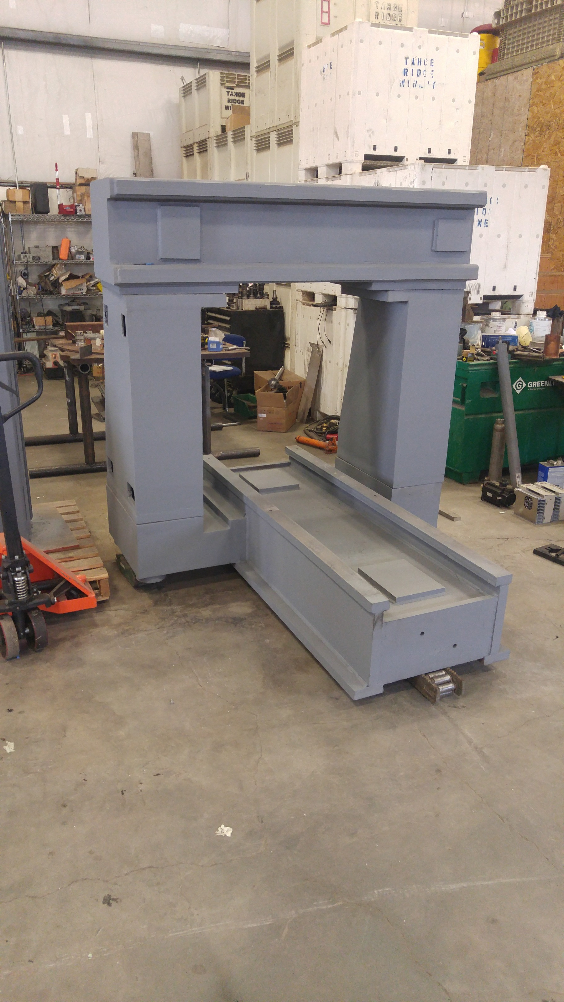

For reference the small mill frame picture and ready to be machines is 72 inches wide 84 tall and 96 deep
Any thoughts on the project or helpful suggestions are welcome its a work in progress.

Replied by tommylight on topic New CNC Mill, Expert LinuxCNC person wanted for new VMC Project.
That last one on rollers i like a lot ! To bad i am 12000 Km away, i would get one in a heart beat. I have some THK 35mm rails with long carriages new collecting dust. They would be perfect for that. Also have some 45mm, but not enough for that.
How much would that cost roughly, ground, drilled and tapped ?

Still working on Pricing for the frame and kit components. Ball screws, Linear guides bearing blocks etc. I am building two more frames like the one pictured and will keep better track of time and material. I Also have a Tool changer for it. All the mounting holes will be pre drilled and the enclosure will come as a flat pack ready to assemble.as well as chip auger and coolant tank. More pictures coming once I get some of it machined.

20HP 24 tool side mount machine weight approx 11,000 lbs. Its a full size VMC and will have full enclosure Ground Ball-screws and 45 mm Linear rails flood coolant
