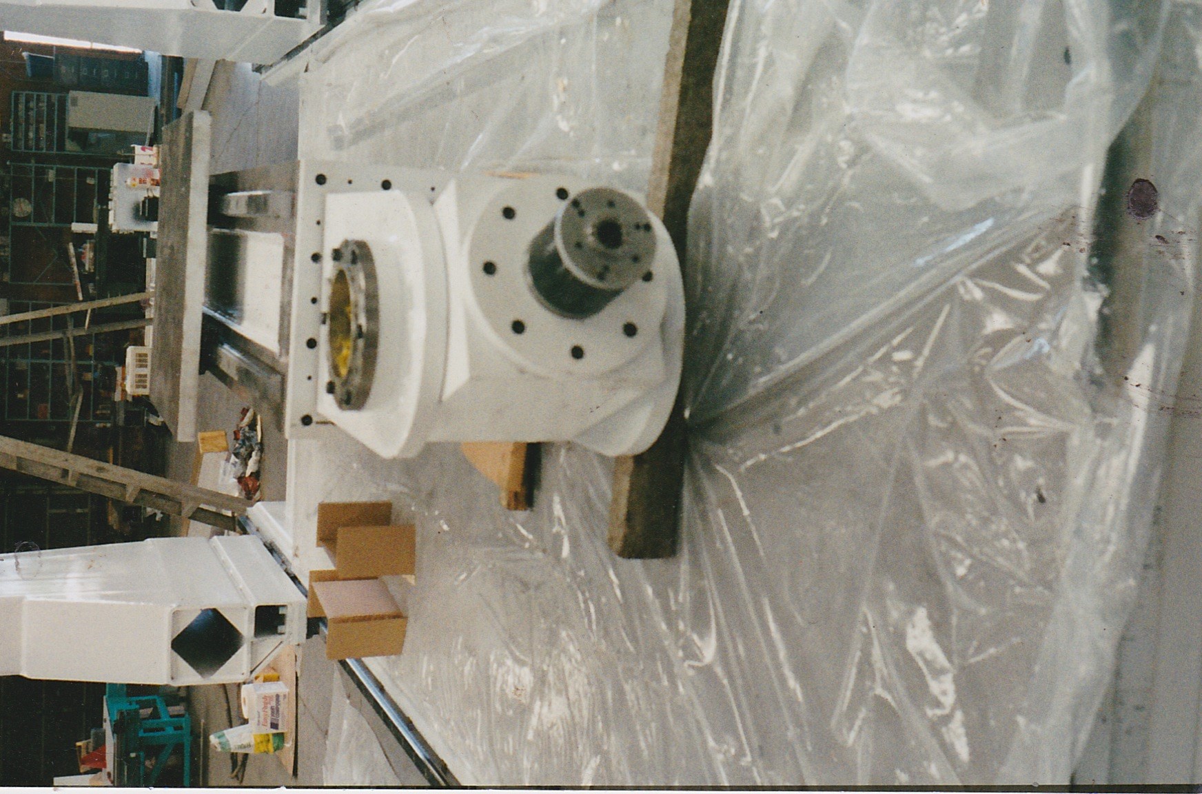

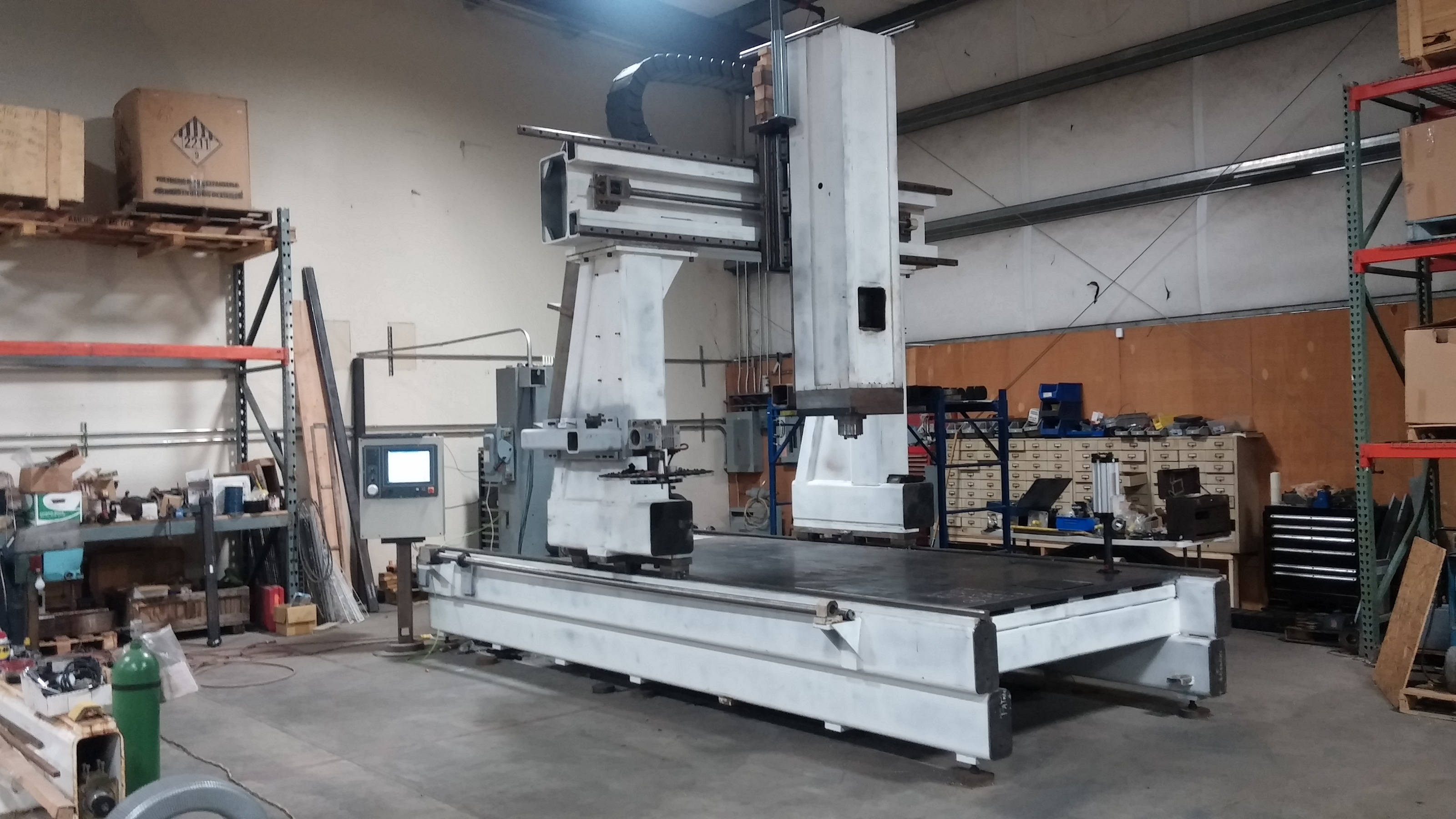

Hi, Which machine? My new mill is a Bridge Mill not a Gantry. It has 40 x 40 x 30 inches of travel. My Big Gantry has 150 x 72 x 60 with 6 Feet under the Bridge With the new mill the Y axis is the Table and the x and z or on the Bridge. I one or two axis rotary table could be fitted on the table to allow 4 or 5 axis machine work. I have several other small machine designs I am working on also Small bridge type machine. Getting more Y axis travel in a small footprint is the goal.

That was the last Gantry I built it was designed to be a five axis to make tooling for large molded parts it needed to get around all sides of the tool. The new gantry pictured is a 3 axis built for the sole purpose of machine all the parts for my new smaller machine it just 3 axis but it will have 50 Plus inches of travel in the z to be able to machine the riser of the new machine.It does have 72 inches under the Bridge. On this machine the Gantry(bridge) moves and my new small machine the Table moves in the Y axis.

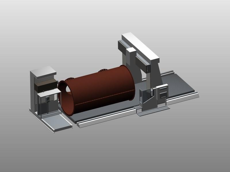

For your next machine, maybe something like this (attached PDF file)
"It features an X-axis travel
of 12m, a W-axis travel (vertical movement of
the cross-beam carried by the two columns) of
2.5m, a Y-axis travel (spindle movement along
the cross-beam) of 7.5m, and a ram stroke (Zaxis) of 1.5m. Moreover, with its German-built
Cytec head, this machine offers a full five-axis
simultaneous-machining capability. "
