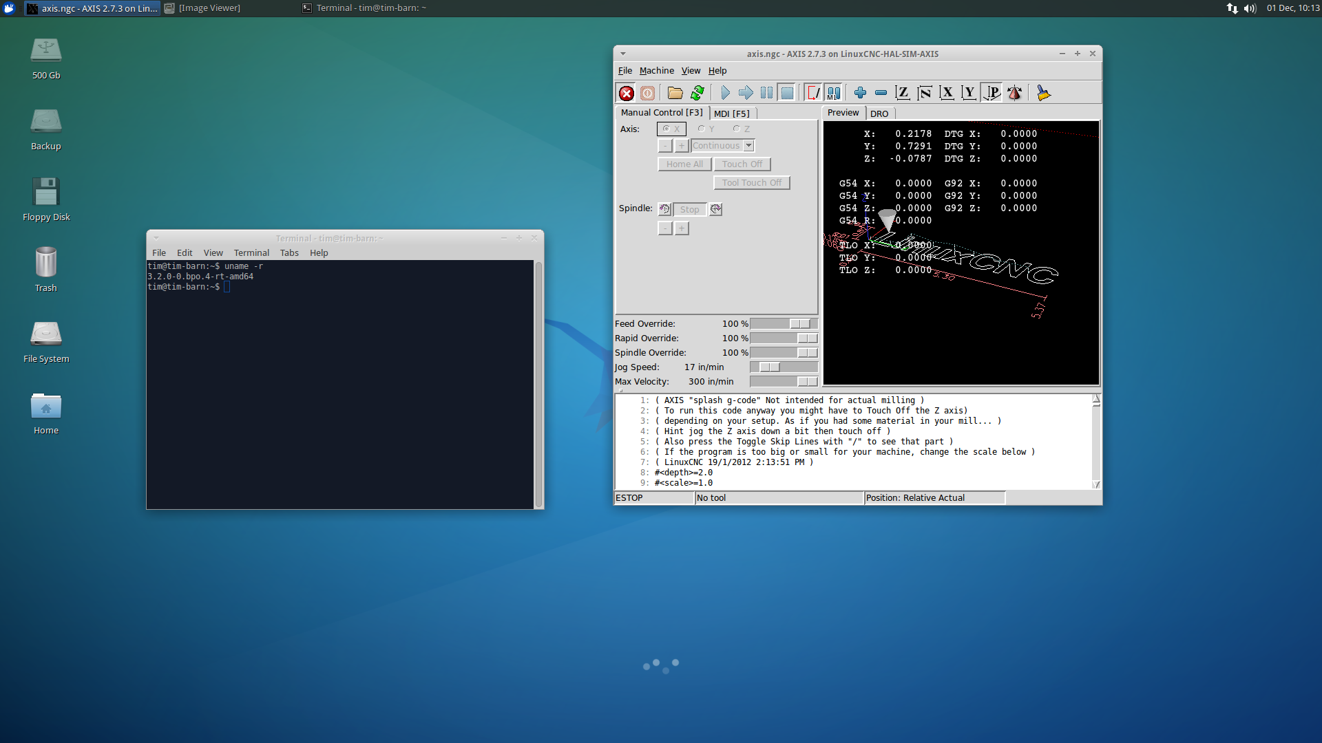

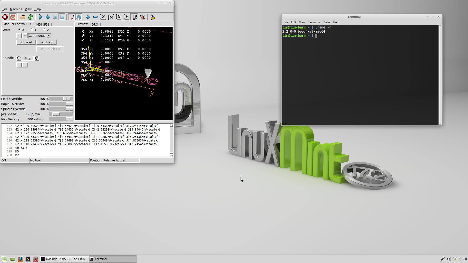

01 Dec 2015 09:57 - 01 Dec 2015 11:53 #66166
by tjmarch
Replied by tjmarch on topic ubuntu 14.04.1 linuxcnc help
Last edit: 01 Dec 2015 11:53 by tjmarch.
The following user(s) said Thank You: jtc, Razor_keen
