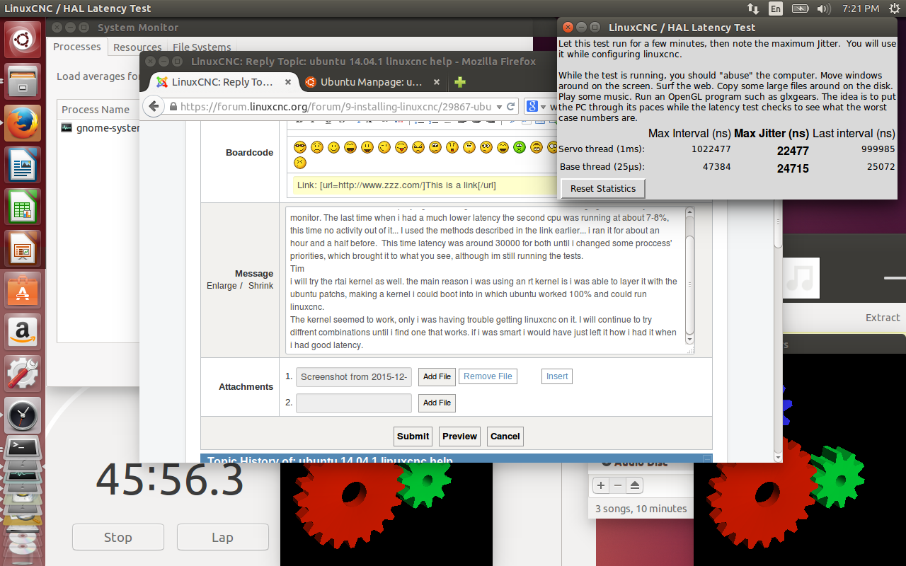

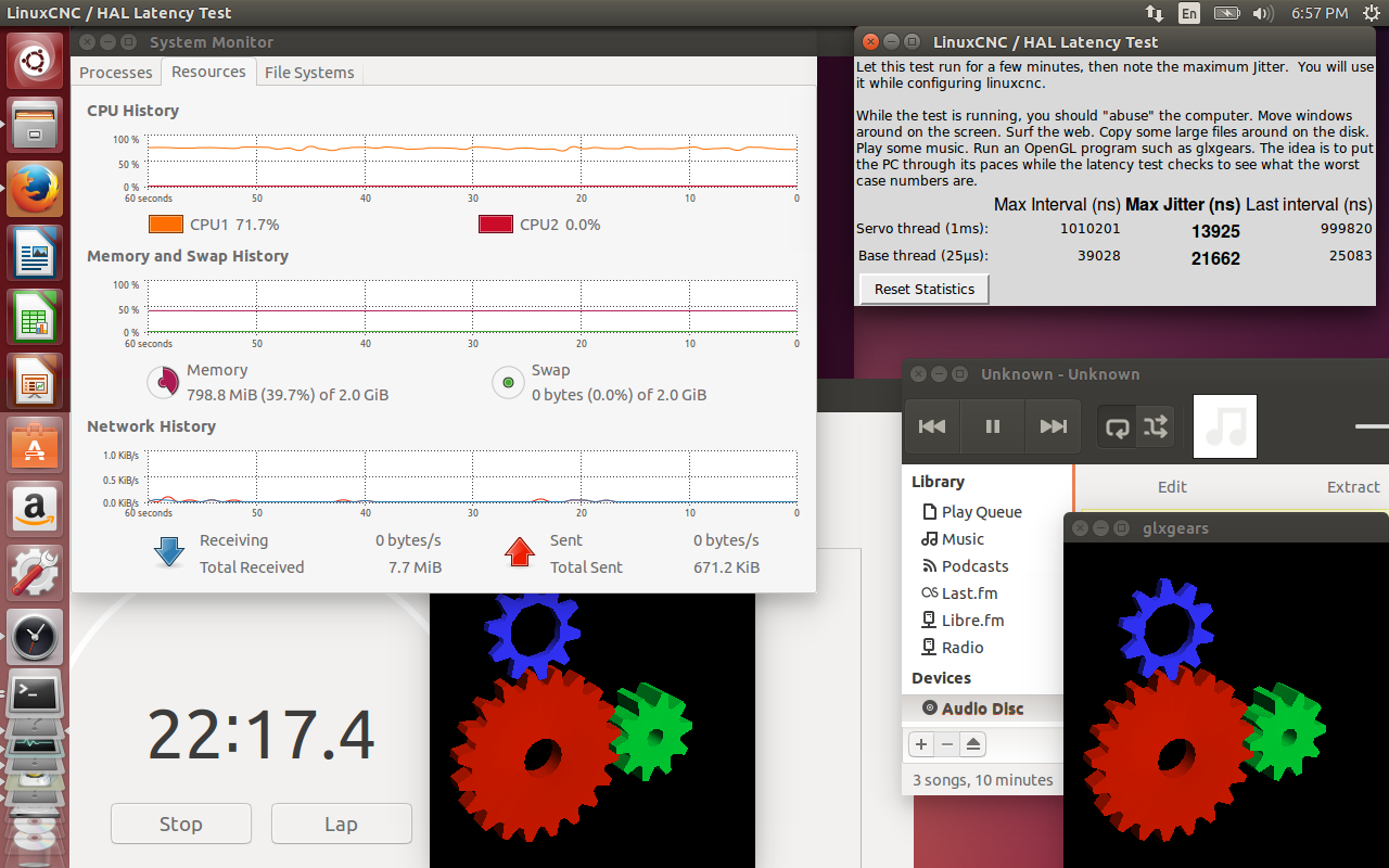

06 Dec 2015 19:24 #66535
by Razor_keen
Replied by Razor_keen on topic ubuntu 14.04.1 linuxcnc help
Ok i found i made a typo in grub, and i had not removed irqbalance. this is using isoclpus in 64 bit ubuntu 14.04. I have music playing, searching the web, several instances of glxgears, and system monitor. The last time when i had a much lower latency the second cpu was running at about 7-8%, this time no activity out of it... I used the methods described in the link earlier... i ran it for about an hour and a half before. This time latency was around 30000 for both until i changed some proccess' priorities, which brought it to what you see, although im still running the tests.
Tim
i will try the rtai kernel as well. the main reason i was using an rt kernel is i was able to layer it with the ubuntu patchs, making a kernel i could boot into in which ubuntu worked 100% and could run linuxcnc.
The kernel seemed to work, only i was having trouble getting linuxcnc on it. I will continue to try diffrent combinations until i find one that works. if i was smart i would have just left it how i had it when i had good latency.
Maybe it would be possibly to replicate the things i did on the rtai kernel, but it would be nice to figure out what worked so well the first time around, then if its like you say, I can get even better latency than i had...
Tim

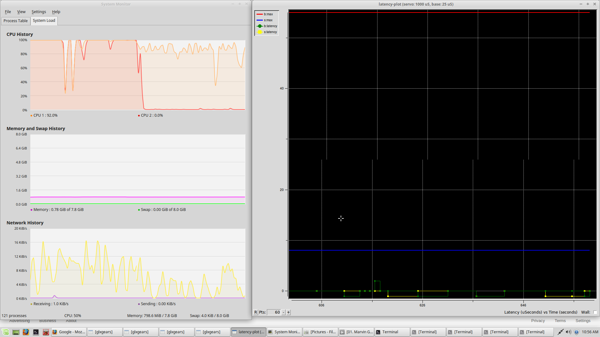

06 Dec 2015 19:54 - 06 Dec 2015 19:57 #66536
by tjmarch
Replied by tjmarch on topic ubuntu 14.04.1 linuxcnc help
Jason
Try LinuxCNC then Configuration Selector->apps->latency-plot instead of straight Latency-test. It is latency test but with plot graph so you can see what is causing latency problems while you are misusing system, (glxgears, internet, playing music, moving files ..ect)
Tim
PS you might find you only spike when program starts after that it settles down consistently.
Tim

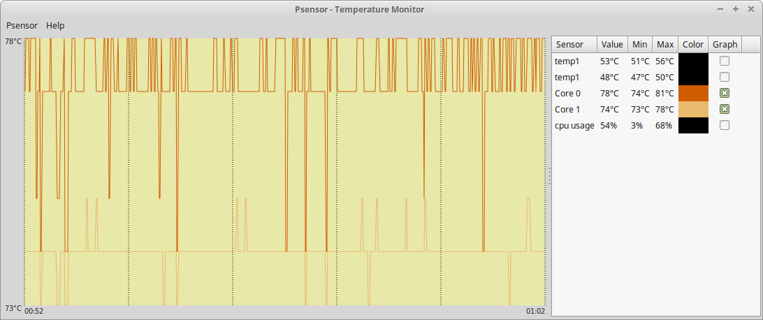

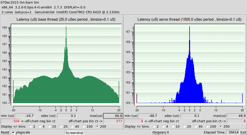

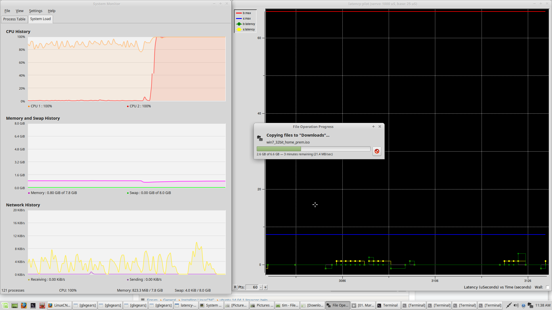

07 Dec 2015 11:27 - 08 Dec 2015 04:05 #66562
by tjmarch
Jason
Running LinuxMint xfce 64bit with Rt-preempt kernel
Setup as in post:
forum.linuxcnc.org/forum/9-installing-li...-help?start=80#66528
This is with grub parameters:
quiet splash lapic noxsave -original paramters- intel_idle.max_cstate=0 processor.max_cstate=0 isolcpus=1 acpi_irq_nobalance noirqbalance
When first starting latancy plot I get a spike that is the red b.max in screenshot pic of latancy plot. I took screen shots just as large file write started and finished. As you can see while transfer was taking place CPU usage was 100% for both CPU's after transfer CPU1 is still carrying quit a load CPU2 load dropped to 0%. Latency stayed low during test, (below 10000us) this was done with 4 instances of glxgears, Firefox open on wired connection, music playing in repeat mode, file manager open with large file write, (6.6GB) to hard drive. From what I have read this is the behavior that is correct maybe someone else can pipe in if I am incorrect. I will let latancy histogram run the rest of the day while I am at work and add screen shot when I get home to this post.
Learned something just before walking out the door for work. Was using Totem media player for music it had failed with streaming error and no sound. Closed Totem and used VLC media instead then reset Histogram. When resetting histogram latency spike due to reset was only 15000us which original spike when starting Histogram program was 67000us.
Been about 11 hours of run time included screen shot of histogram and psensor which is set to monitor CPU temp.
Max of 66800us over a 11 hour period CPU0 around 80C CPU1 about 74C
That was holding CPU0 at over 90% load for a long time
Sound had also stopped again no error on screen VLC play was still running music
If someone could chime in and explain histogram
off-chart pos bin ct
