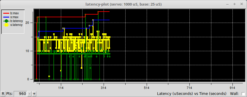

Are you using software stepgen?
If not, you do not need to go down so low on latency. It seems everyone is trying to get such a very low latency that it distracts from the fact that unless you are using software stepgen you do not need to worry so much about latency, within reason of course. Also, from my research it seems that software stepgen is fairly stable with higher latency than you reported.
just my 2Cents
I'm around 15-30 if I use every method of reducing my latency, however my computer slows to a crawl. So i decided not to worry so much about latency of my PC. I'm pretty stable around 45-50 with occasional spikes, but I'm using MESA hardware and I'm not concerned with it.

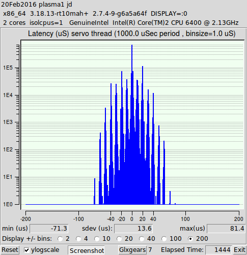

I have install LDME 2 64 bit OS on my Dell SFF Optiplex 745 box. Using the ISO I installed LCNC and the Preempt-RT kernel. Everything seems to work but the latency seems quite high. Please see attached image. I tried to use the tricks shown in this post www.forum.linuxcnc.org/forum/9-installin...mde-2?start=10#69182 but couldn't get the sim control to install. I am very new to using Linux and don't really know what I am doing.
Here is the results of lspci if it helps:
I want to use this box with a Mesa 7i76E if possible, is the latency too high? Any suggestions before I start looking around for another box?
John

You only ran latency-histogram for 24 min not long enough to tell anything. Latency plot did not look to bad. You need to invest some time and read the included documentation that was installed. The best way to learn is to do a little resurch then when you do not understand something ask. I have given you a great start with the ISO but you have to attempt to help yourself. What trouble did you have with post on lowering latency there is nothing about sim control. Did you mean something else like
SMI control.

Replied by PCW on topic ISO install of LinuxCNC on Debian 8 & Mint LMDE 2
That latency is probably OK but note that the Broadcom Ethernet is probably not
usable for the real time Ethernet connection (Intel and Realtek are known to be OK)

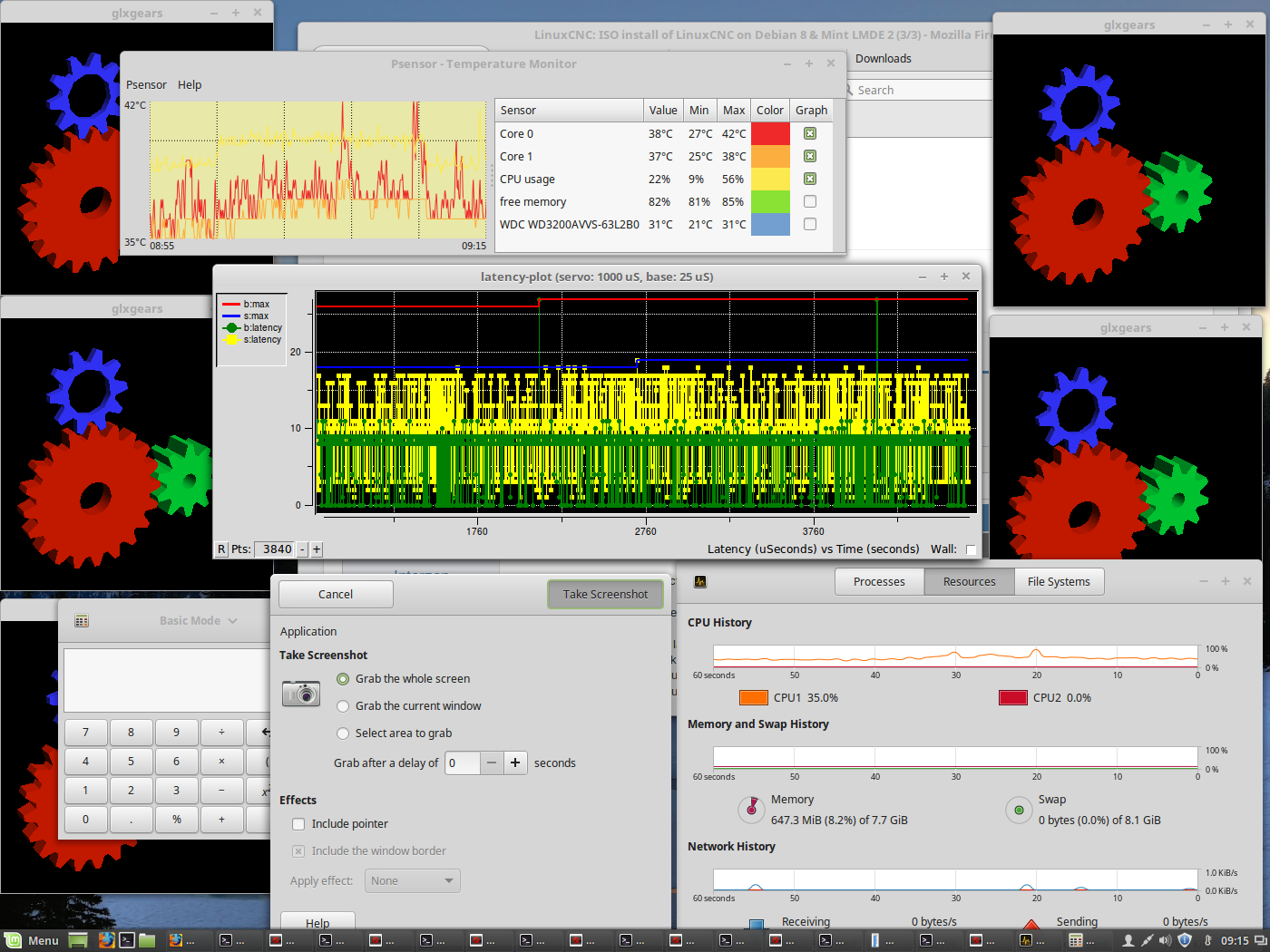

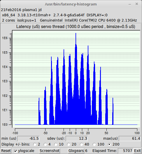

I have gone back and did a fair amount of testing with little improvement to show for it. I was successful in getting the SMI control software installed and run. I also experimented with using isolcpus again with little change in latency. I then installed a video card so the onboard video wasn't being used again with little change in latency.
The one think that stood out is that when using smictrl as instructed when I shut down the machine using the menu button the power does not shut off, I have to manually push the power button on the box after the black Linux Mint splash screen pops up.
I understand that I need to use an Intel or Realtek chip base NIC for real time control of a Mesa 7i76E card. Is there a preferred chip series to use or avoid?
John

Isolcpus is typically a bad idea with Preempt-RT and hm2-eth (it just slows everything down)
You can probably get some improvement by using a core 2 DUO with more cache
(a E8500 has 3x the cache size of your E6400 and is about $15.00 on ebay)
Cache size makes a big difference (how much of the real time stuff stays in cache has a big effect on latency)
All this said, unless you dont meet the 1 ms thread time deadline (and so get real time errors)
the latency is pretty much immaterial
Much too much time is wasted improving latency for no real benefit, especially if you dont need software step generation
