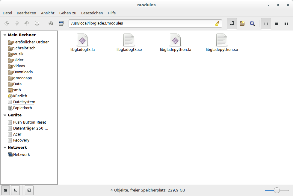

I had graphics issues with Jessie LMDE 2. [GPU Hang] So i decided to swap for mint 17.3 and used this launchpad.net/ubuntu/+source/glade-3/3.8...untu1/+build/6314985 to install galde. Its working for me quite well.
