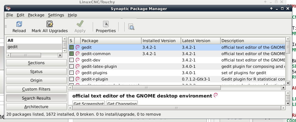

- Posts: 19904
06 Jun 2016 15:43 #75586
Replied by andypugh on topic replacement of GEDIT with Mousepad
- BigJohnT
- Posts: 3981
- Thank you received: 994
06 Jun 2016 18:24 - 11 Jun 2016 06:09 #75599
by BigJohnT
Replied by BigJohnT on topic replacement of GEDIT with Mousepad
To install gedit in a terminal do:
Hmm, that may only work on Ubuntu based distros like LinuxMint...
Or do like Andy said and open the Synaptic Package Manager and type gedit in the search box.
Edit: fix typo in command
JT
sudo apt-get install -y gedit/trusty gedit-common/trusty gedit-plugins/trustyHmm, that may only work on Ubuntu based distros like LinuxMint...
JT
