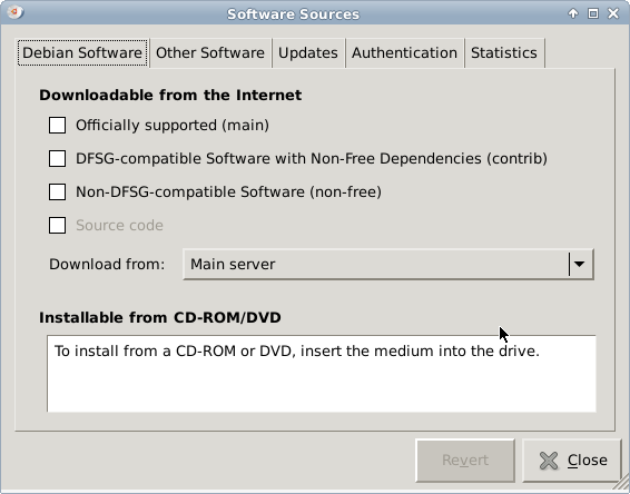

11 Jun 2016 04:41 - 11 Jun 2016 04:43 #75807 by RotarySMP
Replied by RotarySMP on topic replacement of GEDIT with Mousepad
Is this the problem? See attachment... Under repositories, nothing is selected. If I select Debian software, "officially supported - Main" the tick disappears after a second.
What do need to change to get access to the Debian repository?
Mark

11 Jun 2016 04:44 #75809 by andypugh
Replied by andypugh on topic replacement of GEDIT with Mousepad
sudo: apt: command not found
The command is apt-get
sudo apt-get install …..
11 Jun 2016 06:11 #75812 by BigJohnT
Replied by BigJohnT on topic replacement of GEDIT with Mousepad
Hi BJT,
I tried that, but it also gives an error:
boley@Boley-4LV:~$ sudo apt install -y gedit/trusty gedit-common/trusty gedit-plugins/trusty
[sudo] password for boley:
Sorry a typo in my notes the correct command as Andy pointed out is apt-get
sudo apt-get install -y gedit/trusty gedit-common/trusty gedit-plugins/trusty
JT
11 Jun 2016 07:49 - 11 Jun 2016 08:06 #75817 by BigJohnT
I've installed Debian Wheezy on a drive and I'm taking notes how to solve most issues like this and will post them when I'm done.
Edit: You must be fully updated before you can install gedit. I updated and waited a few then had to update again.
In a terminal
sudo apt-get update
sudo apt-get install gedit
JT
