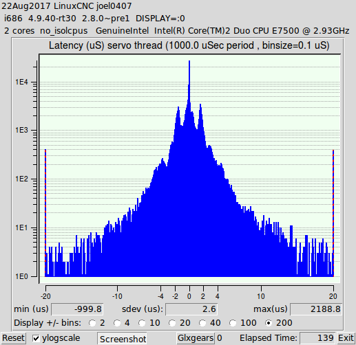

Success. Finally got it. Down side is my Latency jumps to over 2 million. When I reset. it sits around 13,000 and 15,000 for 1ms and 25us but then creeps up. Working on it.

Run Stpeconf then confirmed LinuxCNC runs fine. Just got the latency problem. I highly doubt it can jump this much just from the later OS. give I was at 4,000 - 12,000 with the Wheezy ISO install.
