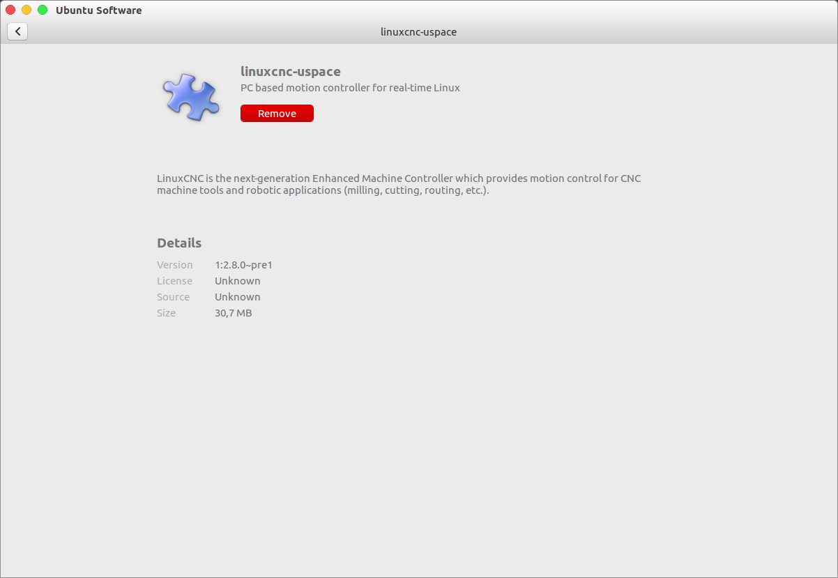

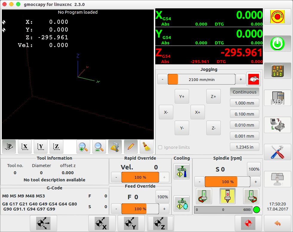

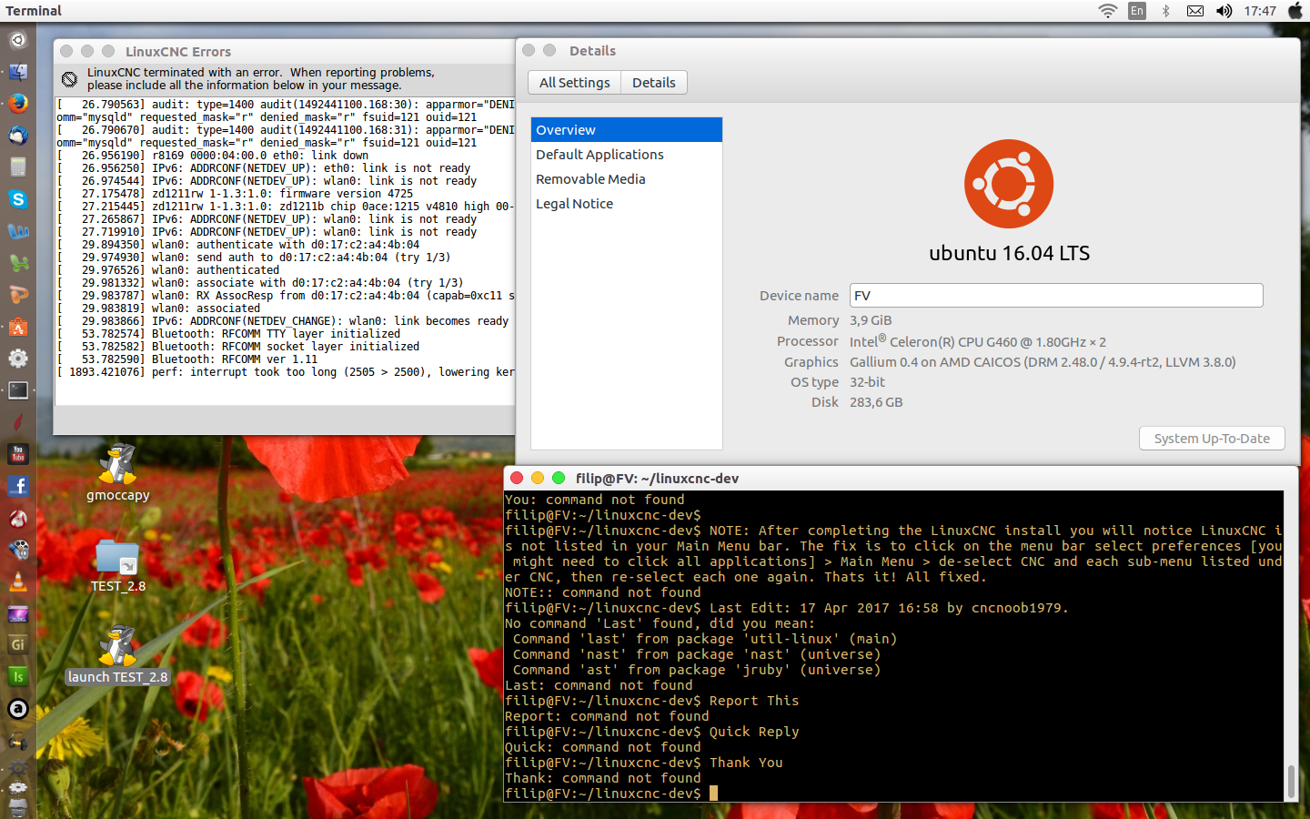

17 Apr 2017 11:03 #91516
by probamo
Replied by probamo on topic Complete HOW-TO Linux Mint 18.1 32/64 RTAI or PREEMPT with RIP install or deb
Really not know what to say
Thank you for guidance, I managed to install 2.8.0~pre in Ubuntu 16.04 (see attachments), using POST 2 instructions. The only what was missing from dependencies was "autoconf" which I added later on.
By using stepconf I created TEST file, starting running, there was an error window for what I need support from your side. Beside this, in sim started with gmoccapy I was not able to "home" Z axis.
Another thing is, looking at the stepconf file for XYZ mill machine (cannot find XXYZ), how to home axis driven by two motors (let say, X axis is driven by two motors - each motor at the either side of the table) in order gentry to be squared. Which limit switches shall be employed once the home all command is in place?
Once again thanks a lot for awesome instructions.
