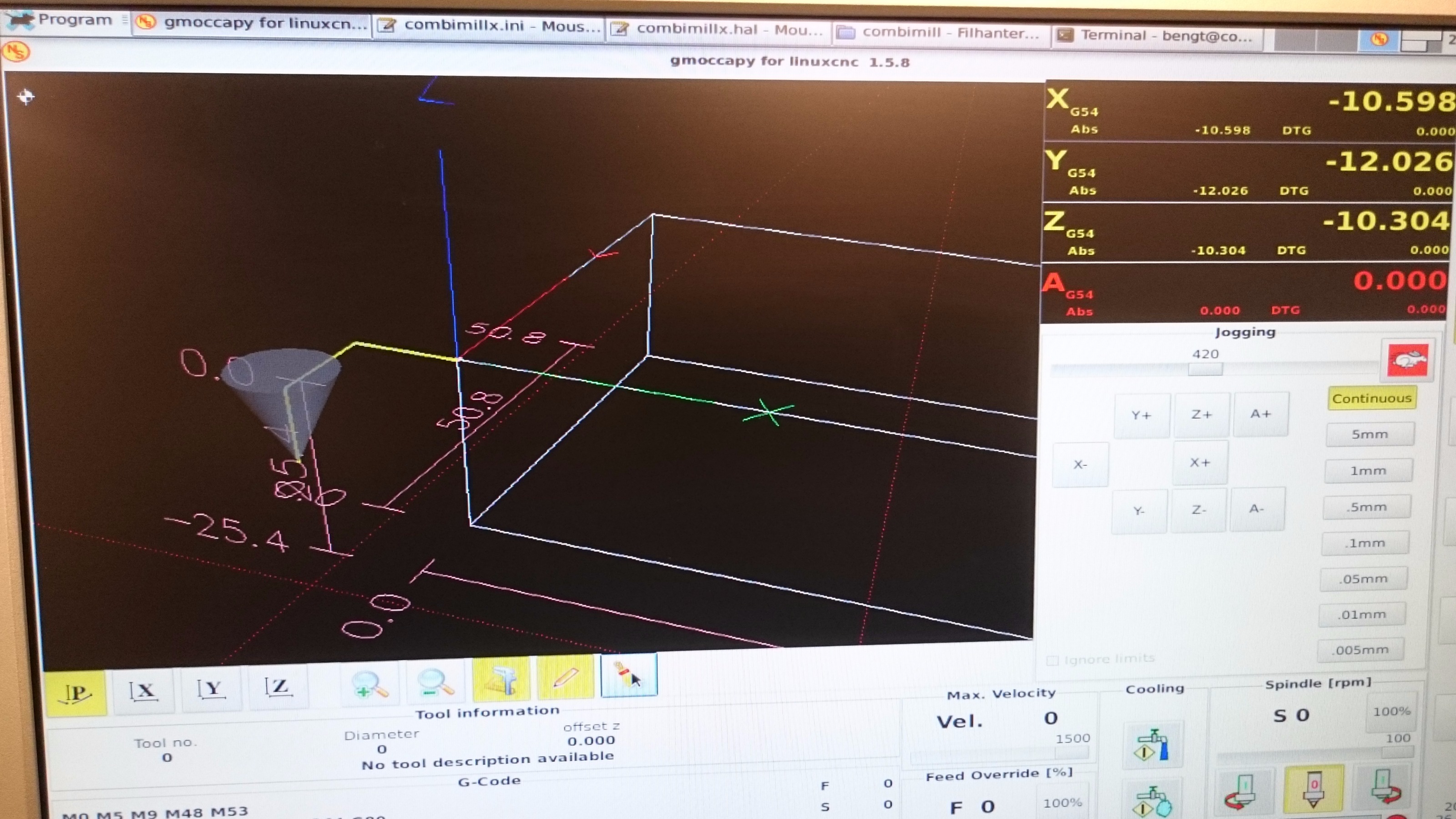

Can somebody please help me as I can not wrap my head around this what is wrong here.
1. Homeing sequence is OK. Home position is left back for X/Y and Z knee down
2. Only Z is moving correctly, PgDn is moving in minus direction
3. X/Y are moving in opposite direction

Oops I'm sorry. If the axis are jogging in the wrong direction, then the direction of the motors needs to be reversed. Once that is corrected you will also find that you need to reverse the homing directions.
Ok to change the direction of movement. There are a lot of ways to change the direction of a stepper machine, here are a few.
You could just change the sign of the STEP_SCALE
In you hal file you could invert the dir pin.
You could just change the wiring to the motor.
I know you have been working on a stepper config with encoder feedback. Is this the machine? Is the encoder directions correc?
That adds another wrinkle to getting the directions right.
Also don't forget that with moving table format machines the direction of movement is opposite of the jog key arrows.
When you push the right arrow button the table should move to the left. The jog keys are tool centric, such that pressing the right arrow should move the tool to the right side of the table, moving the table to the left. (it is amazing how many people get this wrong.)

Yes this the same milling machine, it looks like the encoders are working.
For me the tool has to move in arrow key direction and only Z acts correctly now. Will do some edits tomorrow and hopefully I get this working properly.

27 Sep 2017 01:13 #99504
by tecno
Replied by tecno on topic Arrows keys -> spindle in wrong direction
DRO shows correct.
I am not sure if I am actually running Closed Loop yet, it has been so many things to get functional.

I did change Step_Scale and homing settings and now have tool movement as arrow keys point.
So now maybe we can have a look at closing the loop and connect encoders to PID?
