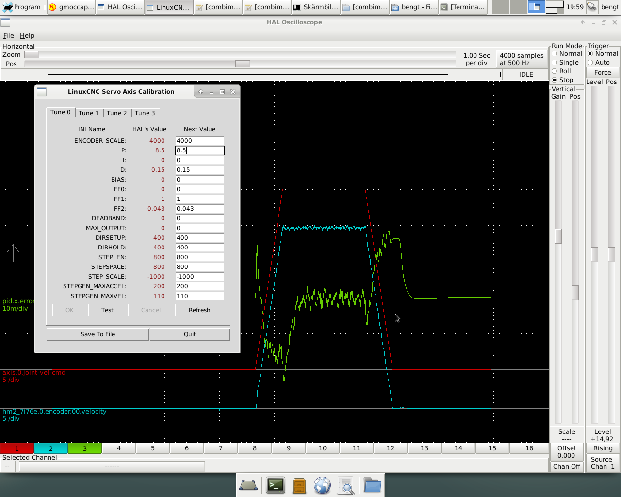

So here the result.
PID 7 shoots over few tenths/mm and rocks back and forth +-1µm for a while like 5sor more until it gets stabilized.
What do you suggest to do now, edit Y and Z to get similar results?
Had to change encoder scaling from 1000 to 4000 to get correct travel.

27 Sep 2017 12:56 #99524
Replied by Todd Zuercher on topic Arrows keys -> spindle in wrong direction
If you are happy with the results leave it.
It is hard (impossible) to make any suggestions for tuning without seeing what the halscope plot looks like.
I often like to set the deadband for the PID loop I'm tuning to somewhere between 1 and 1.5 encoder counts (something like 0.0003 for this axis.)
Maybe adding a small amount of D can reduce the overshoot and the oscillations? (Won't know unless you try
Remember the PID constants don't have to be whole numbers they are floats.

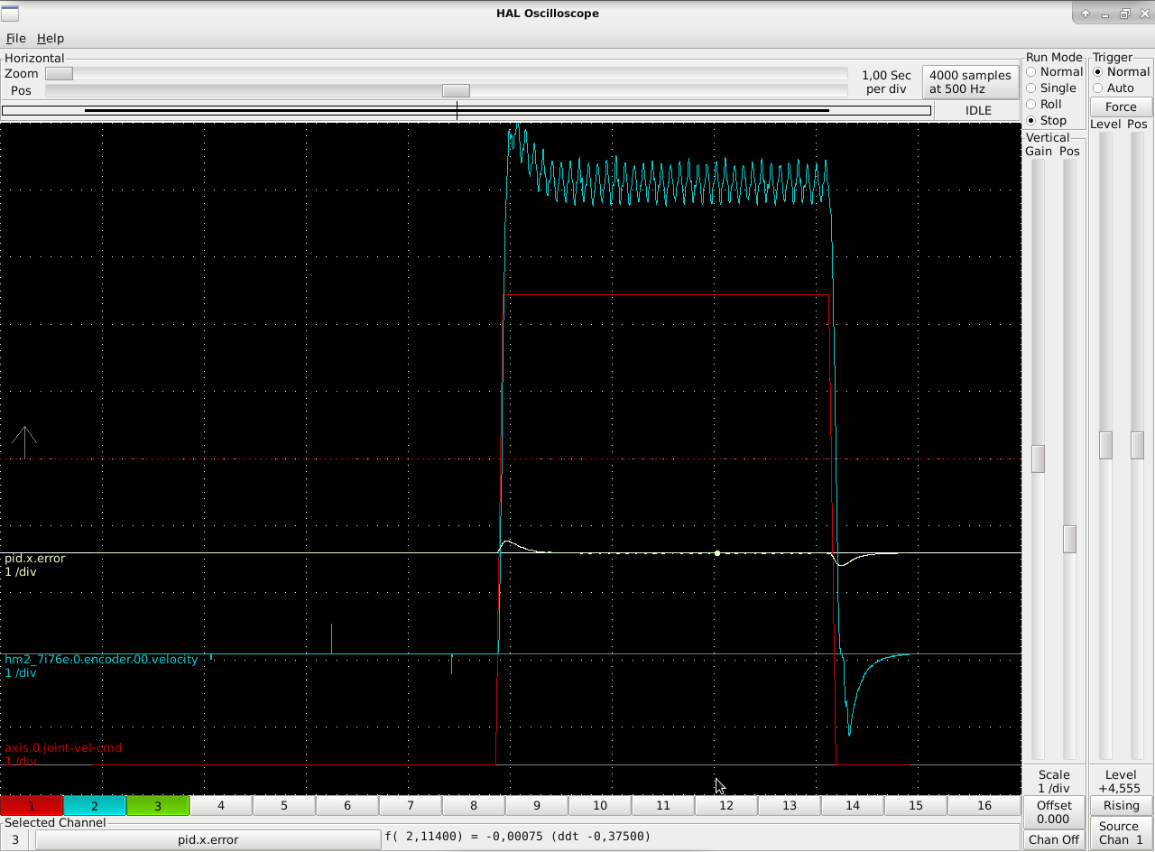

28 Sep 2017 08:17 #99547
by tecno
Replied by tecno on topic Arrows keys -> spindle in wrong direction
Need help what to look at with Halscope, please and how to start this. halcmd halscope?

28 Sep 2017 09:13 #99550
You can start it from the command line with:
Or you can open it from within your machines UI. You are using Gmoccapy, and there is a button for opening Halscope at the bottom of the maintenance page.
Also at the bottom of that page is a button that opens a Calibration screen where you can make adjustments to your PID settings on the fly while you are tuning.
When you open Halscope for the first time you will be prompted to choose a thread to sample with, set a sampling period (multiple of the sampling thread), and choose a recording length. (The default settings should be fine.)
The numbered buttons at the bottom of the screen select the channels and set the hal pins they monitor. You will want to look at the pins axis.N.joint-vel-cmd, hm2_7i76e.0.encoder.NN.velocity, and pid.N.error. I usually like to set the trigger for Halscope on the velocity command signal. Then I'll do some incremental jogs at a moderate speed and look at the traces.
The idea here when you are tuning is to try to get the velocity feedback to match the velocity command and make the following error as close to zero as possible. If your drives are tuned well you should be able to get it with in +/- a few encoder counts, when stopped and moving slowly and 10-20 at faster speeds.

28 Sep 2017 09:51 #99554
by tecno

28 Sep 2017 10:17 - 28 Sep 2017 10:18 #99557
A small amount of FF2 may improve the the error during acceleration. (Be careful a little bit goes a long way.)
More D to try to reduce the overshoot some more.
Increase the vertical gain on the error, so we can better see what is going on there.
Probably will need more P, (I have a feeling that the instability during cruse isn't because of too much P)
But only make one adjustment at a time,
Last edit: 28 Sep 2017 10:18 by Todd Zuercher.
