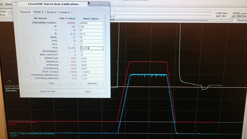

Looks like a little too much FF2.
How much P can you add before it becomes unstable?

OK, will have to play more tomorrow.
I do not know how much P I can do, will let you know tomorrow.
Is the PID error optimal as a horisontal line? Or same wave form as the 2 other pins?

A flat line of 0 is perfection (you'll never get there though)

More P.
PS
I am a little surprised that the P for your X would be less than 10. On my closed loop step/dir servo I have P between 200-500.
PS

This behavior (creeping an end of move) is often the result of pncconfs default PID
maxerror setting which is OK for inch machines but not for mm
Set it to 0 or .01
Set it to 0 or .01

Hmmm, what line in INI is that PID maxerror?

# AXIS X
setp pid.x.Pgain [AXIS_0]P
setp pid.x.Igain [AXIS_0]I
setp pid.x.Dgain [AXIS_0]D
setp pid.x.bias [AXIS_0]BIAS
setp pid.x.FF0 [AXIS_0]FF0
setp pid.x.FF1 [AXIS_0]FF1
setp pid.x.FF2 [AXIS_0]FF2
setp pid.x.deadband [AXIS_0]DEADBAND
setp pid.x.maxoutput [AXIS_0]MAX_OUTPUT
setp pid.x.error-previous-target true
setp pid.x.maxerror .0005 >>>>>>>>>>>>>>>>>>>>>>>>>>>>>>> change this value to 0 or 0.1 ??

i thought I suggested commenting that line out further up the pipe.

It is removed as per your suggestion, so many lines/parameters makes ones head spin around.
