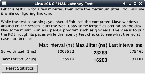

I'll try that. The new computer has more than half values in Latency test than the old that had no probs. Is this a new thing i ver 2.7 ?

Hi Todd
Yes, I'd ran the Latency-test with som other programs - not for a long time, but tried to prowoke the processor.
The Max jitter was 24.000 on the servo and 17-18.000 on the base, but I don't know where to put those informations in the setup-files....How du I get LinuxCnc to reconize those info's
Sincerly
Steen

While the latency test is running start 1 or two instances of glxgears (from a command prompt type glxgears<enter>)
Then let the latency test run for several hours, leave it unattended, so it may try to sleep, screensavers activate...
If you run the latency-histogram instead, it gives you a simple button to start Glxgears, and also gives you some feedback on your system settigns (Kernel version, CPU info, if ISOLCPUS is running, and how many cores are isolated)
The relevant places in your config where the Max Jitter numbers would be relevant, would be for calculating the shortest base thread period you can use.
What is the base thread period you have entered in your ini file?

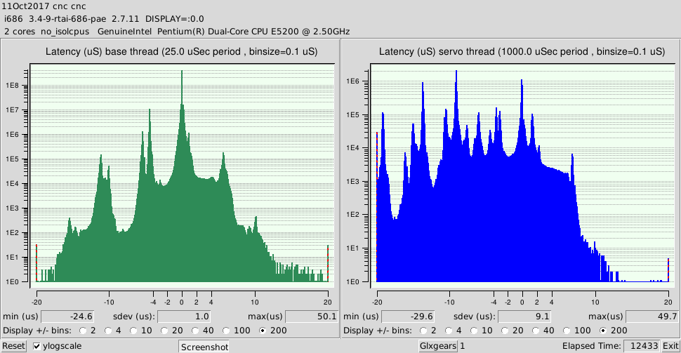

- Stonefire
- Posts: 48
11 Oct 2017 13:12 - 11 Oct 2017 13:13 #100221
by Stonefire
Replied by Stonefire on topic Moving setup-files to another computer
Last edit: 11 Oct 2017 13:13 by Stonefire.
- Todd Zuercher
- Posts: 4794
- Thank you received: 1482
11 Oct 2017 13:44 #100224
Replied by Todd Zuercher on topic Moving setup-files to another computer
Probably should work at trying to improve the latency.
An Intel E5200, that is a lot older CPU than I expected to see when you said you were setting up a new system.
Do you have a graphics card in it? What is it? Have you disabled all power-saving features in the BIOS?
It may be beneficial to set ISOLCPUS=1.
