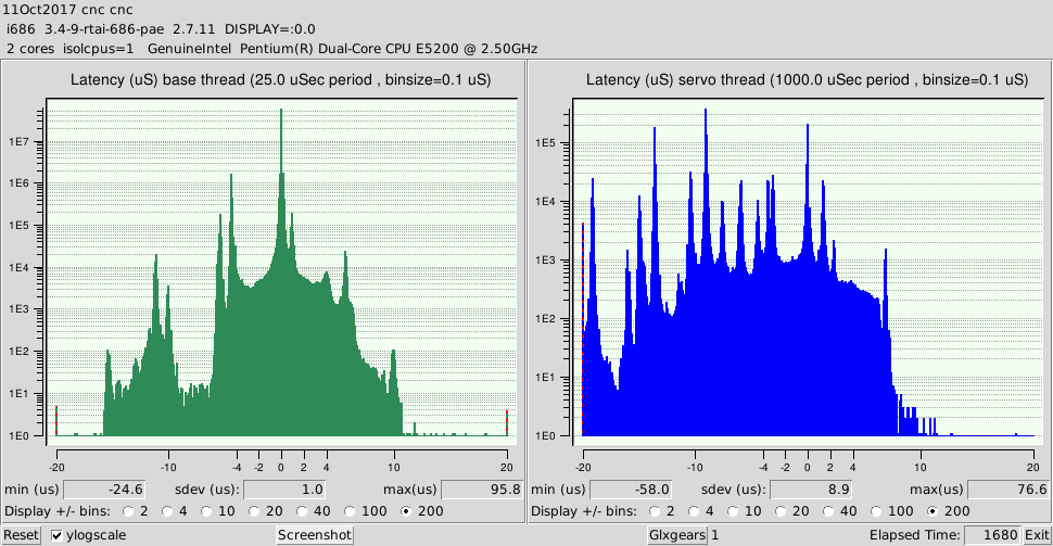

Hi Todd
It's newer than the old
I use the onboard graphic-card.
I'll look at the bios...
ISOLCPUS=1 ?
In the [emcmot]-section ?
Otherwice is to find a faster computer ...
Sincerly
Steen
ISOLCPUS=1 ?
Sincerly
Steen

ISOLCPUS is a boot parameter, and needs to be worked into one of the Grub boot settings. I set it up so infrequently I can never remember exactly the best way to get it done.
It may also be beneficial to add a graphics card, but one change at a time.
That computer should be able to work fine once you find the right combination of settings for it.

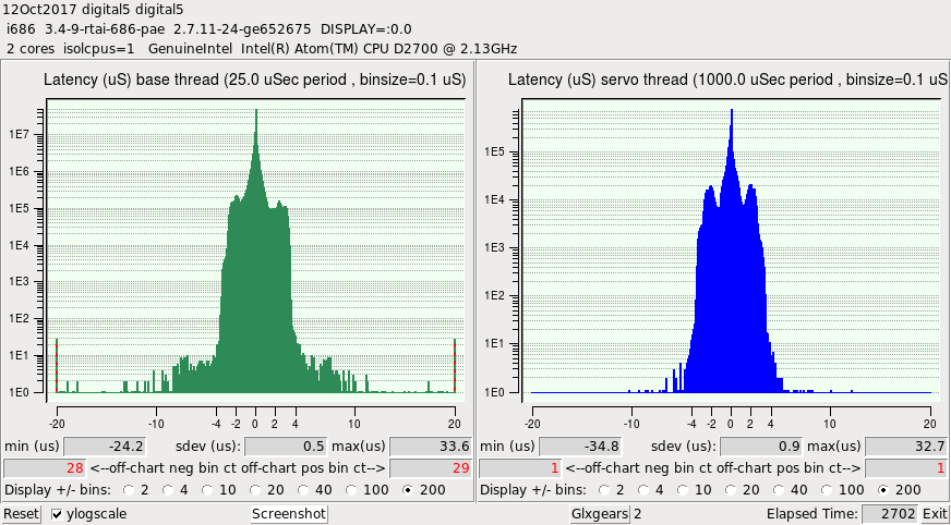

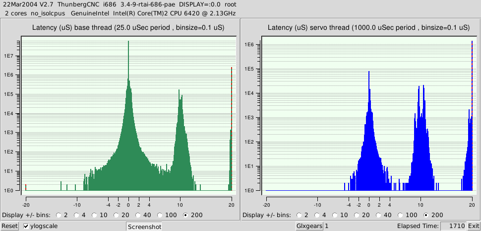

Hi Todd
Need your opinion. This is a screenshot of latency-histogram on my oldest computer with Linuxcnc 2.6 - running ok, but in a LARGE cabinet:
Is the performace better ? It seems that the histogram is concentrated in 3 peaks(blue)
The reason I was switching the computer was mainly the size. The "new" one is only a 10'th of the old.......
Sincerly
Sincerly

Unfortunately there's no way to tell the maximum latency on the last plots
(the older version of the latency-histogram did not have this information)
so to compare, you would have to run the latency-test on the older machine
Note that you may be able to improve performance somewhat with a faster CPU
(a E8500 CPU will fit your socket and these are around $10 on Ebay)
www.ebay.com/itm/Intel-Core-2-Duo-E8500-...0:g:~Z0AAOSw32lYoi6O

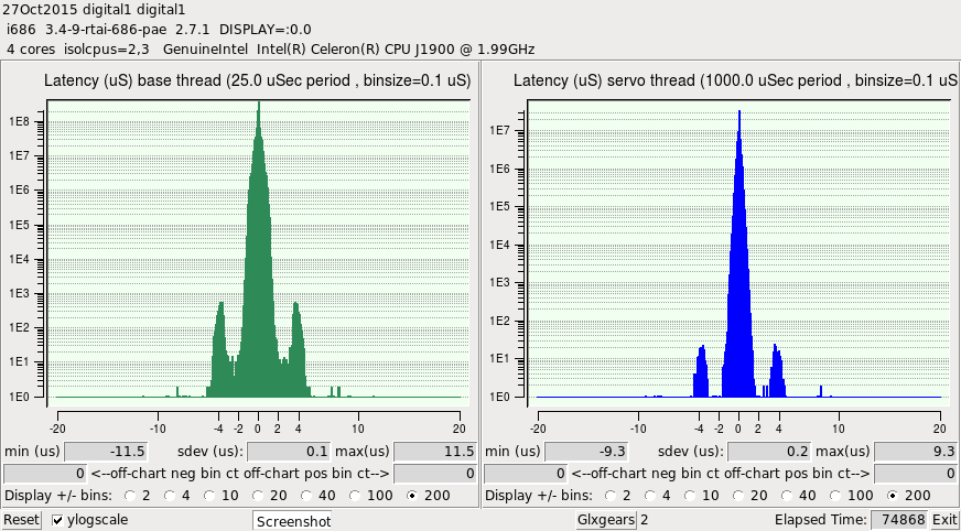

It is a little hard to see how much better it may be, but it still isn't great. (for some reason that screen show doesn't show what the maximum jitter is or how many overruns there are.
By comparison here is a screen shot of the latency-histogram (running for more than 12hours) on computer I'm using for software stepping (parallel port) control. This machine has very good test results
Here is another decent one.
Both of these are relatively inexpensive (less than $70) motherboards with onboard parallel ports and low power CPUs that do not need any fans.
