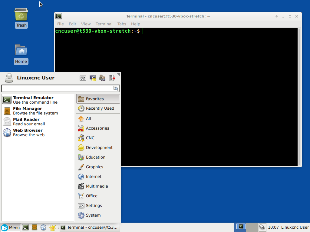

You need to use the rt-preempt kernel.
I feel it might be much easier for you to use the stretch iso, instead of trying to install Mint.
Norbert
Norbert

Live cd & install, you may want to dual boot if you want to use Mint as a Desktop
www.linuxcnc.org/testing-stretch-rtpreem...uspace-amd64-r13.iso
Was the kernel panic anything to do with not being able to find a rootfs ?
You need not have re installed, grub should have an advanced option that lets you boot your existing kernel

Mate has been backported to wheezy, if that is the desktop you like. (You'll need to google for install instructions and don't forgot wheezy is in archive so your apt sources will need updating, it was discussed last week on the forum, a quick search will turn that up.
You can use a USB stick, but if you are using Windows to put the image on the USB stick use win32diskimager. After installation you can install the MATE desktop, google for instructions on that.
Or if you want you can follow these instructions
gnipsel.com/linuxcnc/uspace/debian9-rt.html
And choose the MATE desktop instead of xfce
In reality xfce4 is lighter weight that MATE desktop wise.
In actual fact I use xfce4 with some tweaks to the font and the whisker menu with only one panel and prefer it over MATE for my Linuxcnc install. I rolled my own install disc so this is how it appears after first login, no screen asking about default panels and such.
