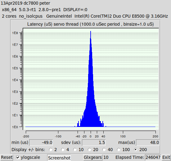

- Posts: 18118
- Thank you received: 5336
15 May 2019 10:15 - 15 May 2019 10:19 #133847
Replied by PCW on topic Latency Tuning Questions
Another thing that helps noticeably with Preempt-RT is CPU speed and cache size.
If you replace the E2180 with a E8500 you get about double the performance and
3 times the cache size (for about 6 bucks on Ebay)...
Edit: Note if you intend to use a Ethernet card you should not have a base thread enabled
in your test as it will give inaccurate results.
Heres a E8500 Core Duo on a HP DC7800, with a current kernel
(3 day test doing normal browsing + GLXGears)
