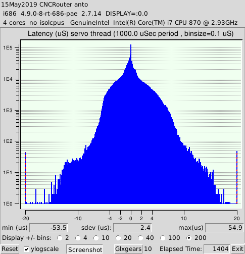

I dropped the HDD in the i7 box and got better and seemingly stable numbers with minor tweaks. servo=19K, base=60K.
I'm running a historgram at this moment, wee see what that shows. I'm think I'll just stick with the i7.
I don't need extreme step rates I'm dealing with a hobby cnc. What are good target numbers to shoot for?

Unless you are running a parallel port configuration, the latency does not directly affect
the step rate. All that is required is that the servo thread can run reliably at a 1 KHz or so rate, With Mesa Ethernet hardware, 10 MHz step rates are possible, completely independent of latency, but a 1 ~KHz reliable servo thread is a must.
This is because with step generator hardware, the actual steps are generated in the interface, not LinuxCNC. All LinuxCNC does is update positions and velocities (step rates) at the servo thread rate.

How does the Linux CNC latency test or the histogram test number relate to servo thread? Is it a 1:1 correlation?
Replied by Project_Hopeless on topic Latency Tuning Questions
So <1,000,000ns on the servo thread, even half that and its 500,000 ns. So I could possibly run my E2180 Core 2 @ ~130-200K ns on a 7i96E? Or is there more to it?Unless you are running a parallel port configuration, the latency does not directly affect

The E2180 may be OK but unfortunately you just have to try, as long as you do not get
real time errors from overrunning the servo thread period, its OK.
The latency test gives a hint of what the system is capable of but it does not test a
significant number of factors that come into play with actual hardware, DMA latency,
network interface latency, cache re-fill latency, hardware locking, etc etc
