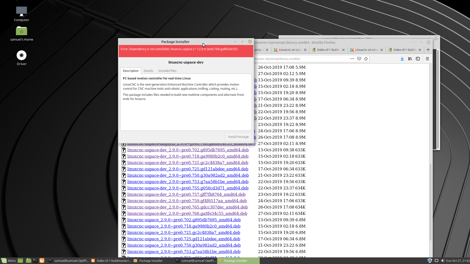

27 Oct 2019 14:45 - 27 Oct 2019 15:03 #148921
by Samuelx
Replied by Samuelx on topic (superseeded) Linuxcnc on Linux Mint 19.3 quick and easy installation
Sorry, got it work, my mistake
clicked wrong packets
/linuxcnc-uspace-dev_2.9.0~pre0.768.ga8fe34c55_amd64.deb
Last edit: 27 Oct 2019 15:03 by Samuelx.
- Posts: 22030
- Thank you received: 7504
27 Oct 2019 15:44 #148929
Replied by tommylight on topic (superseeded) Linuxcnc on Linux Mint 19.3 quick and easy installation
Nice!Sorry, got it work, my mistake
