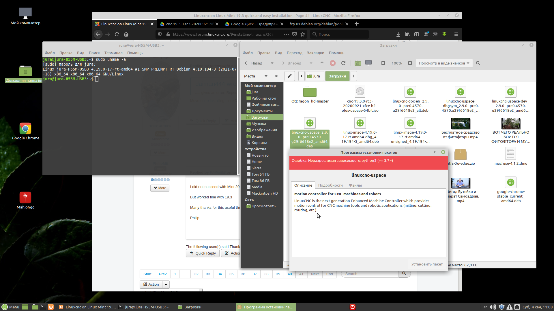

Hello! Installing linuxcnc-uspace_2.9.0~pre0.4570.g29f6618e2_amd64 on Linux Mint 19.3 screenshot error. Please tell me how to fix it?

LinuxCNC moved to Python 3 so this tutorial does not work for now.
Please use the official ISO for now, found here:
www.linuxcnc.org/iso/linuxcnc-2.8.2-buster.iso
