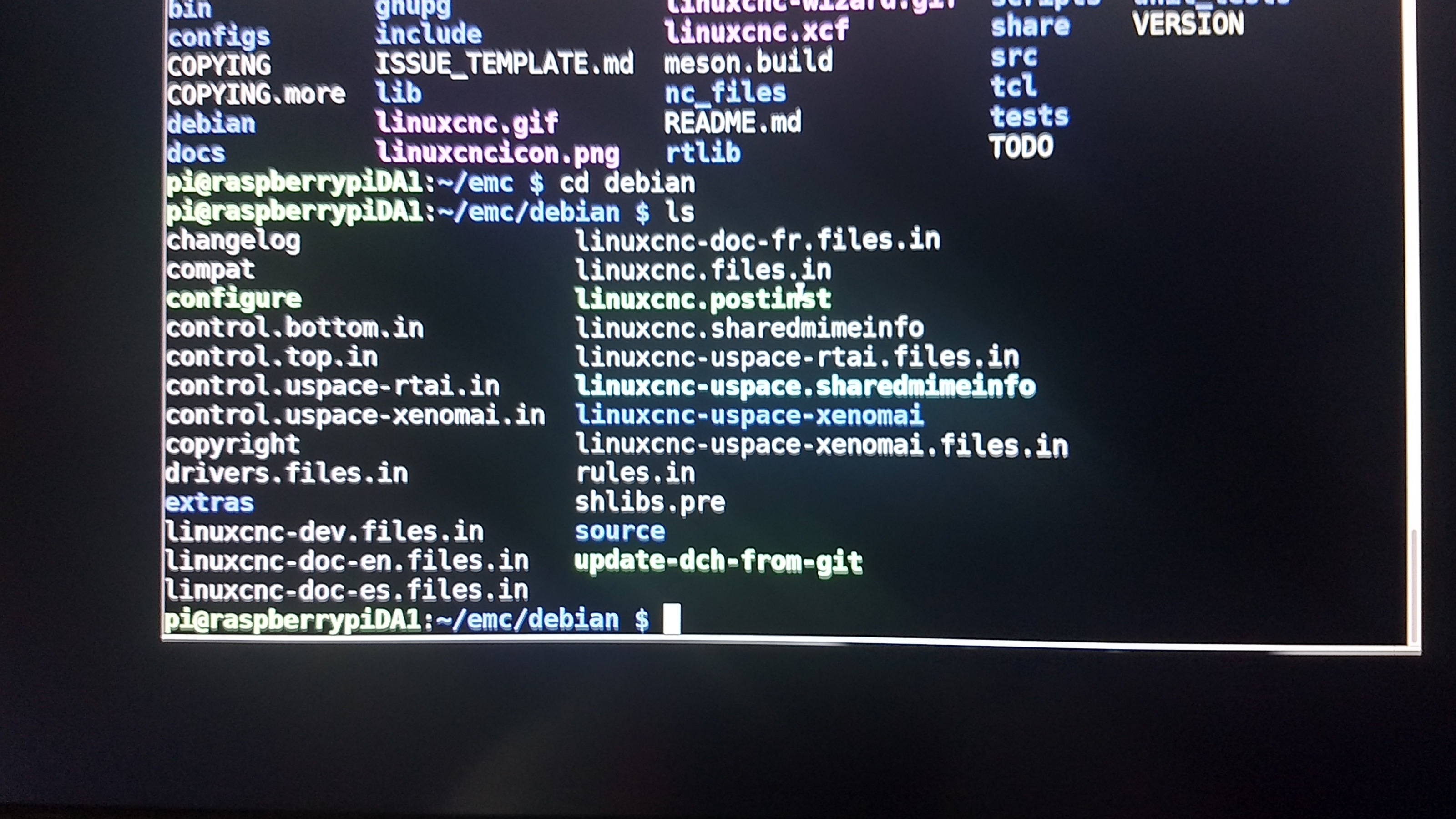

Good evening.
I'm raising an error at the stage where LinuxCNC is installed.
I would greatly appreciate if anyone could help me understand the error and how to proceed.
Command entered:
The following error raised:
dpkg-buildpackage -us -uc -ui failed
Here are more messages leading up to the error:

dh_movefiles: debian/tmp/usr/share/applications/linuxcnc-documentation-es.desktop not found (supposed to put it in linuxcnc-doc-es)
make: *** [debian/rules:83: install] Error 1
dpkg-buildpackage: error: fakeroot debian/rules binary subprocess returned exit status 2
debuild: fatal error at line 1182:

As an update, I managed to get LinuxCNC to install without error. I'm only guessing, because I am new to all this, but this time I used the image of Raspbian Lite to which John has linked in his instructions. In the failed attempt, I used the latest Raspbian Lite version shown on the RPi site.
Just a guess.
Just a guess.

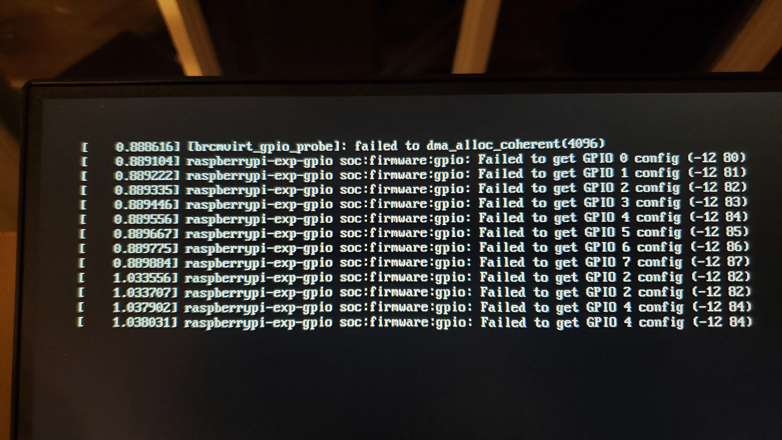

Hey folks,
I'm just starting down the Rpi4 linuxcnc with mesa 7i96E path and so far I'm flopping.
All looked good with John's instructions, except the very last part on the Preempt RT Kernel page. When I rebooted, I got many errors and pi lockup, no SSH.
I've attached an image of what happened when I rebooted after altering the /boot/cmdline.txt
The only thing I can think that I may not have done is added the "-n" to the reboot.
Any thoughts?
I'll add that I also tried the latest .img file on the linuxcnc repository, but I get wrong CPU 0 not supported error. I flashed the micro SD with the latest .img from 9-14.
If anyone has other suggestions, I'm all ears. I'd really love to use the pi4 for this next LinuxCNC build, but I may be suffering an early defeat.

You may want to try the SD Card image from here:
