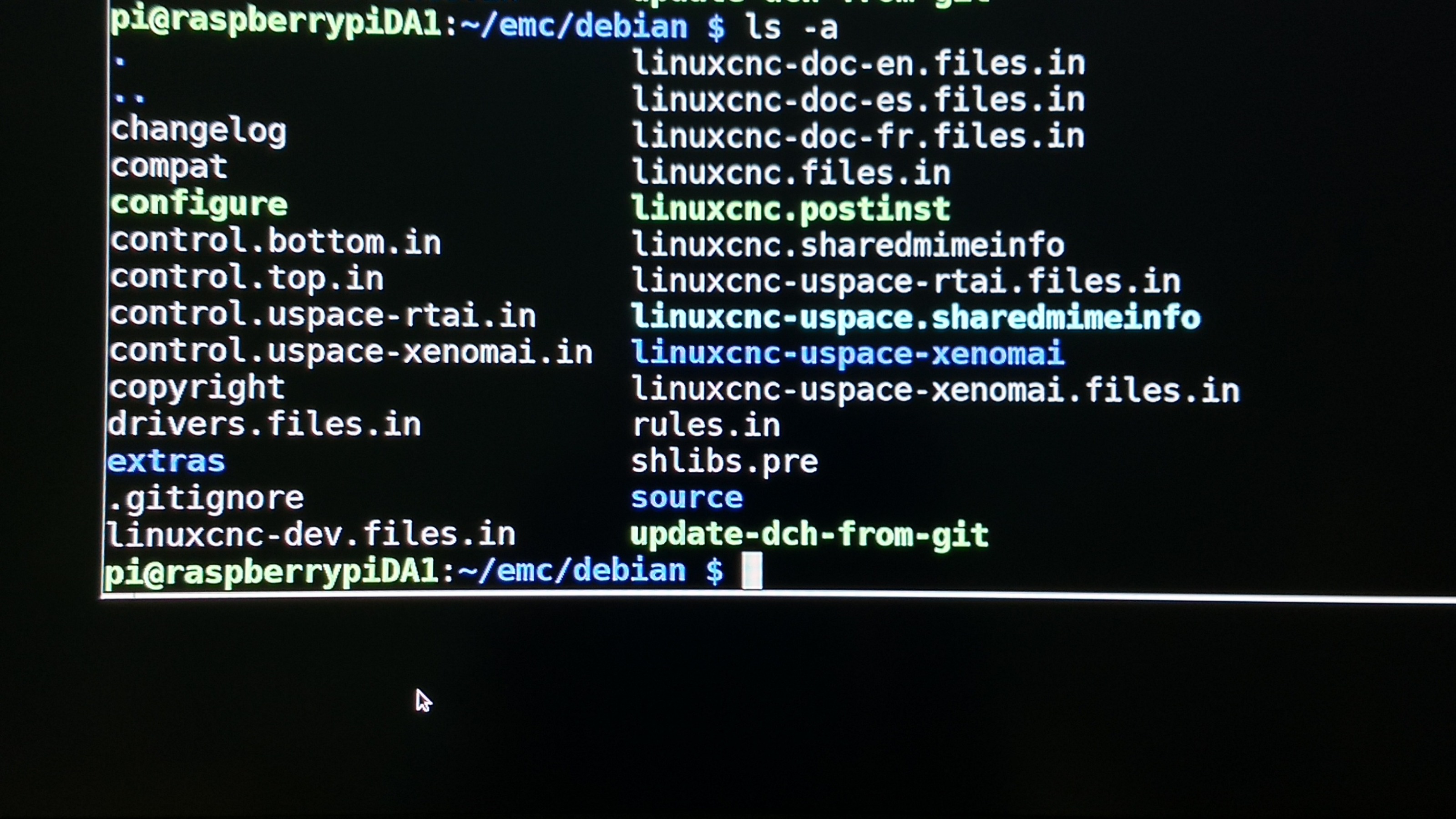

11 Jul 2020 15:24 #174325
by moonco
Replied by moonco on topic Raspberry Pi 4 Tutorial
I was able to get LinuxCNC running. I am not sure if there are any issues yet as the same error occurred.
I just ignored the error and continued this time.
This time i followed the tutorial but replaced the next lines in the tutorial with the files from the buildbot as follows.
I was able to open Linuxcnc after doing this.
dpkg-buildpackage -us -uc -ui failedI just ignored the error and continued this time.
sudo dpkg -i linuxcnc-uspace_2.8.0_pre1.5983.g19a686b67_armhf.deb
sudo dpkg -i llinuxcnc-doc-en_2.8.0_pre1.5983.g19a686b67_all.debI was able to open Linuxcnc after doing this.

- moonco
- Posts: 8
11 Jul 2020 19:57 #174346
by moonco
Here is what was reading out on terminal. Maybe these aren't errors? I am mostly new to linux. I use linux at work but very limited. We build 3d printers and I mostly need to copy, paste, move files from servers onto the computer etc.
Many files couldn't convert with latex. Also dbfatal error at 1182

OK I hope someone can help a novice here. - with my Linuxcnc install per JT.
1. I have the same question at BlueChicago on May 12. I'm at the point where I'm ready to run debian/configure uspace. Using nano debian/configure, I searched and found the two lines to delete (with the python-vte | girl.2-vte-2.91 difference). I removed them, did an exit with save.....
2. the next step debian/configure uspace
leaves me hanging with the following
PACKAGE: command not found
with a few more 'not found' following.
Not smart enough to know if these issues are related. ?????

- rvh
- Posts: 4
12 Aug 2020 05:49 #178018
by rvh
Replied by rvh on topic Raspberry Pi 4 Tutorial
You main the part arround nano debian/configure ?
In my opinion nothing needs to be changed here. (unless I'm wrong)
I just skipped it and continued to the next step (Edit debian/control.bottom.in...)
I didn't got any problems with it and have a running linuxcnc now.
