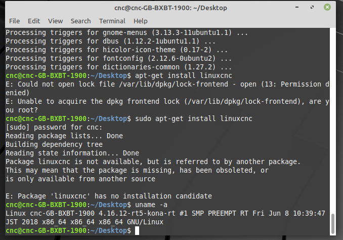

- Clive S
- Posts: 2204
- Thank you received: 486
19 Oct 2019 11:57 - 19 Oct 2019 12:04 #148346
by Clive S
Replied by Clive S on topic LinuxCNC on Linux Mint 19.2
I get an error please see the screen shot below
what is the command from a terminal to install it
