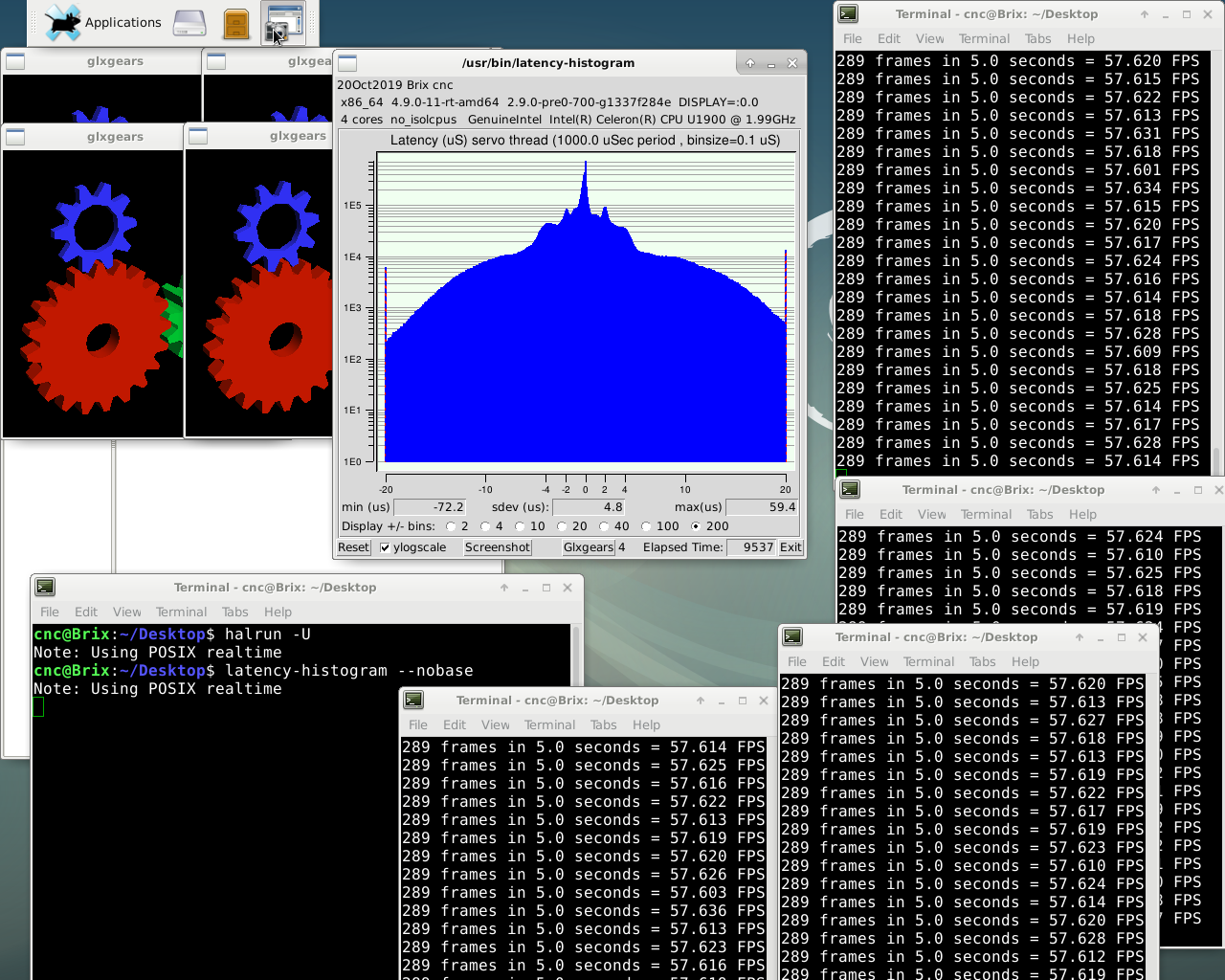

I finally achieved to get linux mint with linuxcnc working. I wanted this to test it out on my Brix 1900 box with mint .
Linux cnc-GB-BXBT-1900 4.16.12-rt5-kona-rt #1 SMP PREEMPT RT Fri Jun 8 10:39:47 JST 2018 x86_64 x86_64 x86_64 GNU/Linux
The result were no different than this one :
Linux Brix 4.9.0-11-rt-amd64 #1 SMP PREEMPT RT Debian 4.9.189-3+deb9u1 (2019-09-20) x86_64 GNU/Linux
The problem with the Brix is that The steppers run very rough with using either of the above SSD's but when the same SSD is swapped to another PC everything is fine.
This is what I get with the latency test:-
cnc@Brix:~/Desktop$ latency-test
Note: Using POSIX realtime
Unexpected realtime delay on task 0 with period 25000
This Message will only display once per session.
Run the Latency Test and resolve before continuing.
And Histogram:-
What would cause the realtime delay and is the histogram OK?

- Posts: 18087
- Thank you received: 5321
20 Oct 2019 16:40 #148417
Replied by PCW on topic LinuxCNC on Linux Mint 19.2

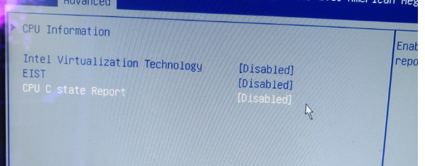

Are you sure you have CPU speed switching and any C states higher than C1
turned off in the Brix's BIOS setup?

21 Oct 2019 08:13 #148449
by Clive S
I have turned off everything I can find
I have all tested it on another mill with a Mesa 7i96 in it. Using the same SSD The motors run fine when inserted in another PC but they run rough when the same SSD is put into the Brix PC
Replied by Clive S on topic LinuxCNC on Linux Mint 19.2
Thanks Peter.Are you sure you have CPU speed switching and any C states higher than C1
