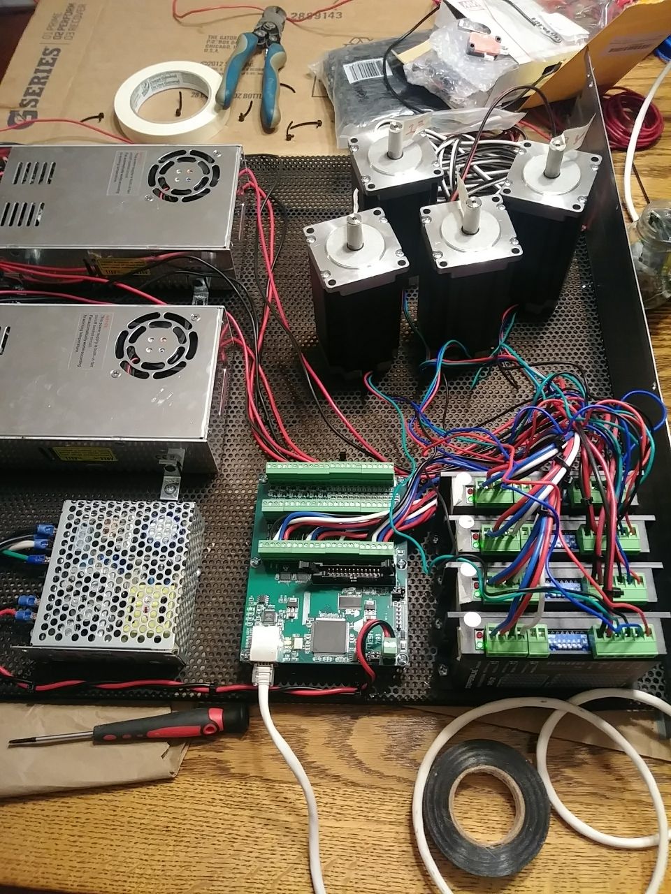

I am so frustrated. I was using Mint 19.2 and could not load the 7i96 config tool, used pncconf and could get LinuxCNC to open but not allow me to turn a motor. I then scrapped the whole thing and loaded up Debian Stretch with LinuxCNC 2.7. Went through the process to upgrade and I am now running 2.9 and I got the 7i96 tool to work and produce files. I can open LinuxCNC but it will still not allow me to turn a motor. I do not believe that I am making this too complicated, on the contrary I think I am building it very lean just to get the thing to turn a motor.
The users and moderators here are super helpful and I greatly appreciate all of the advice that I have received and read in other posts. Let me lay out what I have and see if I can get this narrowed down.
uname -a gives me this: Linux linuxcnc 4.9.0-12-rt-amd64 #1 SMP PREEMPT RT Debian 4.9.210-1 (2020-01-20) x86_64 GNU/Linux
I am trying to configure a 3 axis, 4 motor (gantry) cnc router. I have lead screws that are 2 turns per inch, I am using DM542T drivers with 8 microsteps, I have the 7i96 controller, ip is 192.168.1.121. I have NEMA 23 motors, 1.8 degree (23HS45-3504S). My computer speed is:

Min Limit is 0 (Home) and the Max Limit is 48 since I have a 48 inch by 48 inch table. How do I figure the Max Velocity and Max Acceleration? I would assume it has to do with the specific motors and drivers but I have not found that information yet. Same thing with Home Offset, Search Velocity, Latch and Latch Velocity. I will keep reading but if anyone can throw me a bone I would appreciate it.
I have attached my basic hal and ini files that I created in the 7i96 config tool.

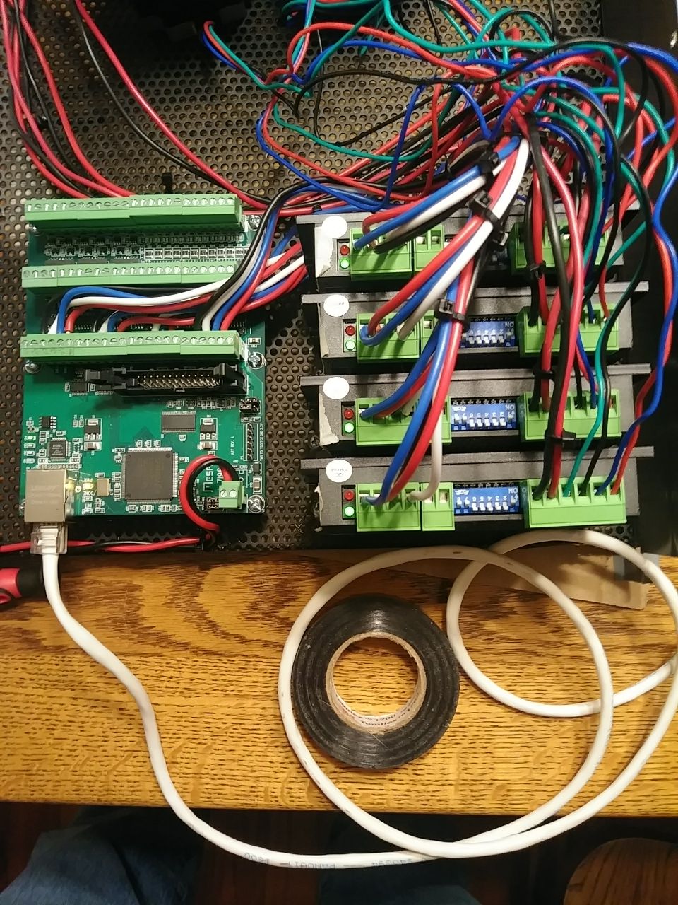

How have the stepper drivers been wired to the 7i96 and how are the steppers wired to the stepper driver. It is helpful if you can do a "mud map" of how you have actually wired it, rather than just comment "as per instructions". We all make mistakes, that seems the best way I learn.
Have you correctly identified the wires of each stepper motor correctly ?
How have you set the DIP switches on the driver, has the current been set correctly to match the motors ? According to the data sheet for the motor it is a 3.5amp model.
On Page 9 Item 10 of the DM542T what is the status of the LED mentioned ?

Here is what I have: (all drivers and motors are wired/ colored the same way. I have them all on TB1 Step 0-3)
Motor Driver
A-(BLK) A-
A+(GRN) A+
B-(RED) B-
B+(BLU) B+
Driver 7i96
PUL+ Step+ (TB1 pin3)
PUL- Step- (TB1 pin2)
DIR+ DIR+ (TB1 pin4)
DIR- DIR- (TB1 pin3)
The Drivers are set to 3.76A peak, 2.69 RMS. Dip switch 1 is down (ON) with 2 and 3 up (OFF). Switches 4, 5 and 6 are up (OFF) with 7 and 8 down (ON) for 8 microsteps.
The LED on the Driver is a solid green. The red LED is not on at all.
I have 2 - 36V power supplies. Each one powers 2 drivers/ motors. I have a separate 5V power supply to power the 7i96.
