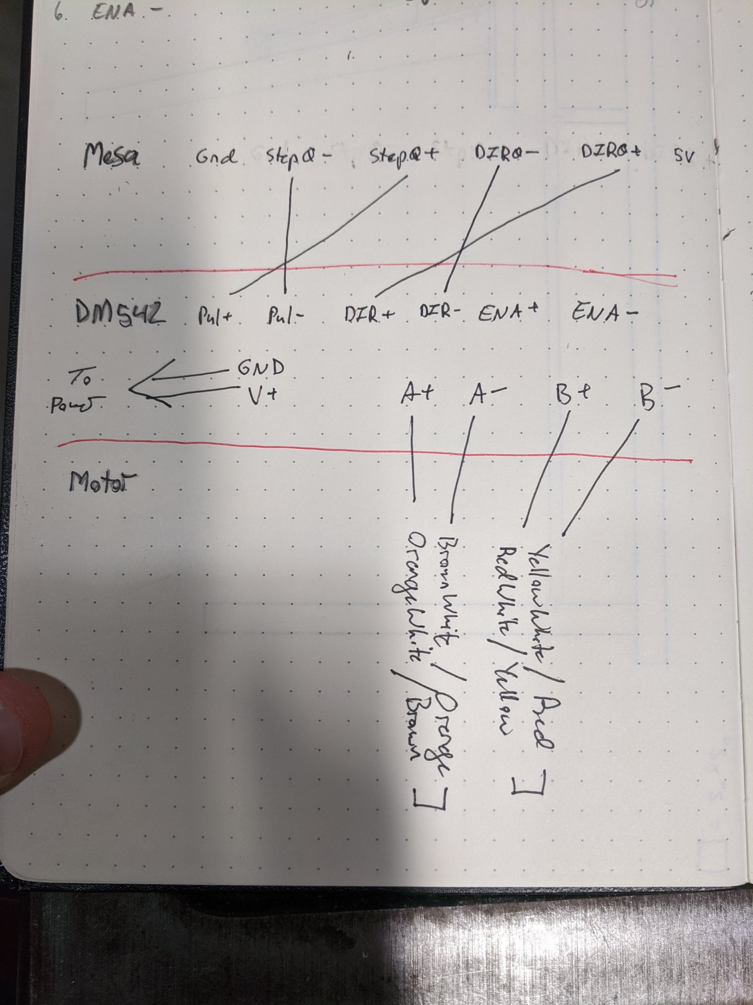

Hmmmmm
TB1 Pin3 is Step0+
TB1 Pin2 is Step0-
TB1 Pin4 is DIR0-
Wiring should be
TB1 Pin2 Step0- =========> PUL-
TB1 Pin3 Step0+ =========> PUL+
TB1 Pin4 Dir01- =========> DIR-
TB1 Pin5 Dir0+ =========> DIR+
TB1 Pin3 is Step0+
TB1 Pin2 is Step0-
TB1 Pin4 is DIR0-
Wiring should be

Are your motors enabled, means when you expect them to turn are the blocked or can you turn them freely.

If you try to run and they are still turnable, your config is not giving enable signals. Or you wired/configured the drive enable incorrect. Looking on your image i would guess that the unconnected 2pin plug is in relation of some enabling..
Mike

Like most of the stepper drivers of that class the drivers are enabled by leaving the enable disconnected, disabling the drives is done by an active signal and enabled by an inactive signal. Kind of counter intuitive.

I’m wondering if it would be worth disconnecting the drivers from the Mesa card and hooking up a 555 running at 5v just to test the drivers themselves.
It would be highly unlucky for all 4 to be FUBAR but at least it would rule that issue out. Also a continuity check on the stepper motors wouldn’t hurt.

The recent comments on this thread has prompted me to rethink my wiring and setup and I've found a few issues which get my machine up and running. You can view the first movement of the X-axis here:
There were a couple issues I had to contend with. First, I had followed an incorrect wiring diagram for the Mesa 7i96 card which likely led to my second issue which was the break out board I was using for a serial interface between the microstepper and the motor had been fried in some initial testing. Couldn't get anything to move with that one after that happened.
I rewired everything and replaced the fried serial interface and successfully got things moving again. I also decided to document the wiring, just in case I had a lapse in judgement and disconnected anything. You can see that here:
Just want to reiterate how much I appreciate how helpful everyone on this forum seems to be!
