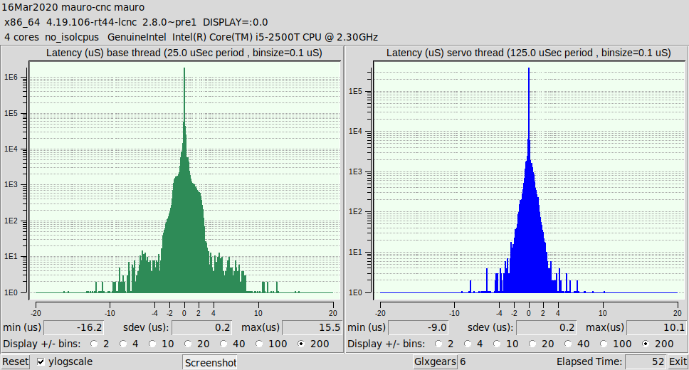

since the installation is easy I did a test with the cnc router. 5i23 + 7i40 closed loop 8khz and that is also very good.
I attach the latency histogram screen (the tests were done with 6 glxgear and other open applications, I didn't immediately take the screenshot but it was a few more nS)
regards
Mauro
regards
Mauro

They are pretty good figures
can’t complain about that
