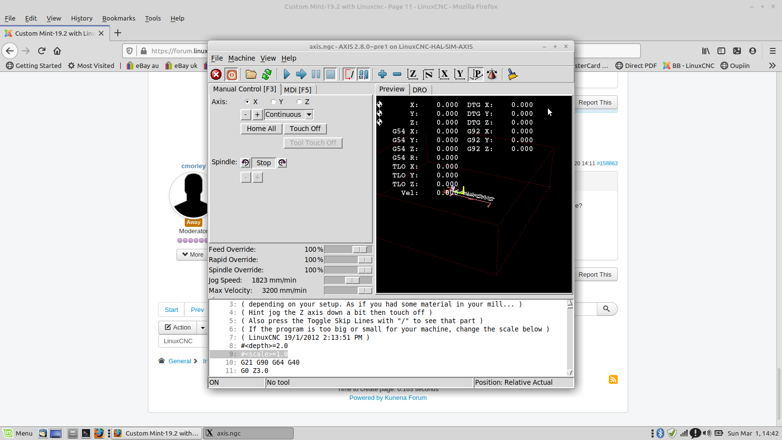

29 Feb 2020 21:11 #158863
Replied by cmorley on topic Custom Mint-19.2 with Linuxcnc
Anyone notice that the back plot on Mint 19 doesn't show the extends of the machinable area or is this just my machine?
It is usually made of dashed lines.
Chris
Chris
