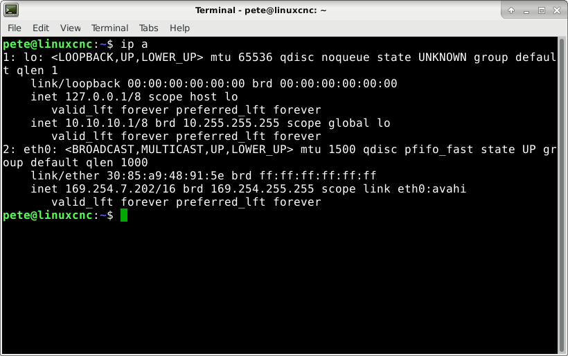

by P.J.B.C
Replied by P.J.B.C on topic having trouble flashing my mesa 7i92...
I've setup the network address via the gui, and going back there the gateway is blank and won't hold a set address..
any clues...?
In any case I've inserted the lines of code that the manual describes(into the interface file). However it comes back with Network is unreachable (-101).
do you need to remove any of the other text..
any clues...?

28 Apr 2020 02:03 - 28 Apr 2020 02:03 #165913
by bbsr_5a
Replied by bbsr_5a on topic having trouble configuring my mesa 7i92...jethornton's configuration tool..
YOU cand use the same IP as the CARD
if the card has 10.10.10.10 the pc needs to have 10.10.10.1
BUT at all please use the 192.168.1.1 for the pc and jumper the card to use board_ip=192.168.1.121

28 Apr 2020 03:55 #165930
Replied by tommylight on topic having trouble configuring my mesa 7i92...jethornton's configuration tool..
As bbsr_5a said, you can not have the same address on the PC and the Mesa card, change the PC address to 11 the last digits.

28 Apr 2020 09:33 - 28 Apr 2020 10:18 #165982
Replied by PCW on topic having trouble flashing my mesa 7i92...
Is "eth1" your Ethernet device name?

- P.J.B.C
- Posts: 53
29 Apr 2020 05:06 #166065
by P.J.B.C
I tryed address 10.10.10.1 and 10.10.10.11 no avail..
where should i look for the ethernet device name, it is what i used... in the interfaces file...
- Posts: 22030
- Thank you received: 7504
29 Apr 2020 05:15 #166070
Replied by tommylight on topic having trouble flashing my mesa 7i92...
ip a
in a terminal
in a terminal
- P.J.B.C
- Posts: 53
29 Apr 2020 05:38 #166079
by P.J.B.C
opening IP A, i get a bunch of mac address stuff and i can see a reference to eth0(1 is mentioned as lo,and 2 is labeled as eth0) but in replacing the eth1 with eth0 in the interfaces file i still get an error.
- Posts: 22030
29 Apr 2020 06:15 #166083
Screenshot ???
