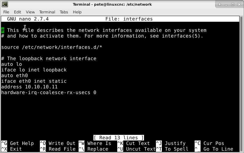

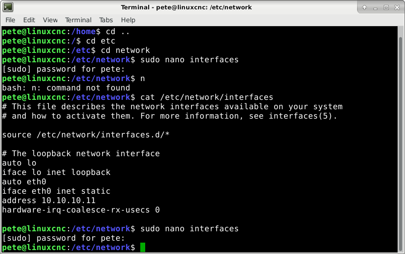

Right so you have not setup a static IP address on the host
What does
cat /etc/network/interfaces
print?
What does
print?

30 Apr 2020 06:15 #166203
by P.J.B.C
Replied by P.J.B.C on topic having trouble flashing my mesa 7i92...
- Posts: 18118
- Thank you received: 5336
30 Apr 2020 08:13 #166213
Replied by PCW on topic having trouble flashing my mesa 7i92...
Did you re-boot after editing the file?
if "ip a" doesn't show a 10.10.10.11 ip address
that file has not been processed.
Also the GUI network manager should show
eth0 as "unmanaged" since the GUI is not allowed
to touch eth0 if its in the interfaces file
You might also try commenting out the
source /etc/network/interfaces.d/*
line, in case there some error in scripts there

30 Apr 2020 18:53 #166263
by P.J.B.C
Oh, Great, Thank work out swell......
I had commented out the line when i got one last message ('hm2_7i92.watchdog.timeout_ns' not found)
I went back to the ini.file and added back the 'dot zero' (after the board number)That i had removed in trial...
It now loads up fine...
