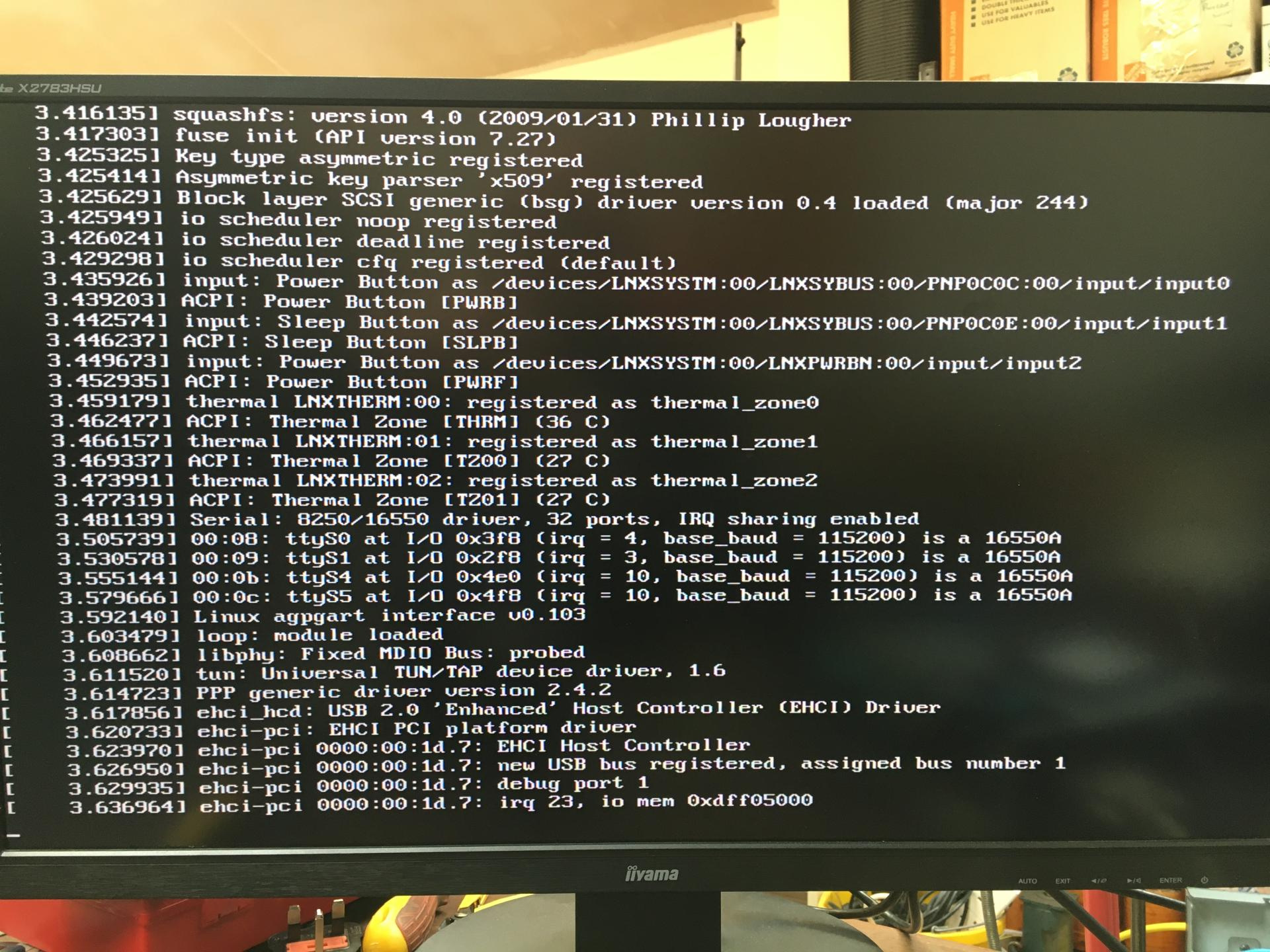

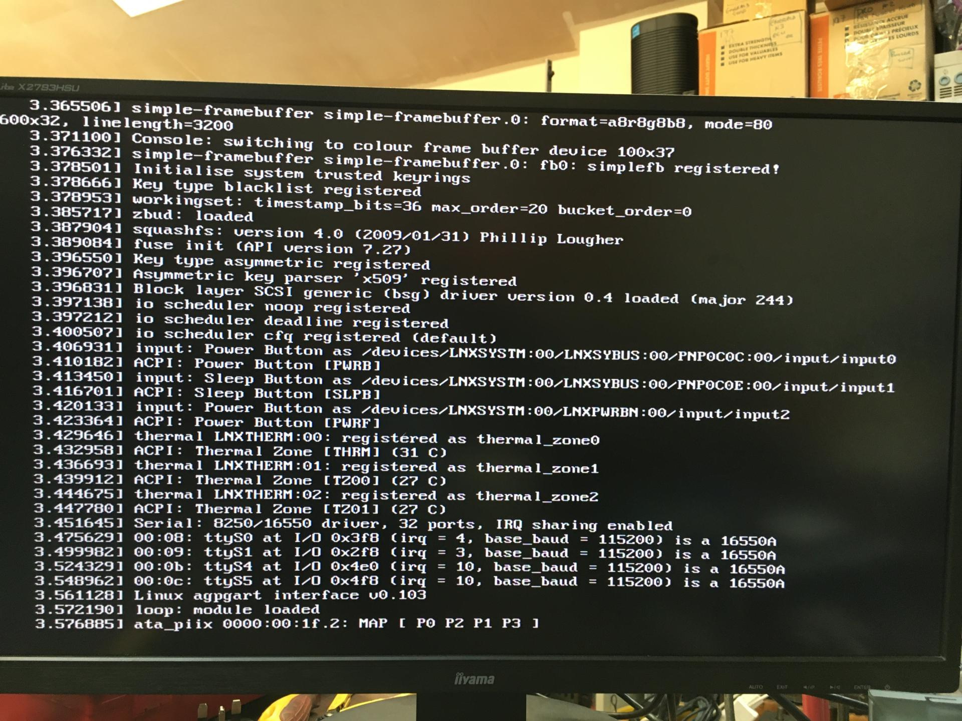

Sorry, missed that bit. That's a new option for me. I edited out the quiet bit and it generated a couple of screenfuls before it got stuck again. It sits there for as long as you like, even overnight. Nothing from mouse or keyboard will move it on. The only option is to do a hard reset or power cycle.
Here's what I get each time:
Changed BIOS from IDE to AHCI
And back again to IDE, same outcome.
Ooof.
Ooof.

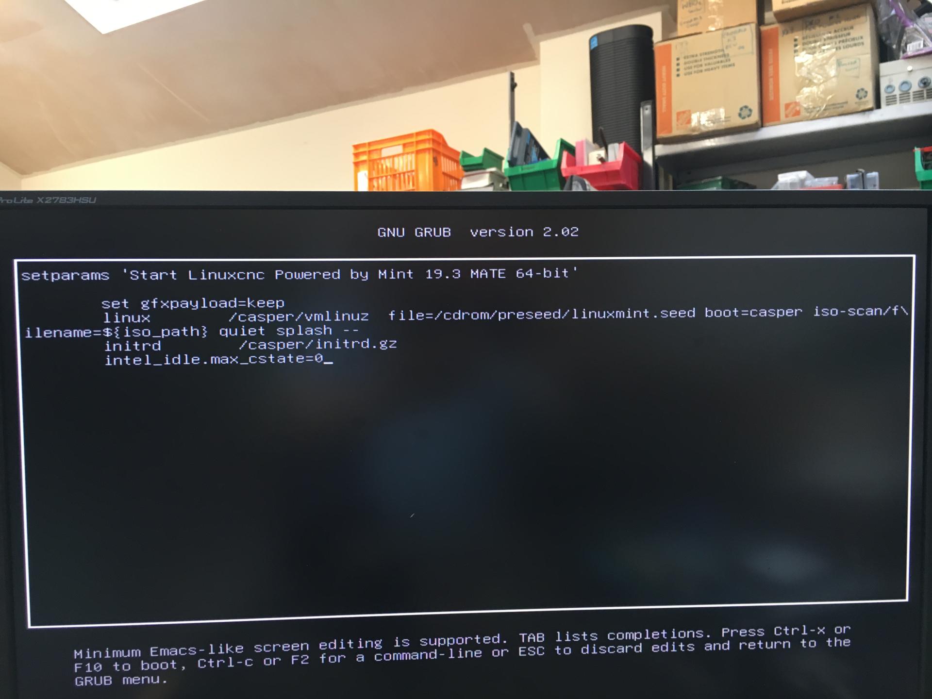

Ok if you can try this:
After you remove the option as before can you add this option
intel_idle.max_cstate=0Please Log in or Create an account to join the conversation.

I made these changes - hoping this is what you meant. No change.
Note that it boots into the original Debian install and also almost booted off an SSD with W10 on it. Suggests it might be something to do with trying to boot from USB. I don't have a DVD drive in this machine but perhaps I should see if there's a SATA DVD drive somewhere. I'm guessing a USB DVD drive wouldn't be a great idea.

I meant replace the string “quiet” with the one I suggested, it has to be where quiet was. Ie before the “—“ part.
It’s not a boot media issue, it’s an issue with the processor. The processor is fine with the Wheezy kernel but not so with later kernels.

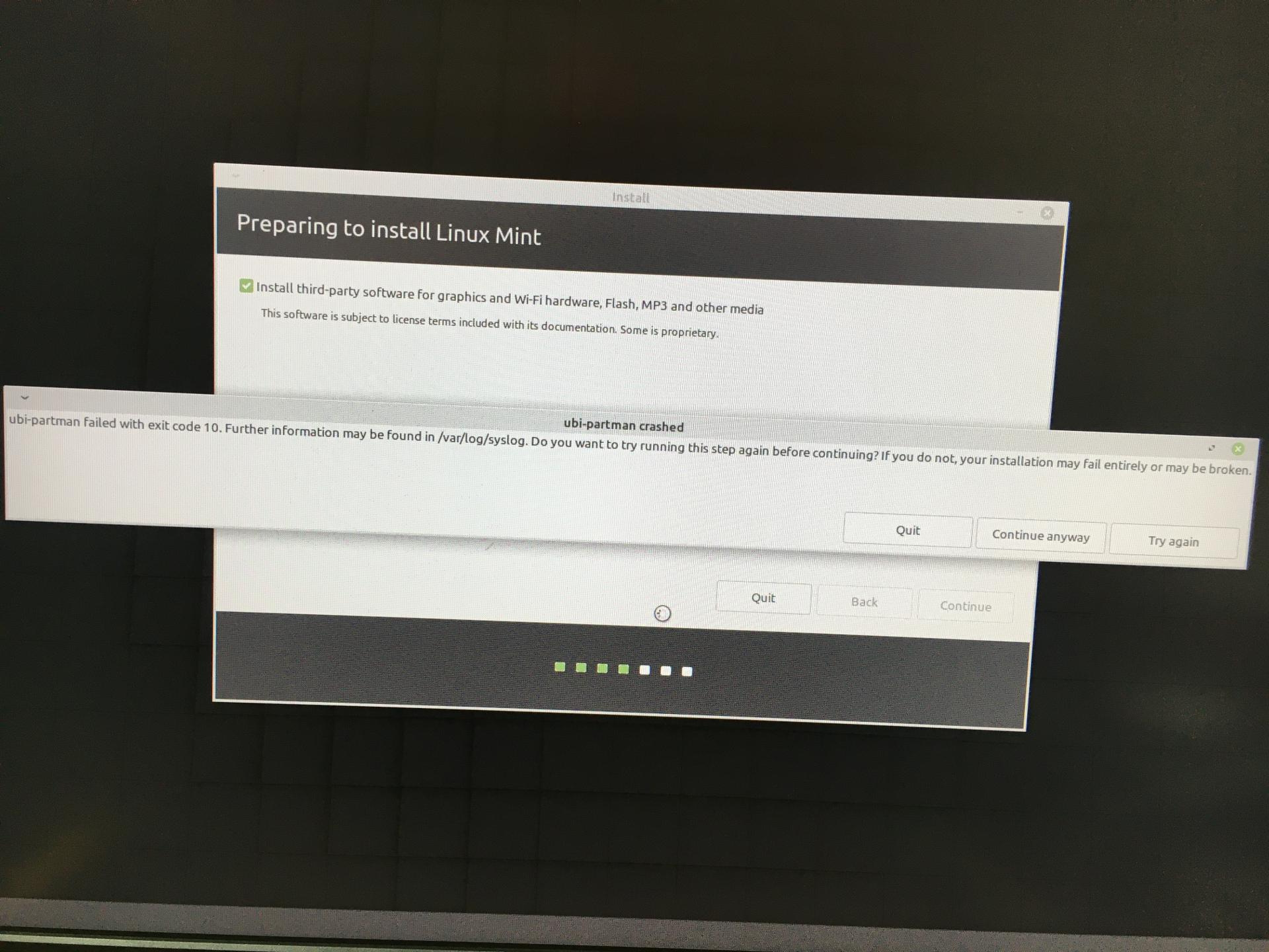

That appears to have fixed the issue to some extent. It came up with the live installation and is attempting to install itself on the SSD. However, it's just failed, complaining about ubi-partman code 10. That sounds like a partition issue?
I have another SSD that I can try with. Got family and work stuff to do this afternoon, so this will have to wait until the evening.

Before installing run the latency tests, just to make sure your chosen board is up to the task.
As for the installation issue you will need to add nodmraid as well as the option previously mentioned.
Once your install is complete you will need to go through the same procedure again but just using the adding the first option.
If the boot into the new installation works we’ll walk thru how to make that change permanent.
