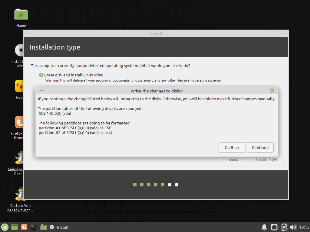

Make a note of the of the partitions mentioned after "The following partitions are going to be formatted"

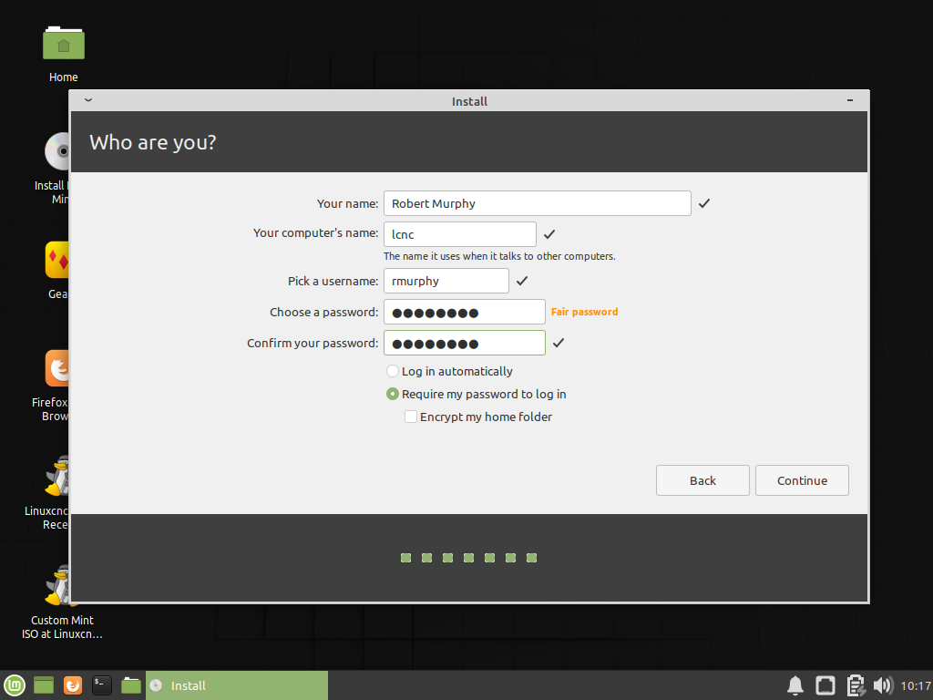

Make sure that "Require my password to login" is checked and "Encrypt my home folder" is unchecked

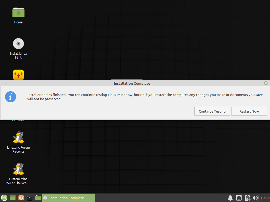

Select "Continue Testing". This will bring you back to the Desktop DO NOT REBOOT YET

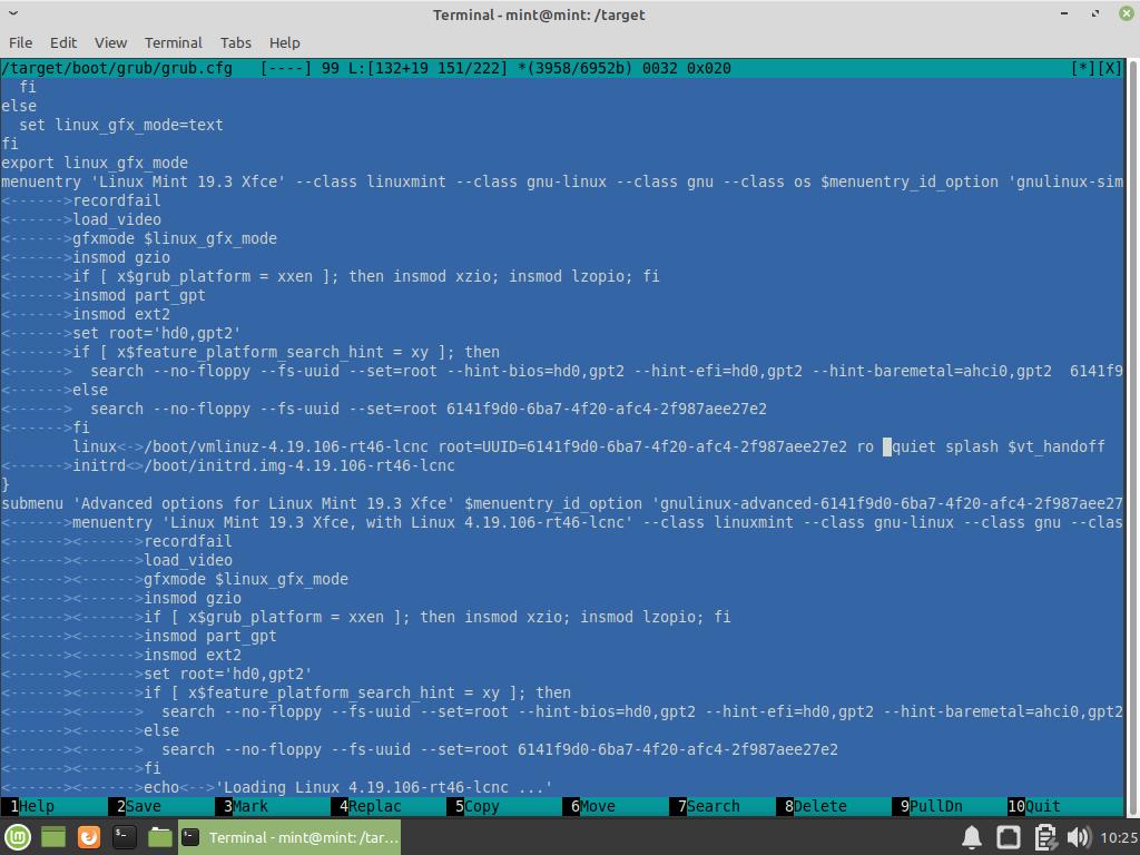

Next we need to edit a file in the termnial as temporary measure to be able to boot:
cd /target
sudo mcedit boot/grub/grub.cfg
Look for the line shown in the picture below, where the cursor (white block) is add the intel bit that you have added before. When you are at the right spot the top of the screen where the numbers are will match.
Press F2 & save.
Press F9 then select quit.
Do not run update-grub

05 Nov 2020 17:34 #188463 by BeagleBrainz
Replied by BeagleBrainz on topic Linuxcnc Mint 19.3 ISO
Basically the Linux Mint installer creates a partition for installation and mounts the partition at /target. This is the partition on the SSD that you boot to. After the installer has finished this partition is left mounted and accessible, ie any changes you make to files & directories below /target are kept. Due to various reasons, mostly to make things simple, running update-grub wont work. If actual fact you have edited the file update-grub edits. The other file, /etc/default/grub, is read by update-grub and the options in that file are used by update-grub to write /boot/grub/grub.cfg.
Simply /etc/defult/grub contains options & /boot/grub/grub.cfg is used by grub ( the boot loader ) when the system boots.
Directly editing /boot/grub/grub.cfg and making a mistake can cause your system to become unbootable. Any errors in /etc/default/grub are hopefully picked up by update-grub and no changes made to the file grub reads when it boots. That is the theory, tho mistakes can still get through.

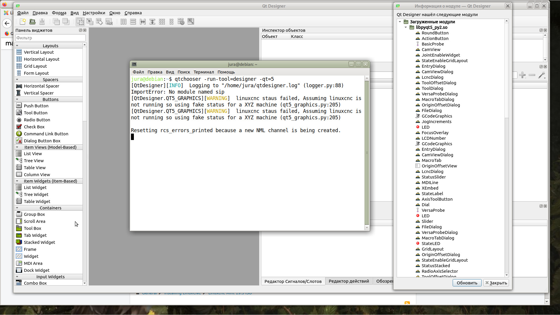

26 Nov 2020 13:04 #190352 by hottabich
Replied by hottabich on topic Linuxcnc Mint 19.3 ISO
@hottabich
I think Beagle was referring to this edit in the first post:
therefore I am not hosting the Mint ISO any longer, as I can't supply the support required nor updates either to the image nor packages.
So maybe try the official Buster ISO
I have the official Buster ISO installed. Desinger works but fails. Thought to try Mint. Not out of love for reading and not from ignorance of English did not finish reading. I'm sorry.
26 Nov 2020 22:58 #190396 by Aciera
Replied by Aciera on topic Linuxcnc Mint 19.3 ISO
Wasn't directed at you specifically. Most of us users tend to work like that.
What do you mean by that? I just installed qt creater on the official buster ISO and had trouble to get the LinuxCNC widgets running. Seems to work fine now.
